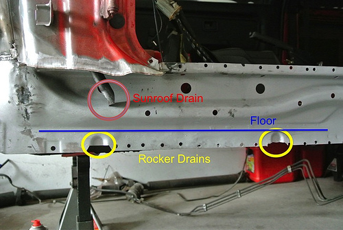

Just about every sunroof, irregardless of the vehicle maker, uses drains like these. In newer vehicles that are littered with wires, they can overflow into critical electrical connectors, apparently. Older vehicles, you're feet just get wet or your floorpans, cowl or rockers will rust (see my spare parts-car in my driveway)
Here's the drain in an E30 (not mine).
