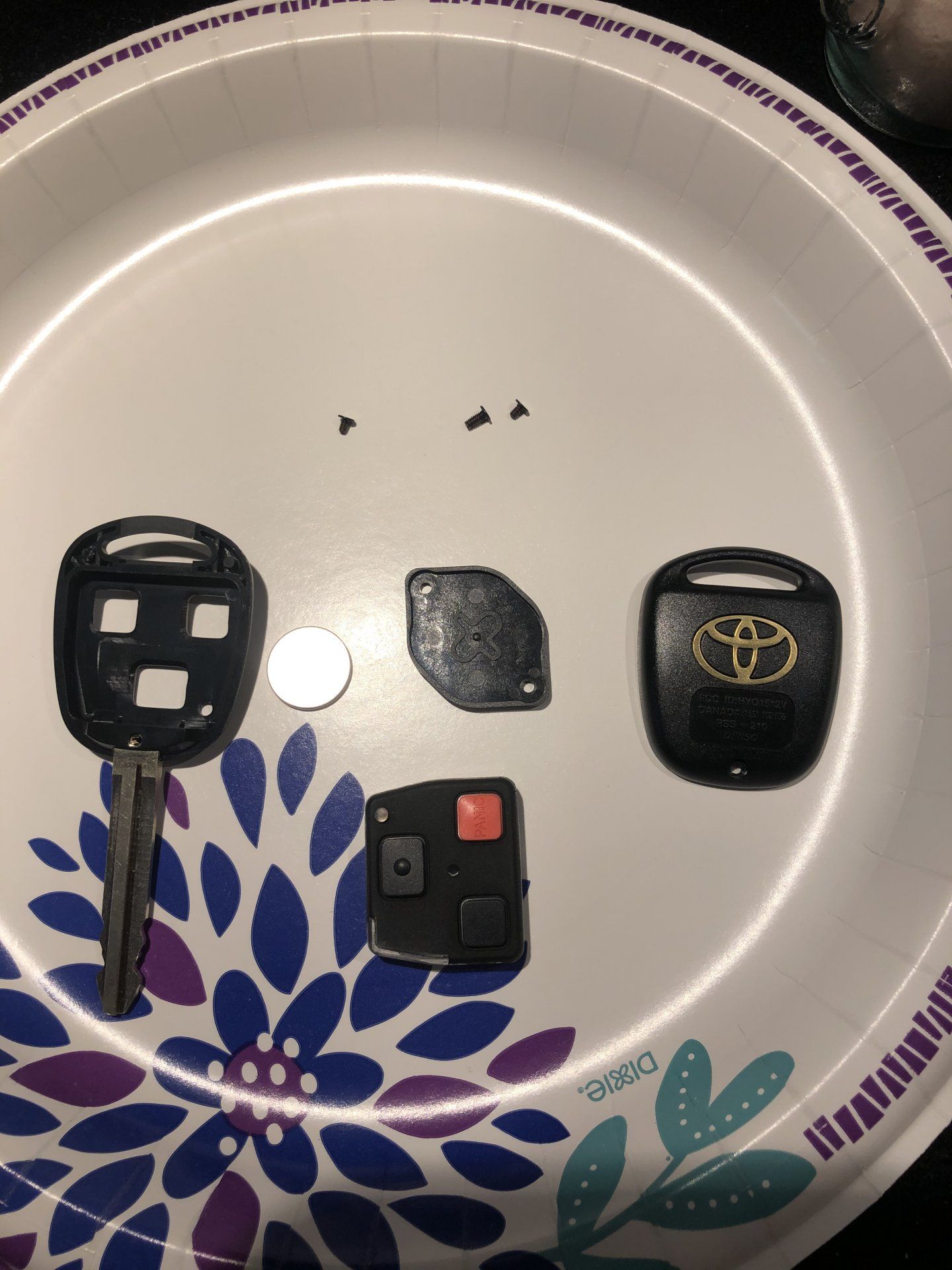

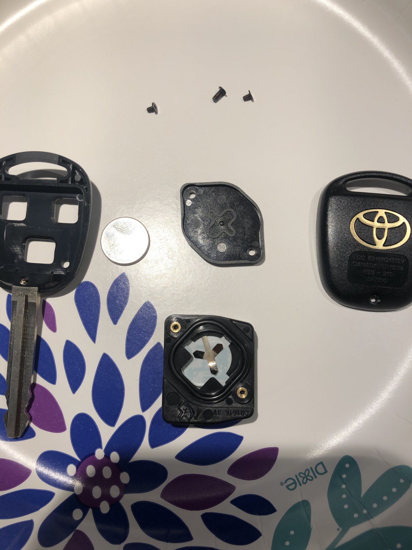

Gave it a shot with the two turns of the key and the only difference I get is that the locks cycle twice when going into programming mode, but still won’t acknowledge the key buttons being pressed once in programming mode. I’ve followed your video as well as another that in this forum with no luck. The ECU for the keyless entry in located under the steering column on the left side almost above the fuse box correct? Orangish brown box with FCC ID numbers with 3-4 white wiring connections. I’m looking through parts diagrams and am also seeing a part PN:8974160061 that looks like it may also be integral to this system. Or is that the immobilizer? I’m sorry for the overload of questions, but in my years of turning wrenches and mechanic work I’ve never had a key fob kick my butt like this one is.
Yea I have the same problem. I think its due to me having the wrong frequency. I can program the orig. master & valet no problem but when I try to program the ones I bought on Amazon they don't program.

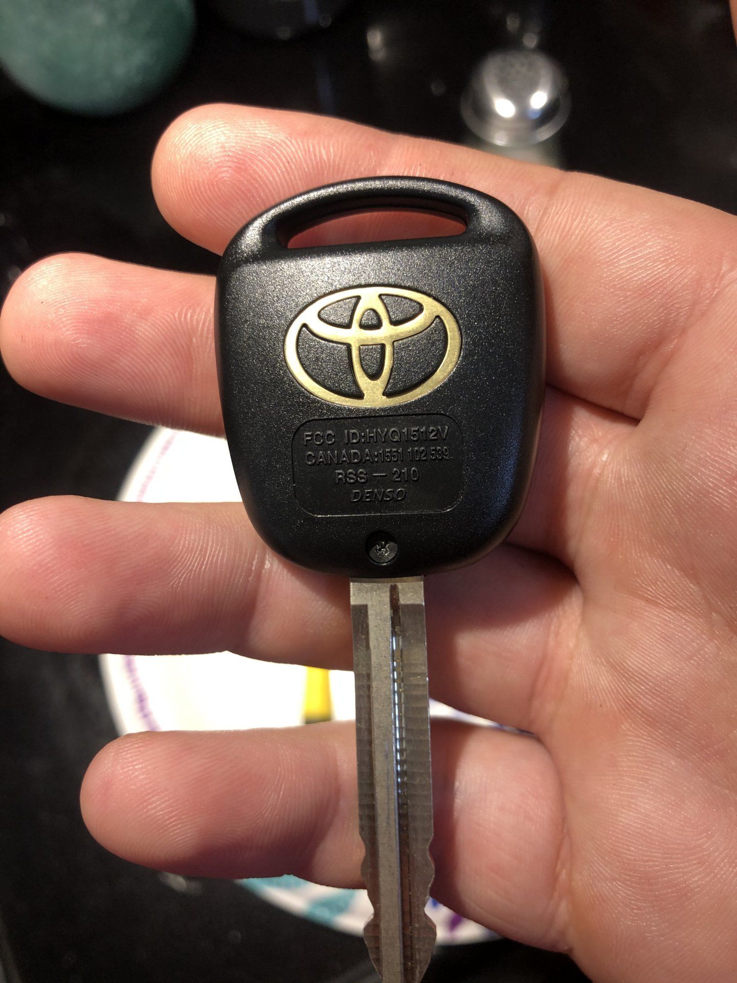

I made sure to get the key per VIN and it’s also the HYQ1512V which is supposed to be for 98-02 from my understanding. I’m starting to wonder if I’m looking at the wrong antenna/receiver ECU for the key fob now that I’m looking at parts locations. It appears there is another module located to the right of the radio or above and to the left of the immobilizer in the dash panel. I’ll get the glovebox taken out tomorrow to see if somehow something was unplugged. I’m trying to keep this a simple fix without overthinking it but it’s really kicking my butt. It’s time to invest in some factory repair manuals for myself.
The transmitter housing in your paper plate pic looks like the 98-02 version, so nothing odd there (the 03+ looks noticeably different). Since the truck is acknowledging it's in program mode the door lock dance sequence is correct. It may have been asked already (pain to go read each prior post), but have you confirmed the battery is good? When buttons depressed the fob LED lights up strong?
Okay, went out in the rain and dug back under the dash. Correction, I am looking at the correct receiver beside the steering column. One plug with the FCC ID. I wondering if the receiver has gone bad or like others have said, I have the wrong frequency (goodness l hope not). I may try a cheap Amazon transponder in the next few days to see if the Toyota transponder is incorrect.
It does light up fairly well, with each button pressed.
