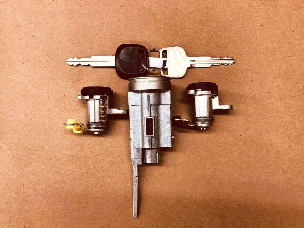

You can see in this pic that each of the cylinders we start with have their own keys and key code tags attached. If you look close, you can also see that the code on the ignition housing is ground off. I don't know if that is the case for all of them, or what. I have not seen any intact codes on any of the ignitions I've pulled myself. That does NOT mean they aren't there...
This pic is post "combining", all using the key from the ignition, which you can see still has the little code tag attached. This means that as long as you write the code in your user manual and put the tag in a safe place, you will always be able to have the dealer cut a replacement key off that code.
