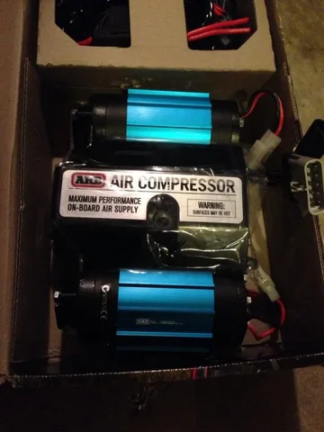

Update on the rig. I had the pleasure of replacing an icon shock under warrantee, due to a leaking seal, they took care of a full shock rebuild for free.... Great people to deal with! Also installed a dual battery optima blue top with a tmaxx dual battery controller. Re mounted the arb twin compressor where the rear spare tire was.
