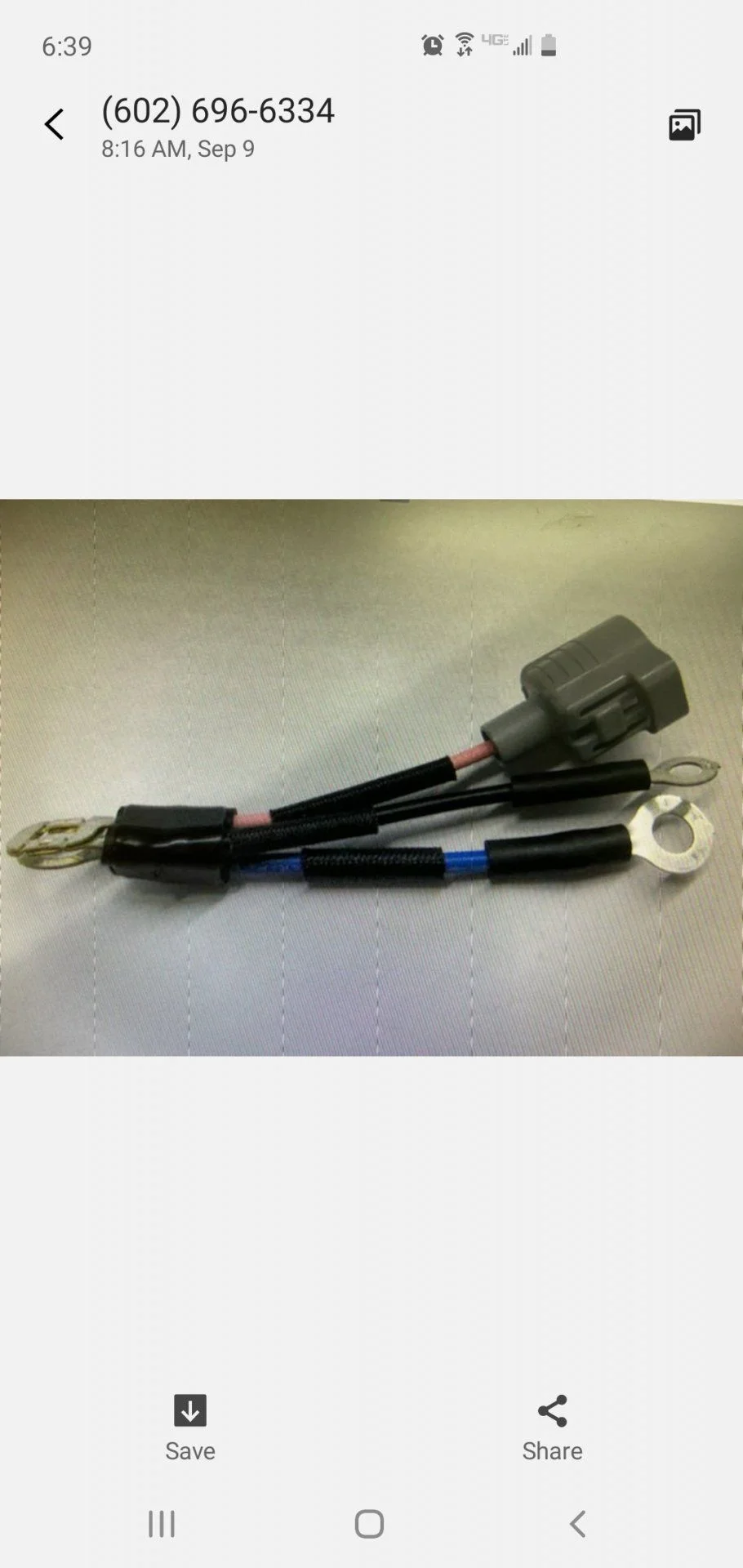

I have replace my fuseable like twice now and it keep frying it! Its almost like there's a short on the plug in. Its only that wire that shorts out! I have traced it to the fire wall and now I've hit a wall! Lol. Please any ok me else have a continuous short? Or is there a way to abandon and run a whole new one

1. Provide vehicle details.
2. Which of the 3 fusible links is popping?
It is a 1997 1fzfe the link whit the grey plug
That feeds +12 to all injectors, coil, igniter, etc.
You're looking for a short in the main engine harness most likely by the EGR pipe.
I had a similar short but it was an injector wire touching the fuel rail. Oddly enough there were 3 spots of bare wire in a 3 inch section. It popped two fusible links before I found it.
