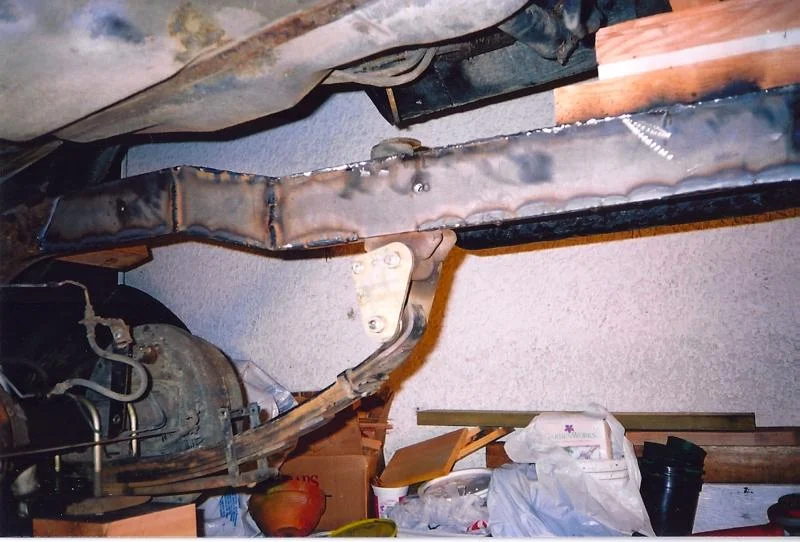

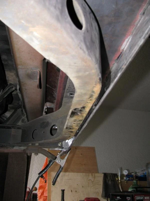

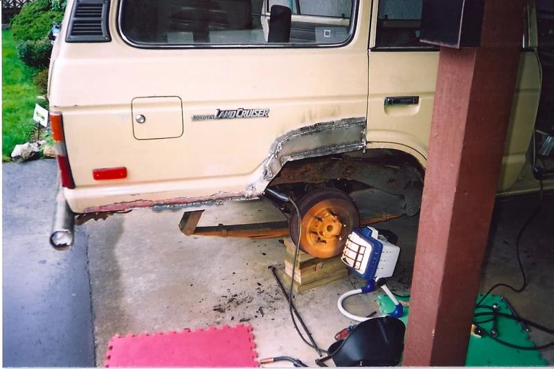

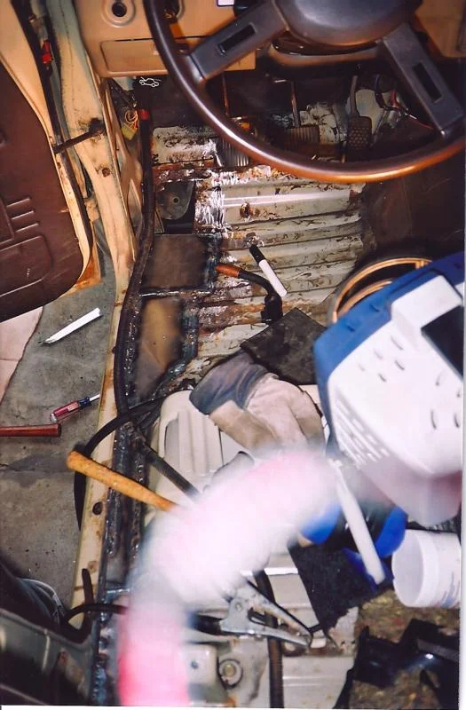

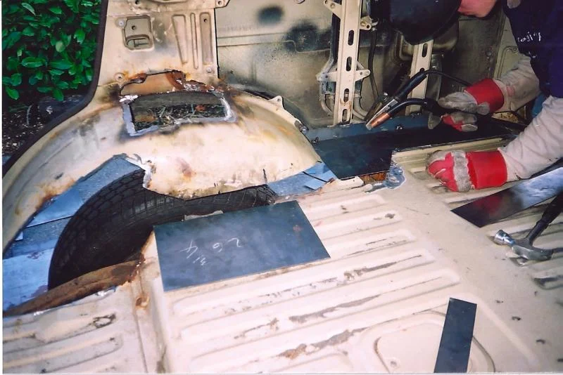

After that outing I decided to strip the rear cargo-area mat. I found some serious rust holes! My friend said you better buy a welder, it is not worth paying someone to fix that. So we bought a used 220 volt Century mig welder (still have it). I then proceeded to fix all the rust with new sheet metal, I had never done anything like this before, so it was a learn as you go affair. I ended up cutting off the rear rockers since they were so bad. Also, I cut out a lot of the rusty frame and boxed in the rear of it. Two months later I had finished.

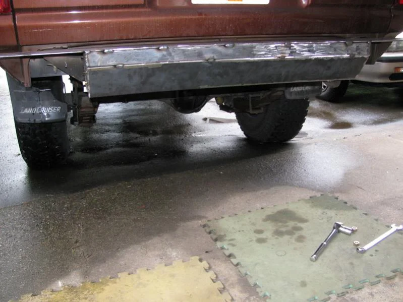

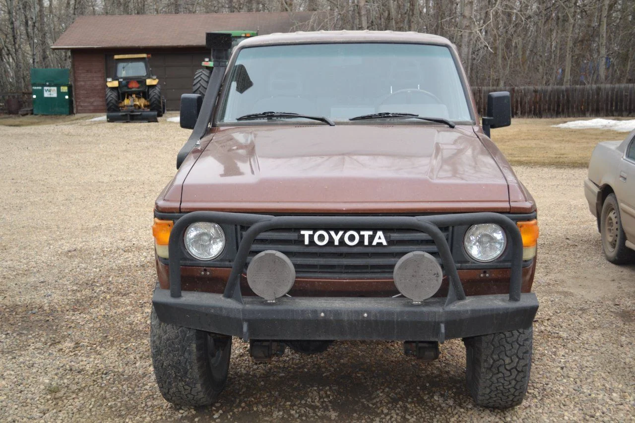

-Made a front and rear bumper out of ¼ inch steel pipe

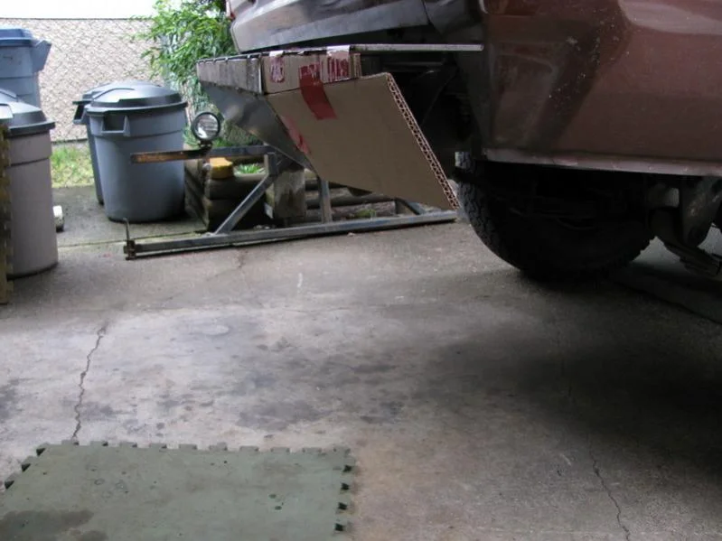

Next I have to get the A/C installed and running, build new bumpers for the front and rear, build a new swing out tire carrier, install the old cb radio, get some driving lights, tint the windows, install tractor lights on the rear tire carrier and there will be more I am sure but those are the large things.
