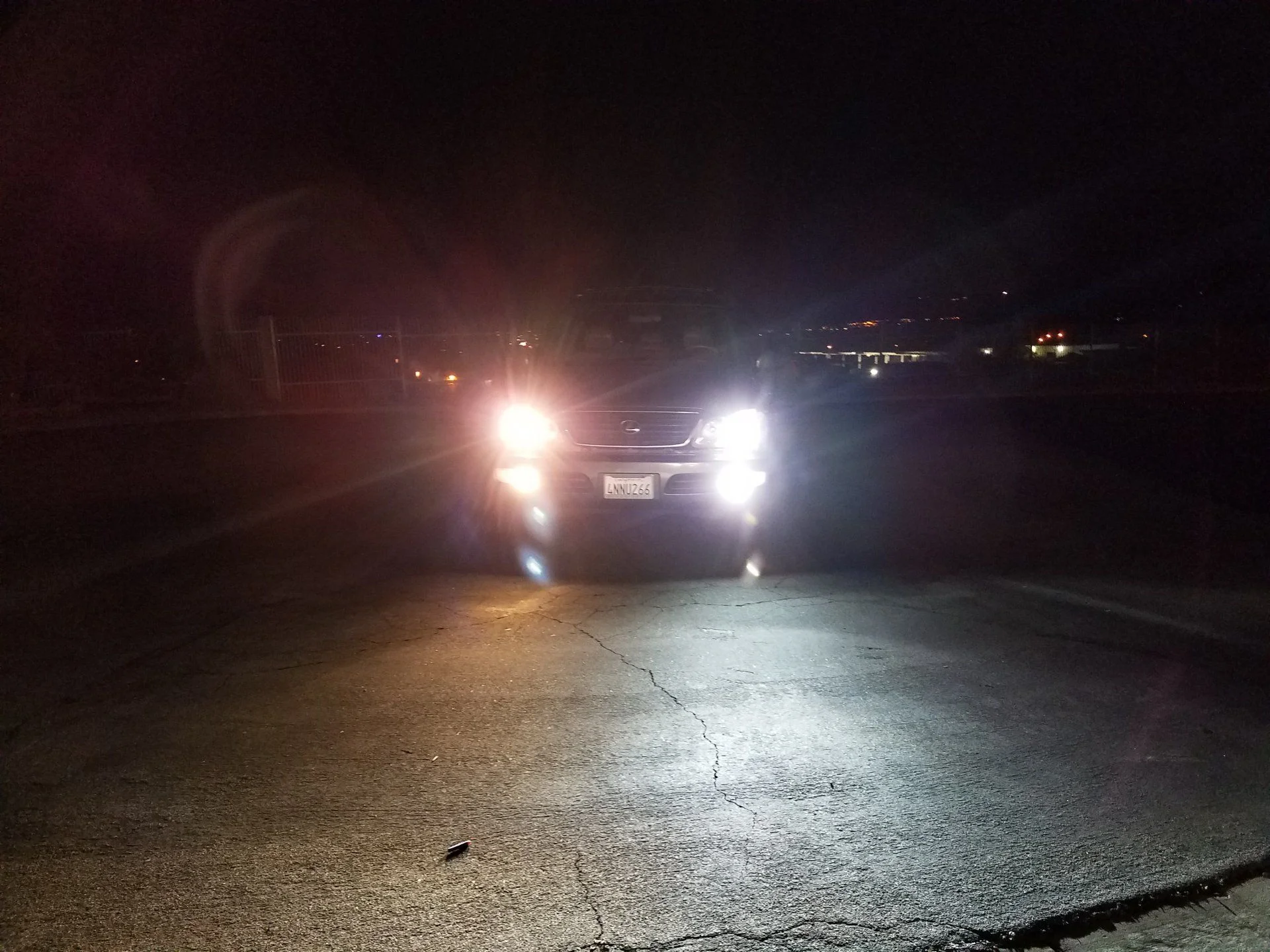

first thing i noticed was the headlights were TERRIBLE, i could barely see the road so i bought 2x 55watt HID kits for the headlights 2x HID kits 35watt for the fog lights and 2x LED for DRL and High Beams, absolutely 10x better.

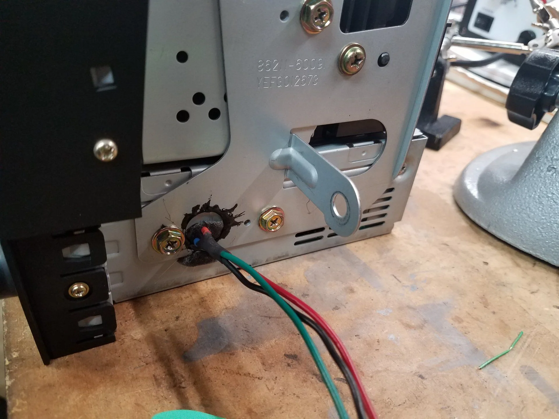

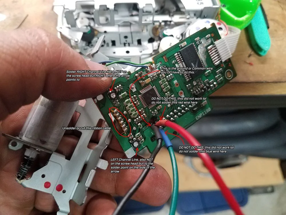

Next thing i did was i noticed no aux input, did research found it difficult to fit aftermarket stereo so bypassed the magnetic head on the tape deck, fitted a kinivo BTC450 bluetooth to that, works perfect!

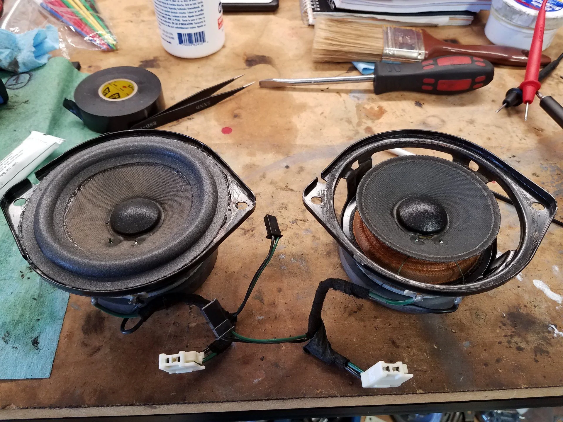

then the speakers were all shot, was goign to get new ones but the strange 8ohm setup required me to spend almost 2k in speakers so i checked the voice coils and decided to just repair surrounds.

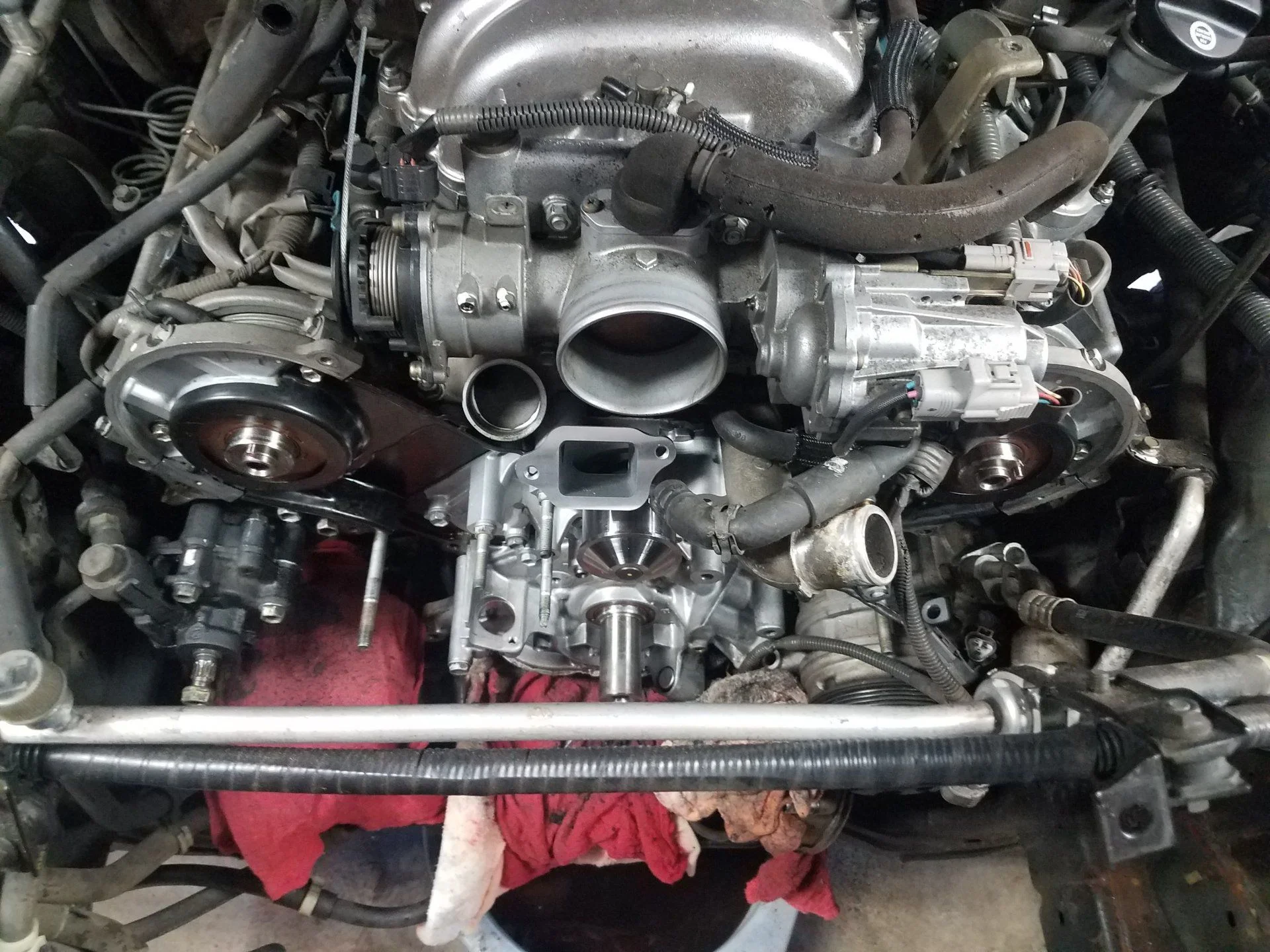

after the speakers, i knew i shoudl do the timing belt so did that along with all bearings, water pump etc.

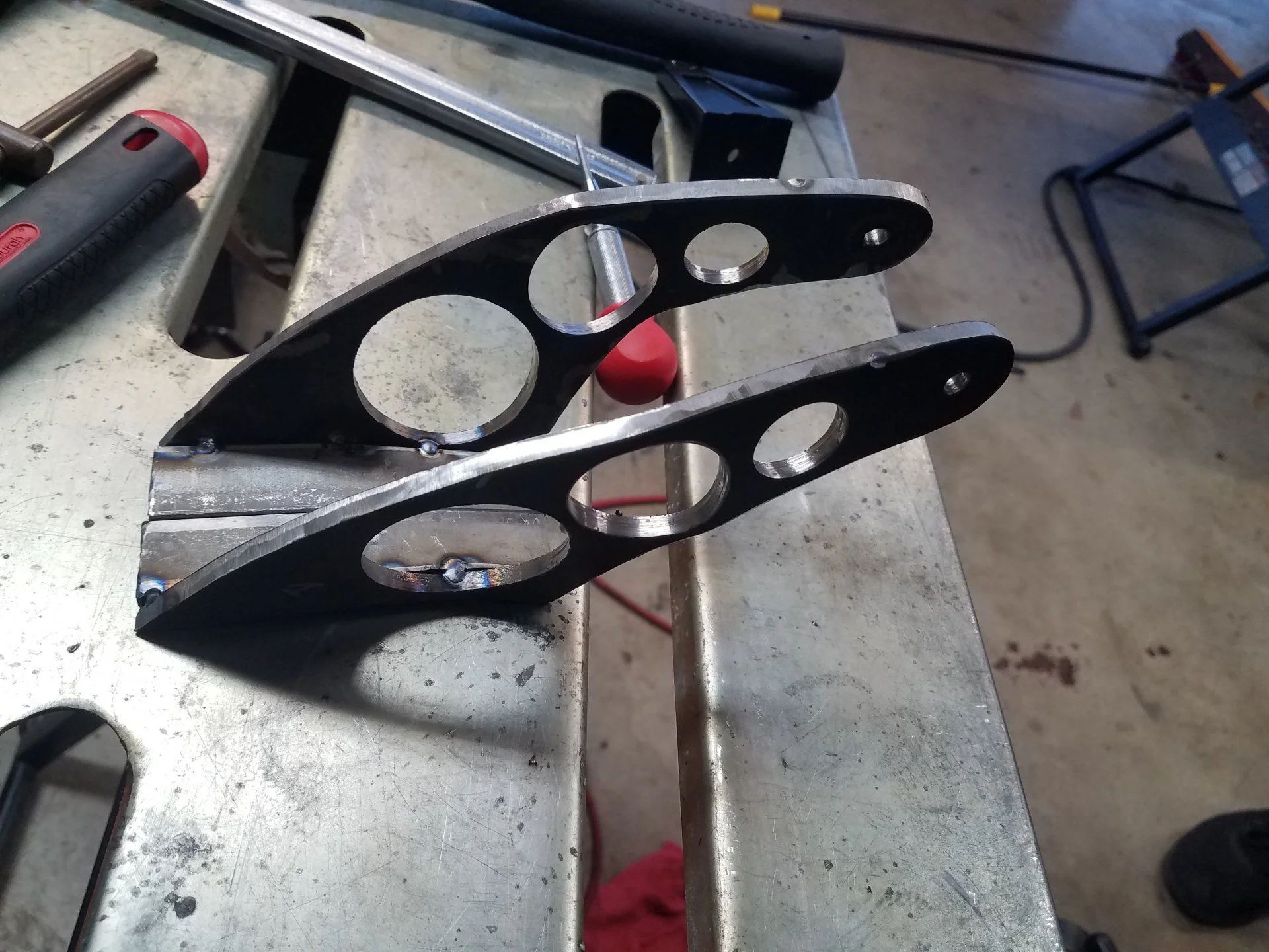

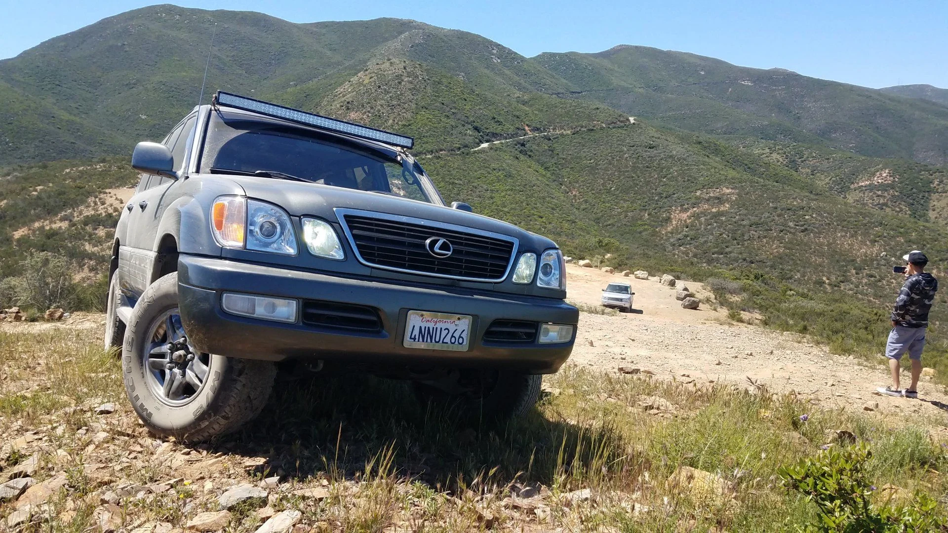

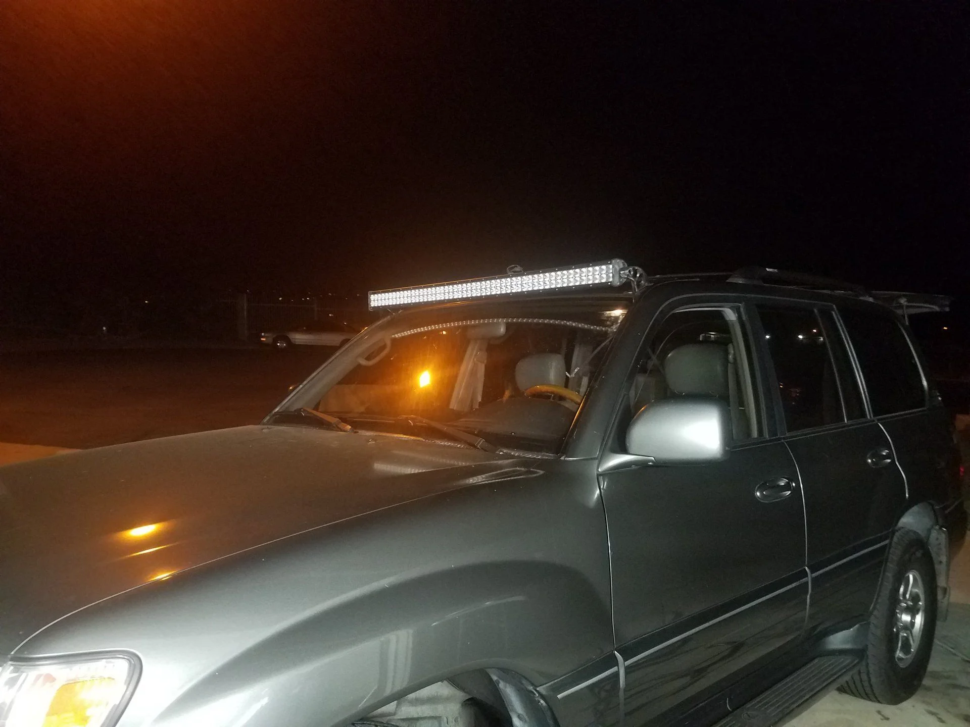

wanted a light bar so installed that, had to custom make a braket and use rivet inserts because i could not find proper brackets for this car, most people put it on the roof rack (which i have not made yet)

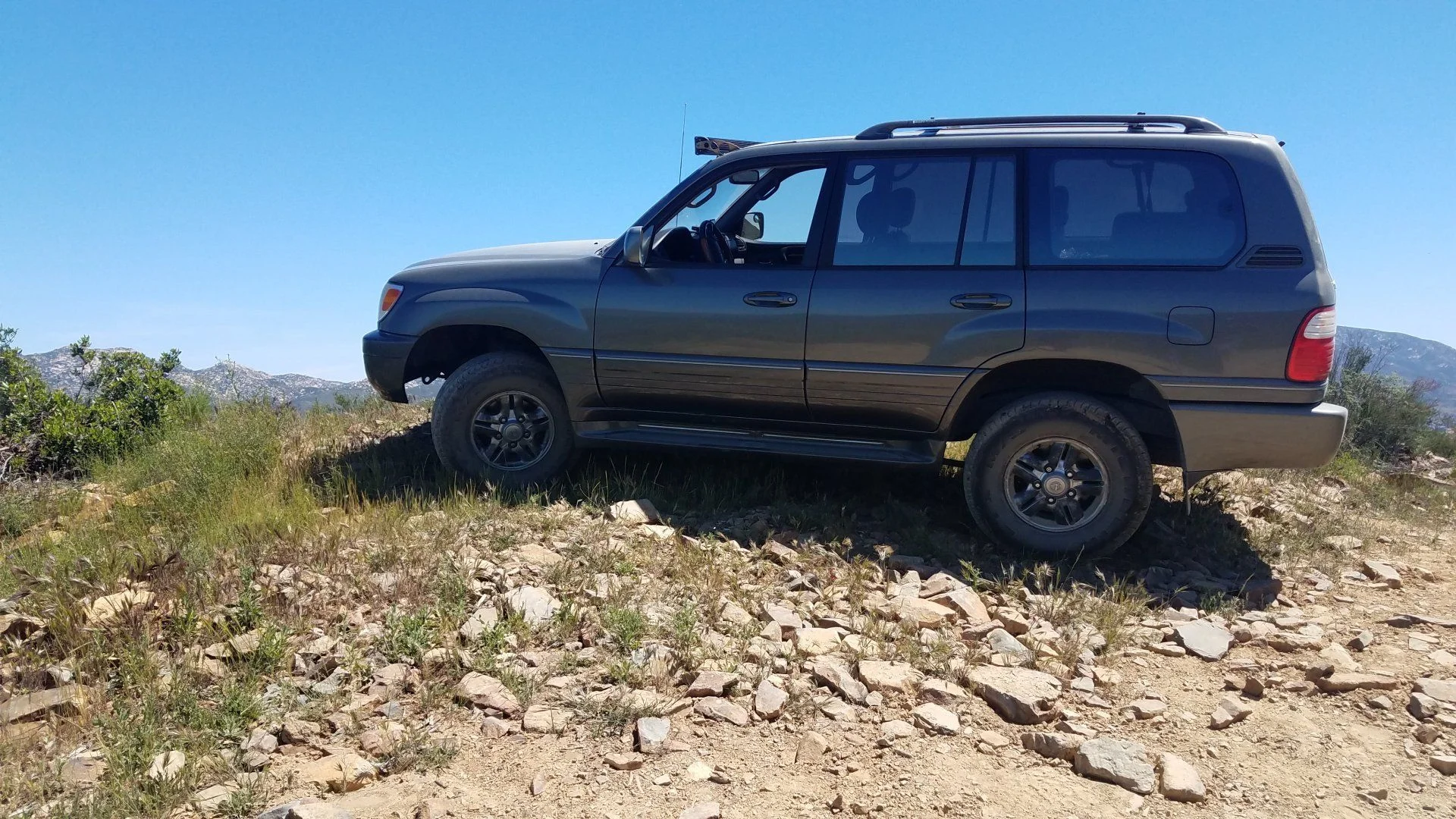

had to take it offroading

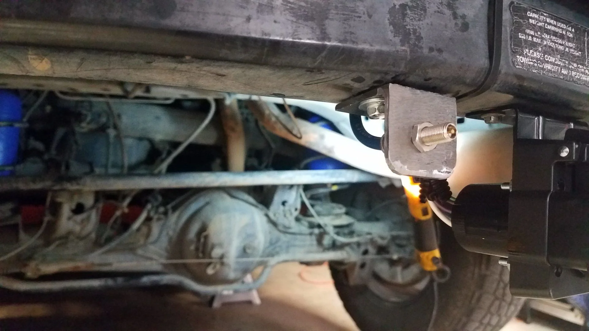

then the air bag helpers

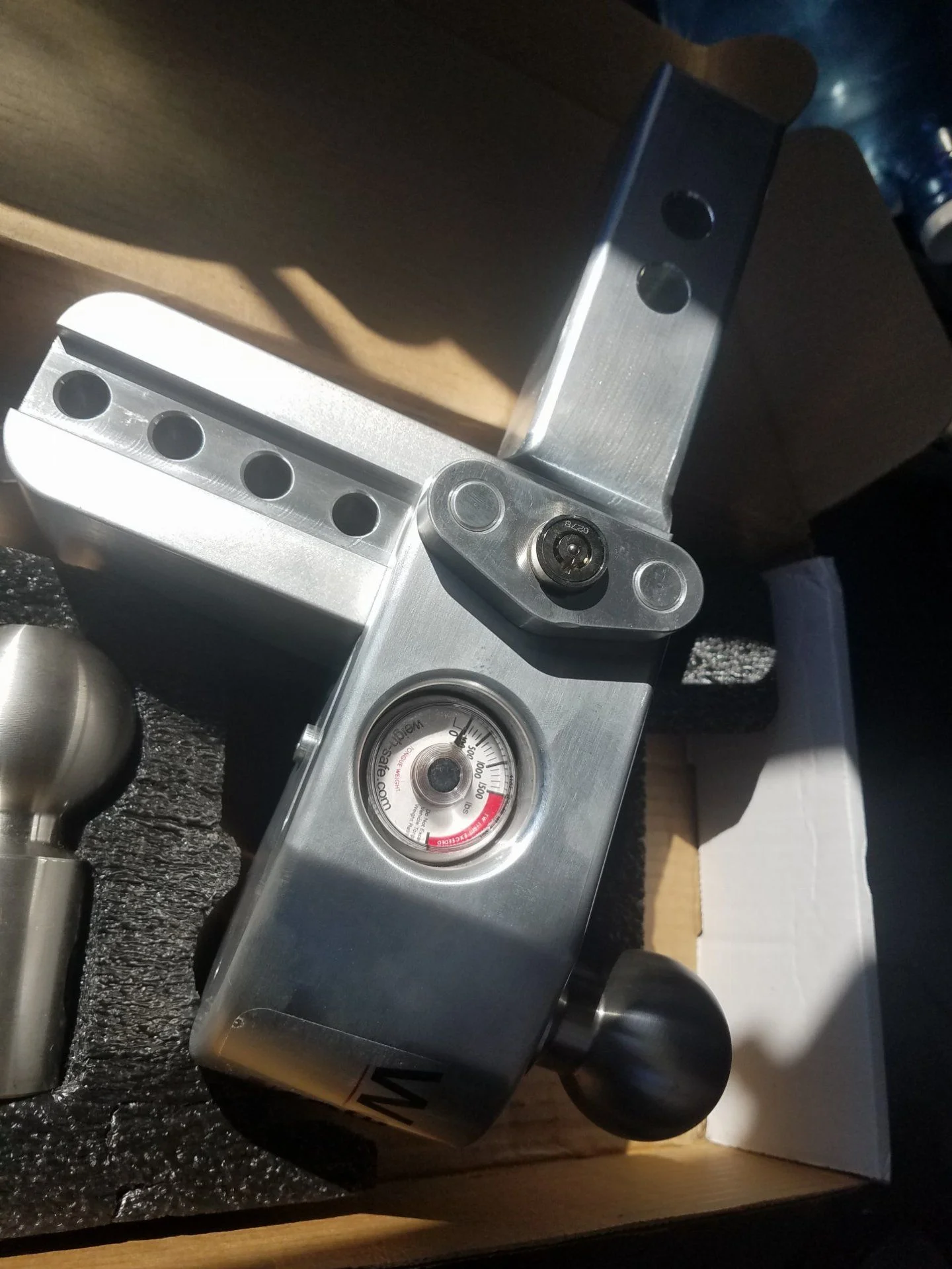

and of course a good tow hitch

Can I get the details on you wiring in your AUX input through your factory head unit?
Good job so far. In the above pics where did you take the truck off-road? Looks like Santiago peak in SoCal.
yeah, ill do it in t he morning and give u a very simple way to do it, :) i did it a hard way and ended up doing the easier method :)
actually, i can just tell you now.
so just take out the tape deck carefully (easy to find write ups on that) then u just cut the magnetic tape head off (the thing that reads the cassette tape) i personally went the cleaner route and unsoldered them. on that same side, that ribbon was soldered to you will see 2 bumps that look almost like small potentiometers and there is an L and an R on the PCB near them. Just solder straight to the connections going into each little potentiometer looking thing. The solder point will be the OUTSIDE of each box, so closest to the edge of the PCB. Be careful not to unsolder the box itself, because it has a solder point directly under it as well, if u do u have to trace the connection with a spare wire etc. actually, I think there is a youtube video for u to watch because i am probably doing a horrible job explaining it ;)

that offroading spot is Otay Mountain Truck Trails, then we got lost and had to get have border patrol open the gate to let us out, or else we would have 4 hours back of the same trail haha

its really not that hard :) just some solder and some wire ;) and some creative wire runs :) my fav budget soldering iron is the hakko FX-888D
