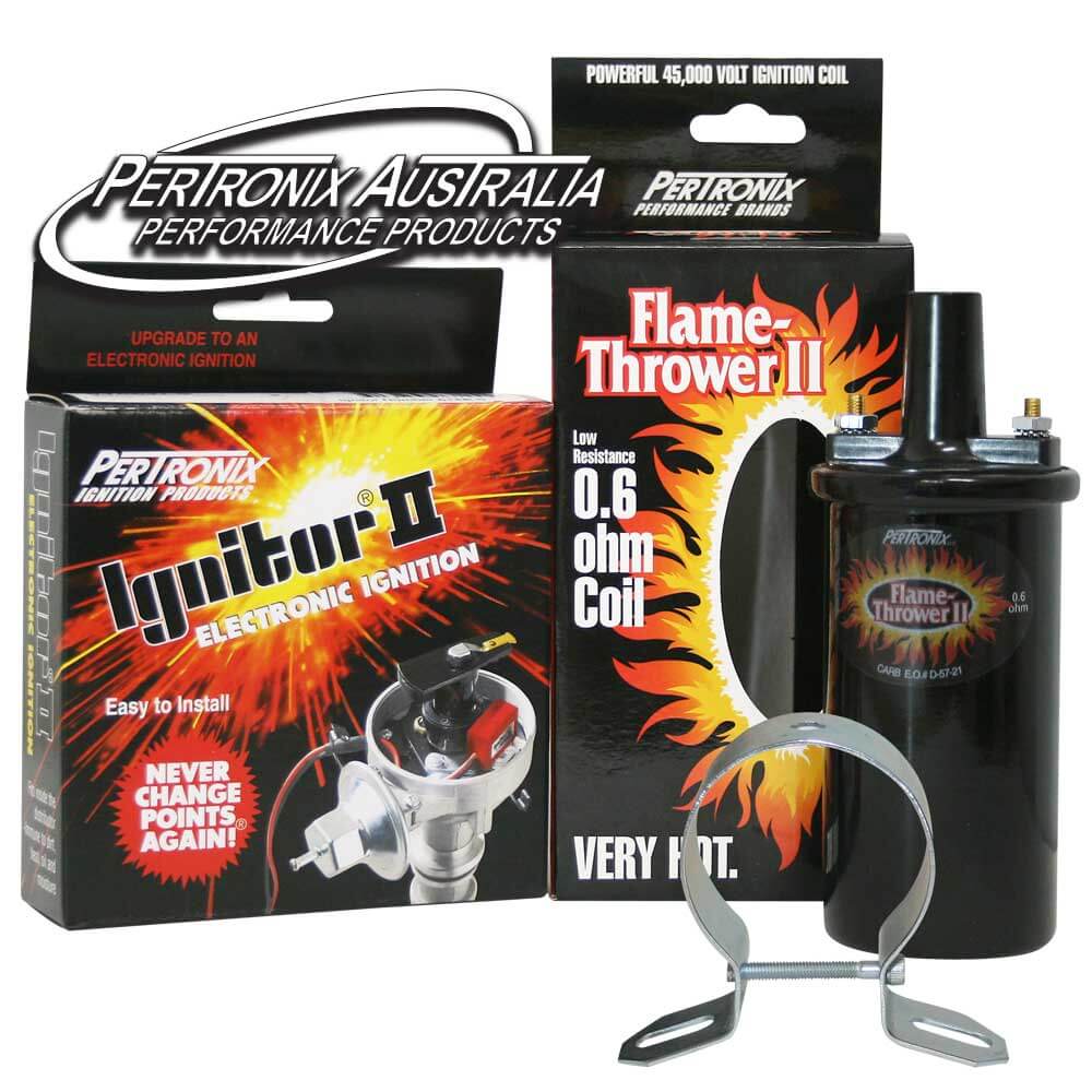

Awesome that's mate!! I appreciate the detailed response. Re the AMF and the points a lot of what I've been reading has pointed me to the following type kits, what are your thoughts on this to avoid wear on the points?
ignitor II Kit - Coil and Bundle
This type of electronic ignition is a healthy upgrade for sure. In fact, I’m going to order one myself!
However , I was referring to the points inside the housing of the AMF. The AMF has a small, very analog style circuit board inside with several copper contact points along with a rolled spring loaded gear.
