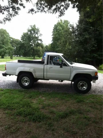

Thanks for the info,I'm going to get the tps looked at next week. Here are a few pics
Nice truck. Been looking for one like that for a while. Thats my favorite body style.
Thanks! So I had the tps and the timing checked and both were ok. I replaced the fuel filter and the pcv valve and the occasional miss has gotten better. The miss used to be more at acceleration, slight or heavy but not all the time. Now it seems to be more at decel. Say you cruising at 55-60 and crest a hill and back off the throttle it will stumble usually just once. If you give it gas or let totally off it will go right away. It will still occasionally do it upon acceleration. Any one have any more thoughts as to what is causing this? I am thinking of changing the o2 sensor but wanted to get a few more opinions before I did so.
