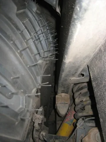

  2. Rear axle framerail- We lifted the station wagon ~28" with no interference. It was close, but no interference. We may have been able to lift a lttle further, but the tractor was starting to come off the ground.;p Pic: framerail sm..webp

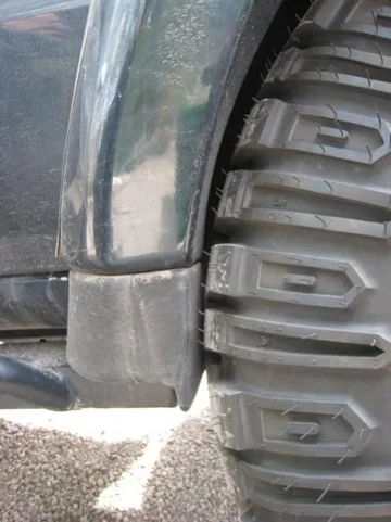

  3. Rear axle wheel well front- I'll trim the edge of the wheel well and fender flare inside the wheel well with the Dremel. I may have to trim the rubber that gaskets the backseat door to the slider, but probably not. Pic:wheelwell ft sm.webp

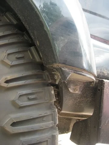

  4. Rear axle wheel well rear- I'll trim the inside of the fender flare a little bit with the Dremel as well. Pic:wheelwell rr sm.webp

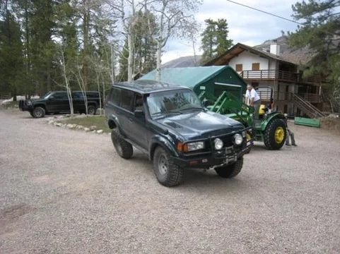

Here's a coule flex (read: poser) pics.:grinpimp:

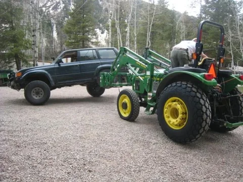

It's hard to tell, but the rear DS tire on the tractor is starting to come off the ground here:
Here's just a decent flex pic. You can see my new hood vents well. You can also see one of the guys in manland sitting on the hitch of the tractor trying to keep it on the ground. We never had this problem with my minitruck:confused::rolleyes:.

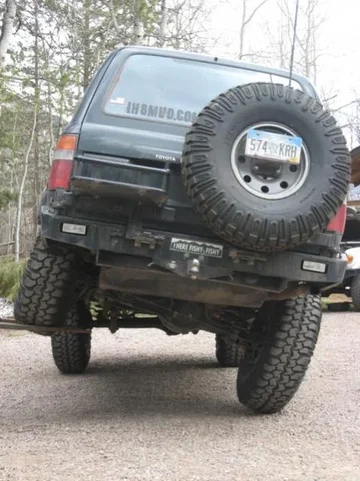

Lastly, here's a rear flex pic.

Awesome...but I don't think that is full flex in the rear. Was the stuffed tire side on the bumpstop in those pics? Backspace on your rims?
I just trimmed the metal to the rear of the wheel to have ~5.5" of clearance all the way around - my LCA's are 3/8" longer than stock to correct pinion angle, though.
Looks like you have a good fitment overall - 37's really do fit pretty easily on these rigs, and although they initially looked big to me now they just look proportionate. Perfect tire size for a 4" lift as far as I am concerned.
Didn't check.:meh:
I had to hurry back home because the :princess: had to go somewhere, and I had to watch the kiddos.
We musta been close though as the DS rear tire on the 80 was about to come off the ground, and the tractor was coming off the ground. If there is slight rubbage on the framerail. I'm fine with that. It'll happen at low speed, won't be much (if at all), and like I said, if you aren't rubbin' your lift is too high.:hillbilly:
