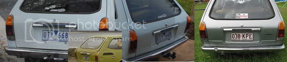

Edit: 1975 Corolla wagon looks right to me...
But those are super rare now. Much easier to find 20 60-series ina scrap yard before you find one of those...

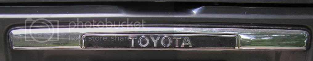

As close up as I could find:
Compare to the 60/62:
But those are super rare now. Much easier to find 20 60-series ina s**** yard before you find one of those...
