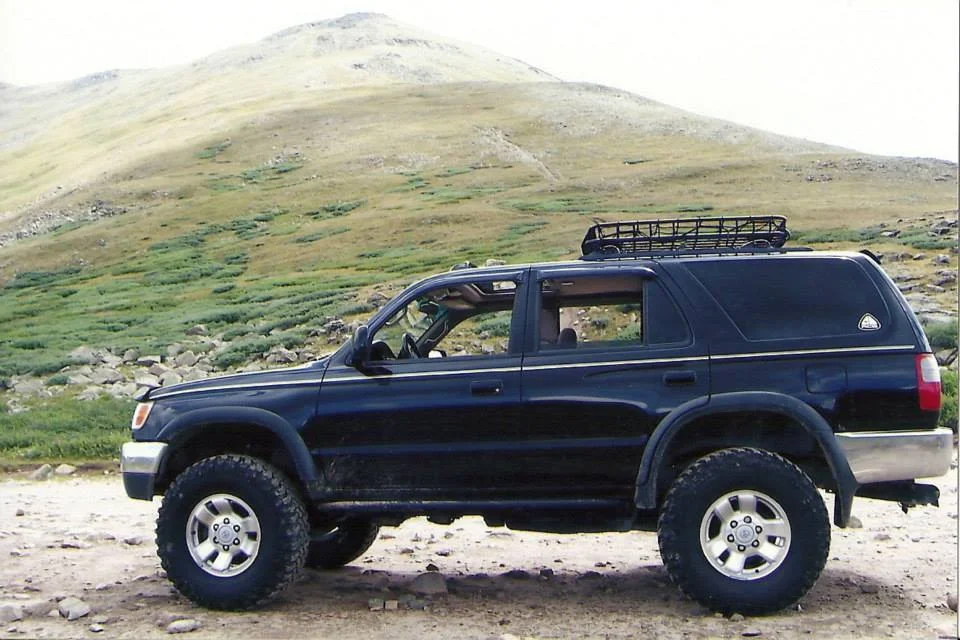

Finally a moment of silence for my sold 4runner..........

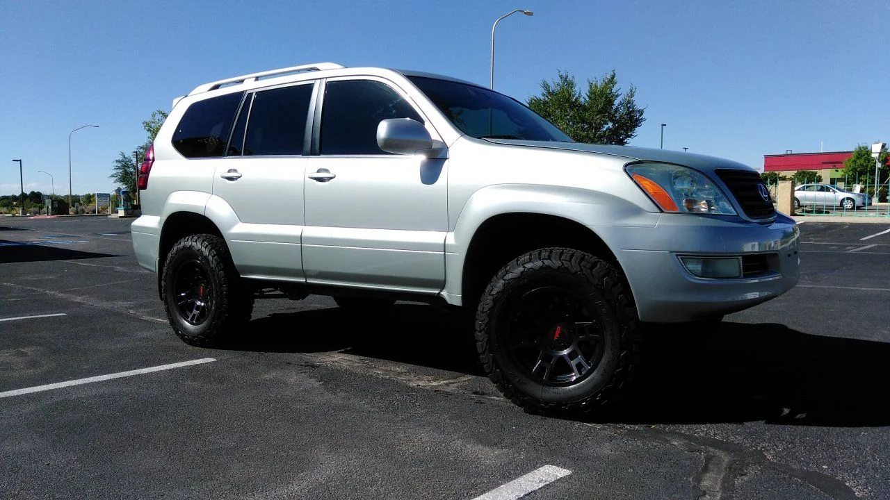

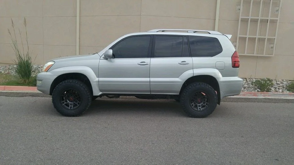

I installed the suspension/lift today. Everything went pretty smooth other than the factory front coil overs being stuck in place. Took about 45 min with a sledge hammer and BF screwdriver to pop them out. Here are a few pics right after I was done, I will get some better ones after I clean her up.
Looks great!, I think I am going with your exact suspension set up and tire size. Any links to where you purchased everything you needed for the suspension?
Was the installation pretty easy/self explanatory or did you use someone's write up to help you? After the suspension and tire upgrade, was there anything you needed to do (alignment, extended brake lines, castor correction, or any other adjustments)? Those are the things we had to do on my 80 after lift and tires, so just wondering if there was stuff like that for the GX470. Thanks for any advice!
Thanks! I will post links to where I purchased all the parts for the suspension. The installation was pretty easy since I had done the suspension on my 3rd gen 4runner and a few friends 1st gen Tacoma's, so I had a little experience. There are a few things that are a little different so I watched the videos that Dan Kunz posted on his facebook page when he helped a GX owner install their suspension which helped. After the lift was done I got the alignment done right away and had to trim a little off the front wheel well liner since it was rubbing a little at full lock. I did not get upper control arms yet so the alignment was not 100% to spec but close enough for now so the tires should wear fine and it feels perfect on the highway at speed. The suspension feels great, a little stiffer and more truck like than stock but I like it better that way. That's about it, let me know if you have any other question.

Did you have to deflate the spare for the stock location? I am assuming yes.
No it fits. I found a slightly used 275/70/17 BFG KO2 on EBAY and had it mounted on the factory spare wheel and it just barley fit in the stock spare location fully inflated. I don't see how some guys are getting 285's to fit under there though.
I'm glad you posted your specs that is a sharp looking rig! I'm hoping to have the stance and tire size on mine. What did the rims set you back if you don't mind?
Thanks man! The wheels run $699 a set and they include a set of lug nuts as well.
