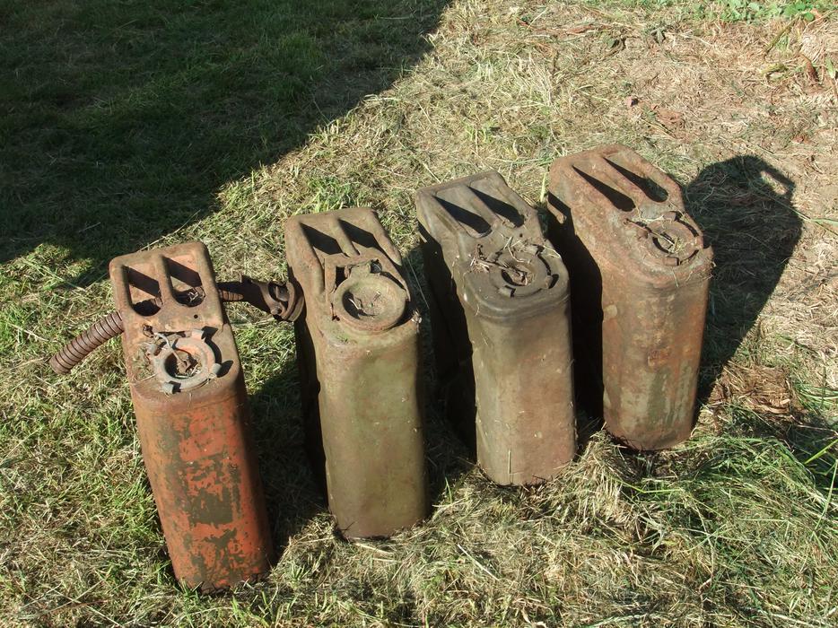

Old school. Wonder if these could actually be cleaned up and safely be used for diesel....? Or good as antique garbage only?
http://www.usedvictoria.com/classified-ad/JERRY-CANS_25626875
GTSS...I have an old metal one you can have for free if you want to try and clean it up and restore it. No idea of history as I got it out of someones back yard.

Thanks PeeZed! I'll look into it a bit and see if people still use these old cans successfully. Will let you know.
Did you figure this out? My uncle had some of these, put different sized ball bearings inside and shake it like a mad man, this will knock off all the rust inside. Then you can get a fuel tank liner that you pour inside and make sure it coats everything. Then they are good to go! A little sand blast on the outside and they will look good as new!
I didn't end up buying them, but I like your procedure for renewing them. The ones I linked to sold, but I'll keep my eye out for another to play around with. Thanks for the heads up!

I just thought the old steel ones were sort of cool looking and would be neat to revive a couple. Clearly not worth the effort though.
