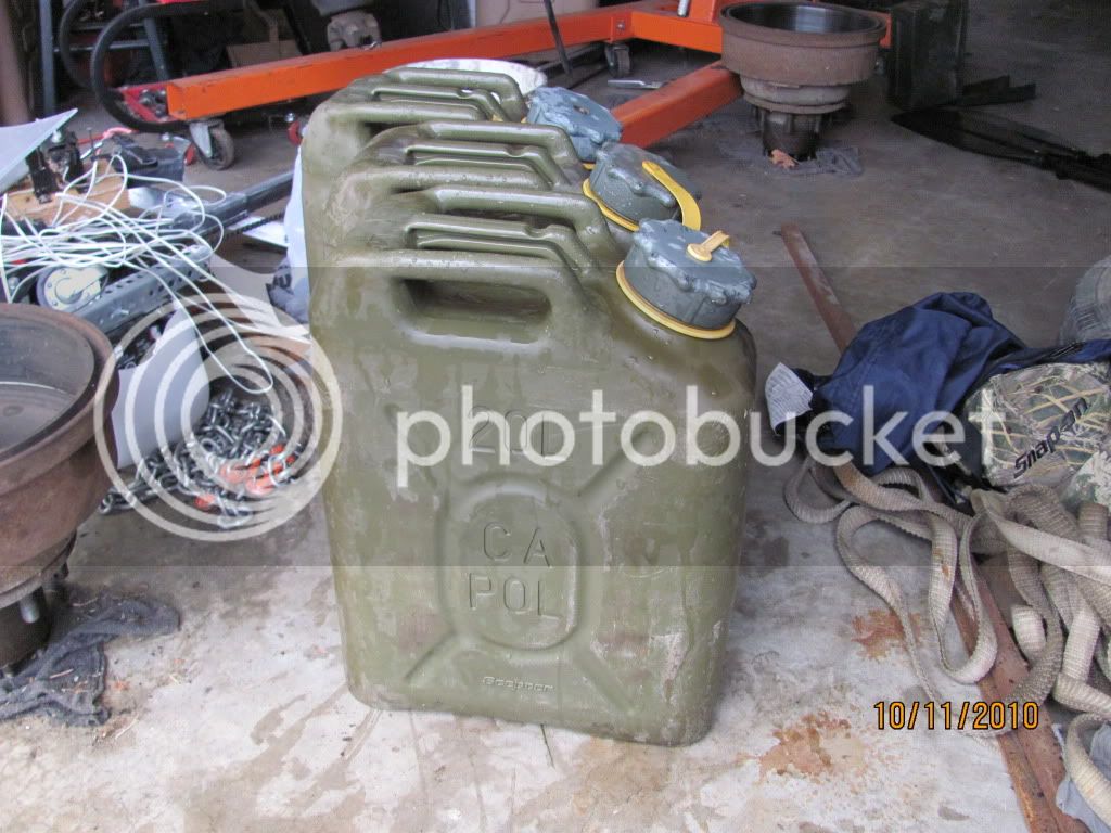

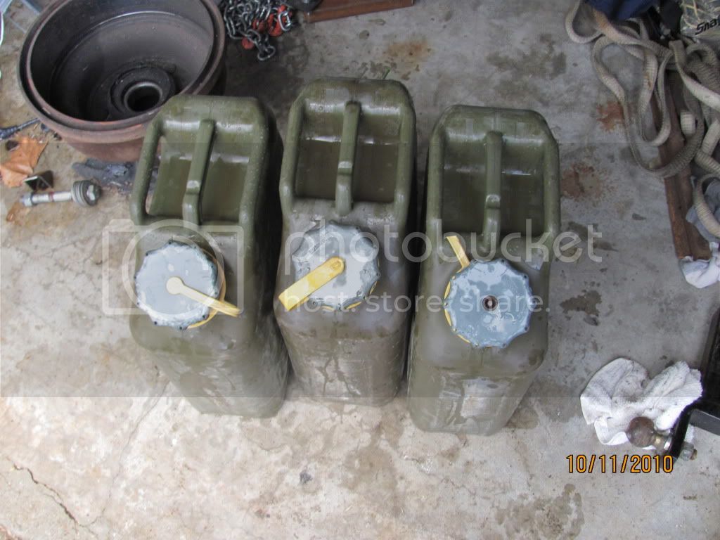

Well I took some advice and did some looking around and found these for thirty bucks each. The seals are good but I need the ones for gas, as these are for diesel. Was this a reasonable deal? I'm not sure what the markings are, but they are scepters.
Please excuse the garage.
excellent deal.

Seems like a great deal for the Scepter cans! Plus if you post up you might find someone looking to trade the gaskets. I saw a guy on Rising sun just the other day that had Sceptors & was looking for diesel to replace his gas gaskets for....

I have these same cans... Anyone know if you can use them for gas???
