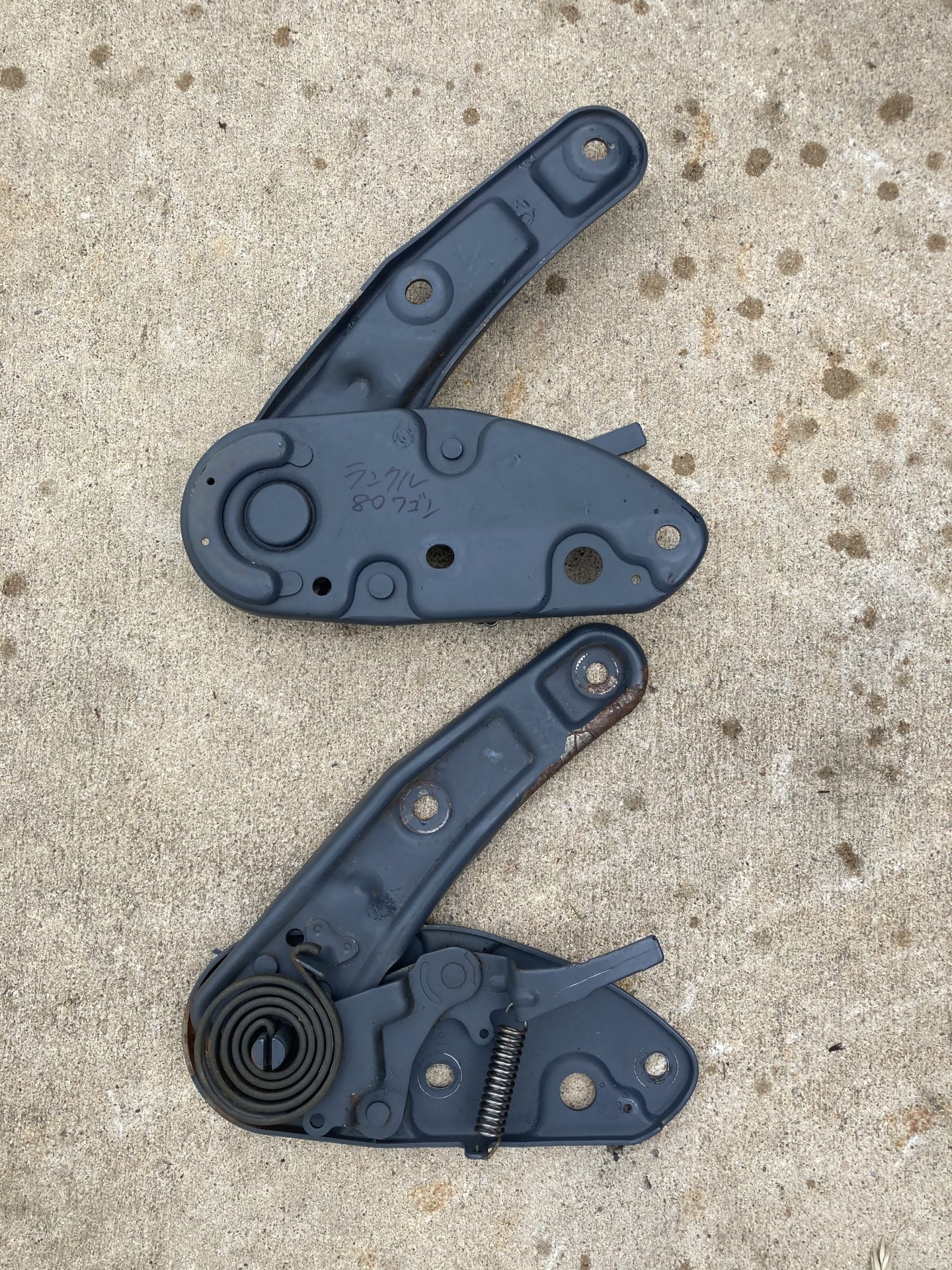

anyone know how the second row hinges work? the pair here seem to only latch at one spot when you recline them and when you pull the lever they tilt forward.
ans i am trying to figure out if i can test them before installing them.
unfortunately these came with a reasonably significant amount of rust not disclosed by the seller so i am wondering if i may also have an issue with the functionality.

Review the picture in post #7.
No pin = recline. You appear to be fine.

from what i understand the PIN is taken out to recline /third/ row all the way in the back. and i actually took out both pins in the back.
so now i am working on the second row. and those need JDM hinges or you need to swap out with (of fabricate yours) gears that have more teeth so it “stops” when it is further reclined. the US gears don’t have any teeth at the fuller recline AFAIK.
anyway, i was kind of hoping to know if there is a way to know these are working before installing them since i need to take a wire brush to them and spray primer to clean up this rust first if i am keeping them.
below shows the pin you take out for the third row seats.
i think i need to keep these JDM second row seats or i buy a set of gears and swap them out off that thread(?). so i was kind of hoping to buy JDM gears for the second row and save the time. if all that makes sense...

not sure but i guess i am looking for it to latch in multiple places beyond the normal upright US position?
i just can’t see how it is going to work based on the way they work not installed. so i was wondering if anyone has any experience with them.
seems like they should catch in multiple positions beyond upright. but again it does not appear they are going to want to do this but i may be missing something.
As usual you're overthinking this. It takes about 5 minutes to swap the hinges. If you need additional positions take a file or a Dremel tool and add notches just like the third row hinges have. Keep in mind that the seatbacks will not fully recline as the wheel wells limit the travel.
