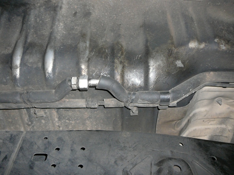

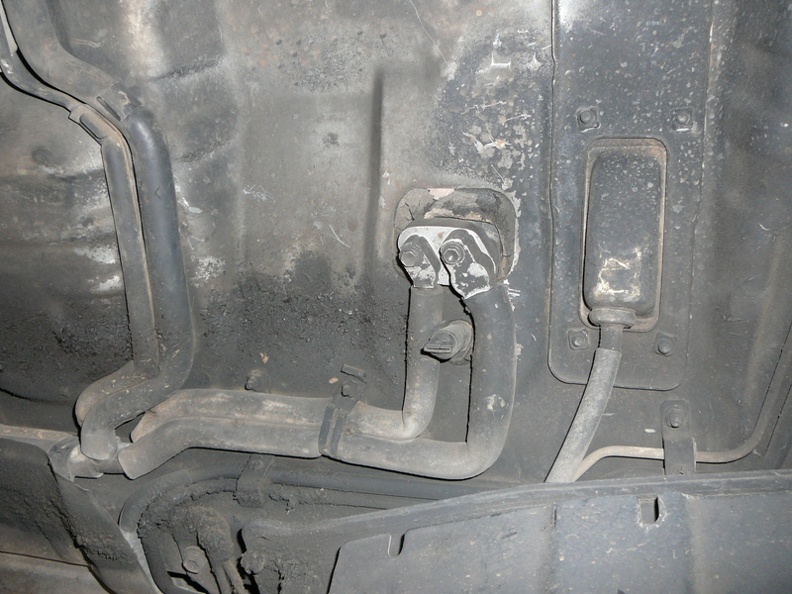

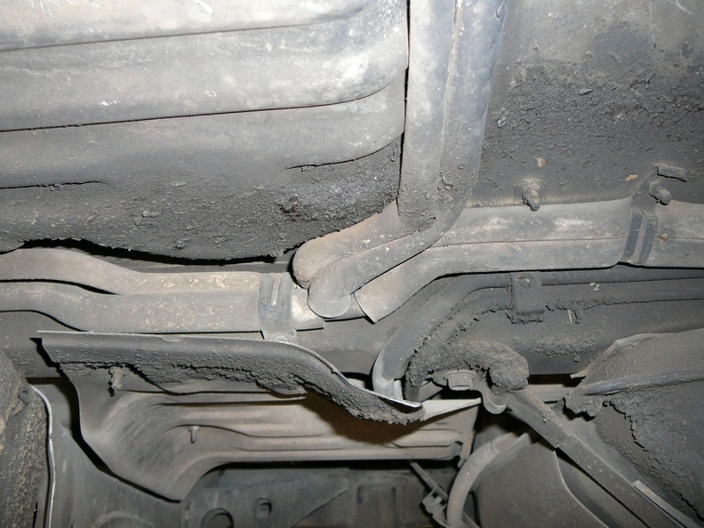

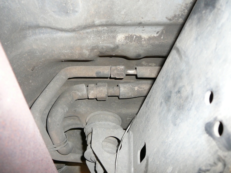

took these pics when was doing my tranny swap .. ( no other way to take 'em with tranny in place )
under console connection pipes ..
