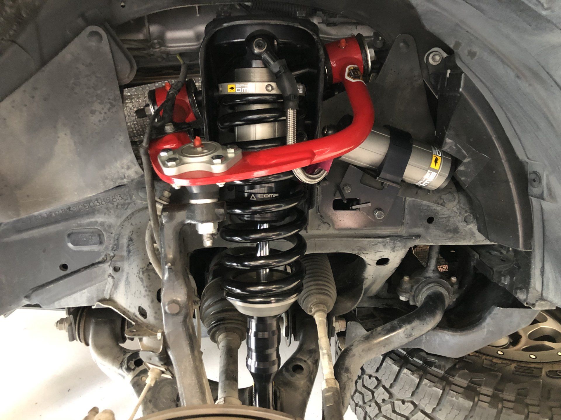

I too have the JBAs running a 285/70/17 tire and 10mm offset on my wheels. I've been happy with them so far. I do get some rubbing at full lock but I have yet to do a body mount chop. I plan to swap to my wheel setup on my 4Runner which has 1.25" Spidertrax spacers and -6mm offset wheels with a 4.5" backspacing.

Good looking setup.
