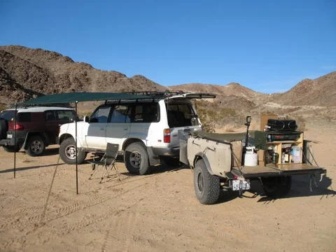

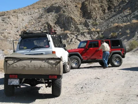

Looks great, mine I think is a 78' or 79'. I kept the stock axle since I wanted to keep the shocks; really helps out a lot. Also I had sheet metal welded to the top of the tailgate to get a flat surface. I just Duracoated the body since it was in bad shape anyway. The frame was completely powder coated. I'd like to add a RTT to it soon.
thanks guys! as far as i can tell its 72, i too am going to add sheet metal over the tailgate. been a fun project, the bedliner is getting good and hard now.
gsdog-what size tires are those? i have a set of 265/70's im thinking ill throw on
Nice. And more cargo room than a jeep trailer. And you can put a canopy on it too.
