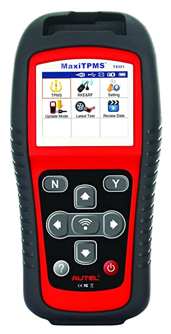

This is what I use. Toyota's require the obd2 feature to program in the new codes. I had the cheaper one without the Obd2 capability, which worked great on all my other non totota vehicles. I had to upgrade to the 501 to be able to swap wheels and tires around on my Toyota's.
You can find this tool on Amazon for 245-300.00.
AUTEL MaxiTPMS TS501 TPMS Service Diagnostic Tool Auto Scan Tool OBD2 Car Scanner Tire Pressure tool TPMS sensors Relearn
So this arrived just now and figuring my next steps. Thanks for the recommendation. To be sure my understanding is roughly correct: Once the spare tires are mounted to the rims (with second set of sensors), I will use this tool to get the new sensors to communicate car so that the car can "learn" them. Then next year when i put the KO2's back on I need to repeat the procedure but with those set of wheels?. I am reading the manual and consulting YouTube videos to figure out what to do with the spare set right now. Confusion!!!
