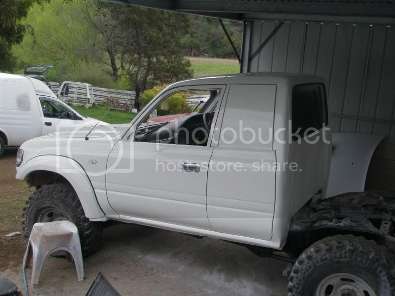

Hi Aaron
Hope this works, here is some pick's from a Prado chop (1998) into a twin cab.
This might give you some ideas.
Just go ahead with what your thinking , then when your done step back and watch how quick your "custom rig" gets copied or try to.
I chopped my FJ40 into a Ute 7 years ago, was still in the process of full rego / engineering and 2 panel shops were trying to replicate similar rig's.
Chris

Hi Aaron
Chris
that does look good. iv not dont a chop be for but have got the ball to try it. iv got mate had have a panel shop that can help me out as will they will most likely finish it off any way as i would want the front gards opened up by at lest 3inchs. the biggest thing im having trubble with is working out the links for the diff after that its not that had as i would never get a prado with 37s over the pits anyway. iv lots of ppl on pp say the projsct is just a wast. but when its all done i better all the mates will be sucking up big time for a look.
