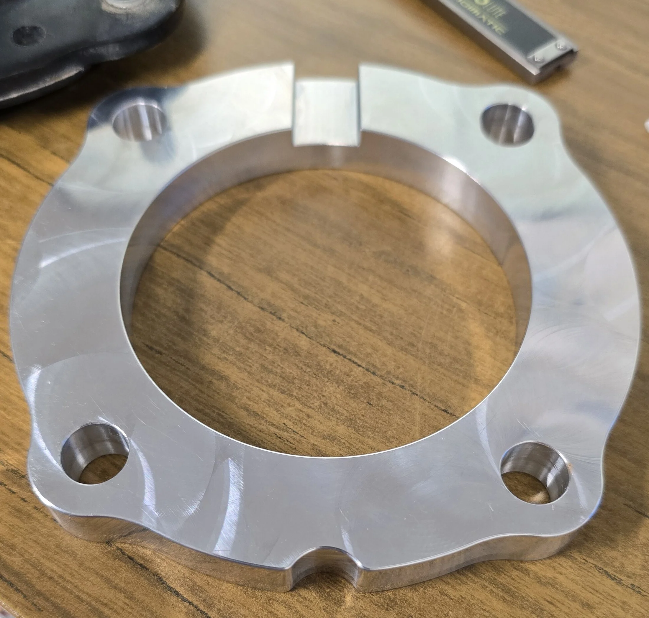

You might consider a slightly more aggressive front spacer with for the taller rear HE. These just came out.
Very cool. Is this a factory part or after market.
Not factory but if you look around, E&E makes some of the highest quality gear outside of OEM. Owned by a great enthusiast here - @turbo8
The stock ~9mm spacer lifts about .75". The 13mm spacer will put you just about perfect for an HE at about 1.1". A nice OEM+ style mod. It also has the benefit of increasing suspension droop travel increasing off-road articulation.

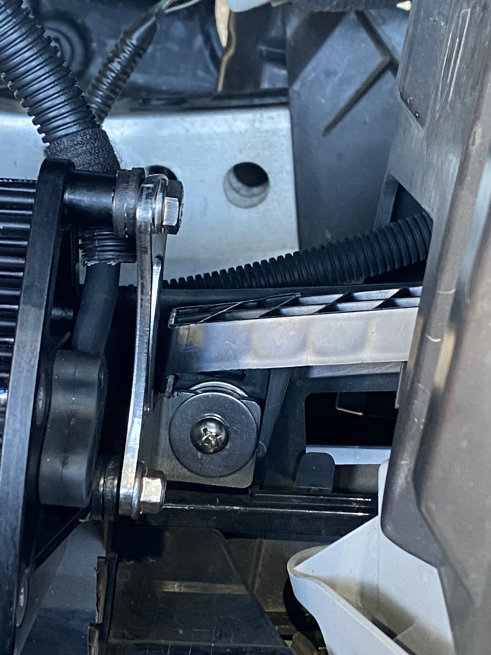

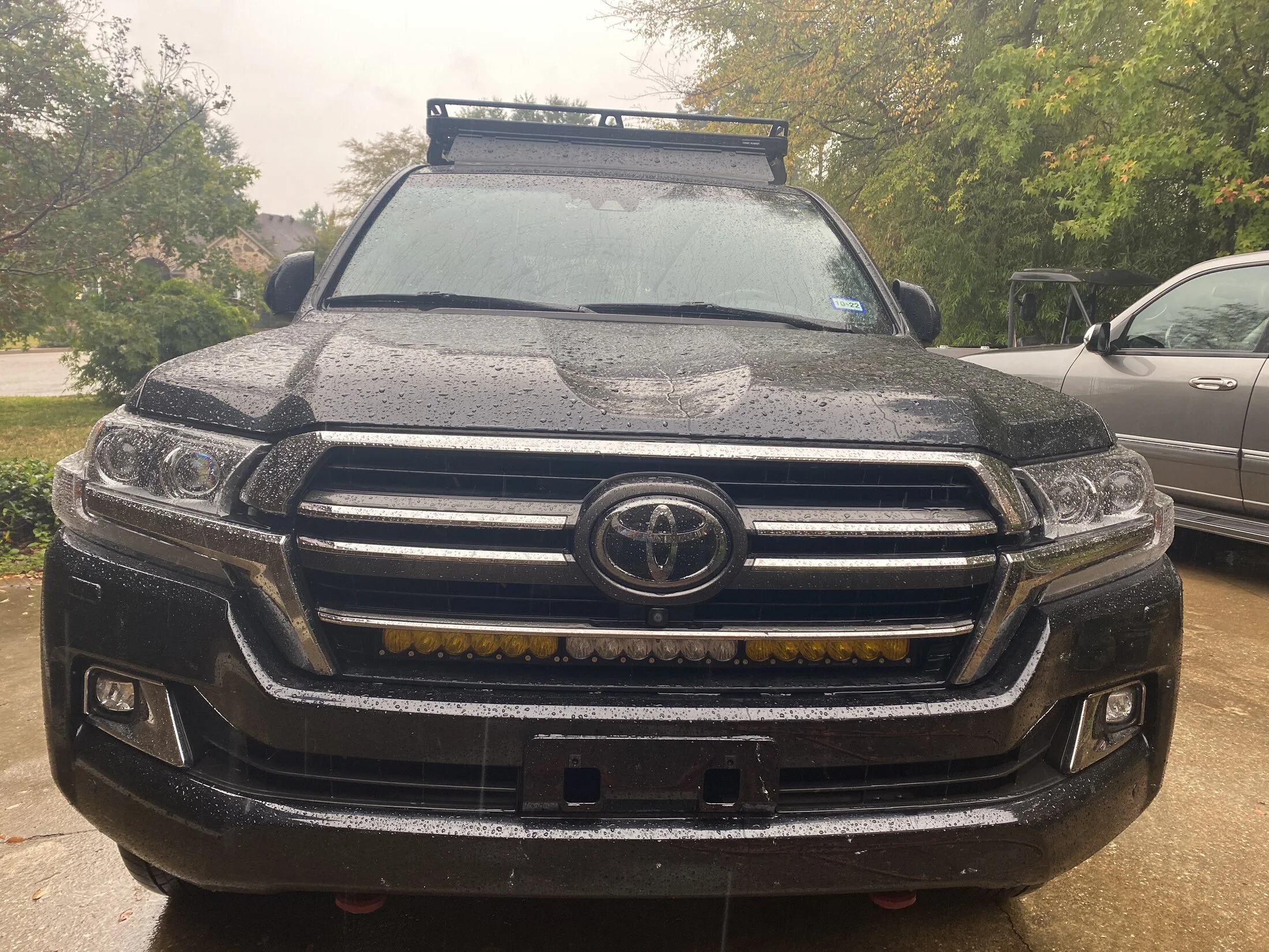

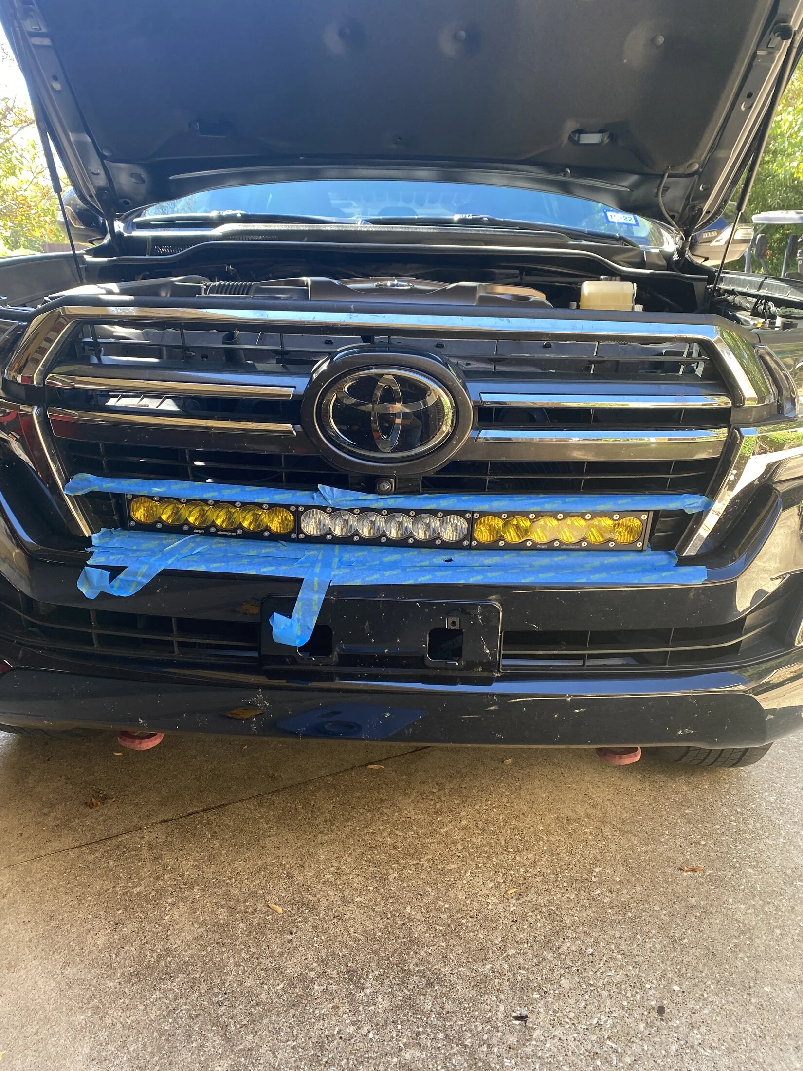

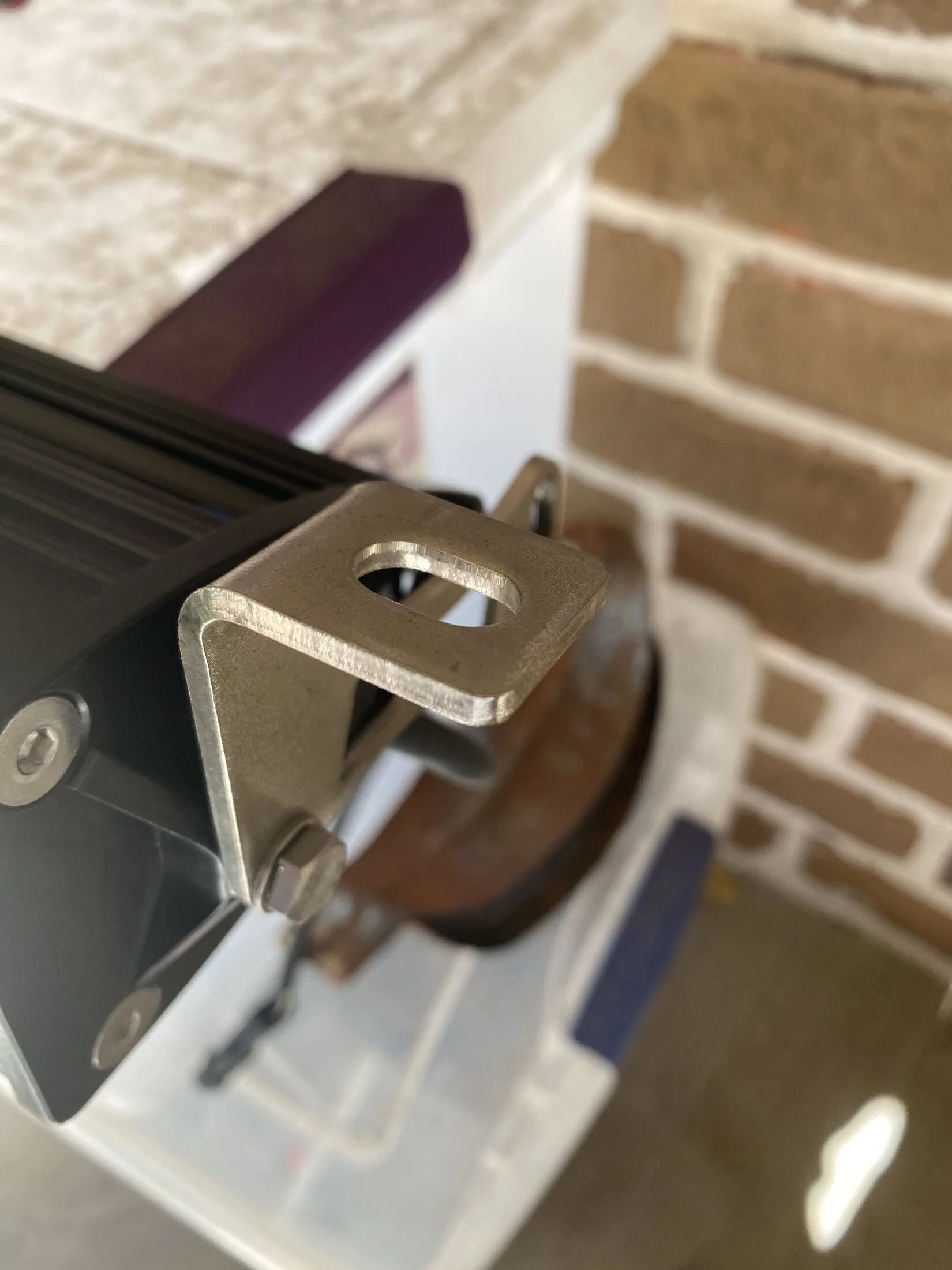

Maybe its my personal view, but I find lights overhead reflect off the hood. I installed a Baja curved ONx6 dual control PN 52-3003DC into the grill with not too much difficulty over a weekend. I was able to cut the grill in place and mount from above using factory bolt holes, after a slight trimming of the ducting to the oil cooler piece.

Man this is exactly what I’m looking for - where did you end up putting the switch inside if you don’t mind me asking?

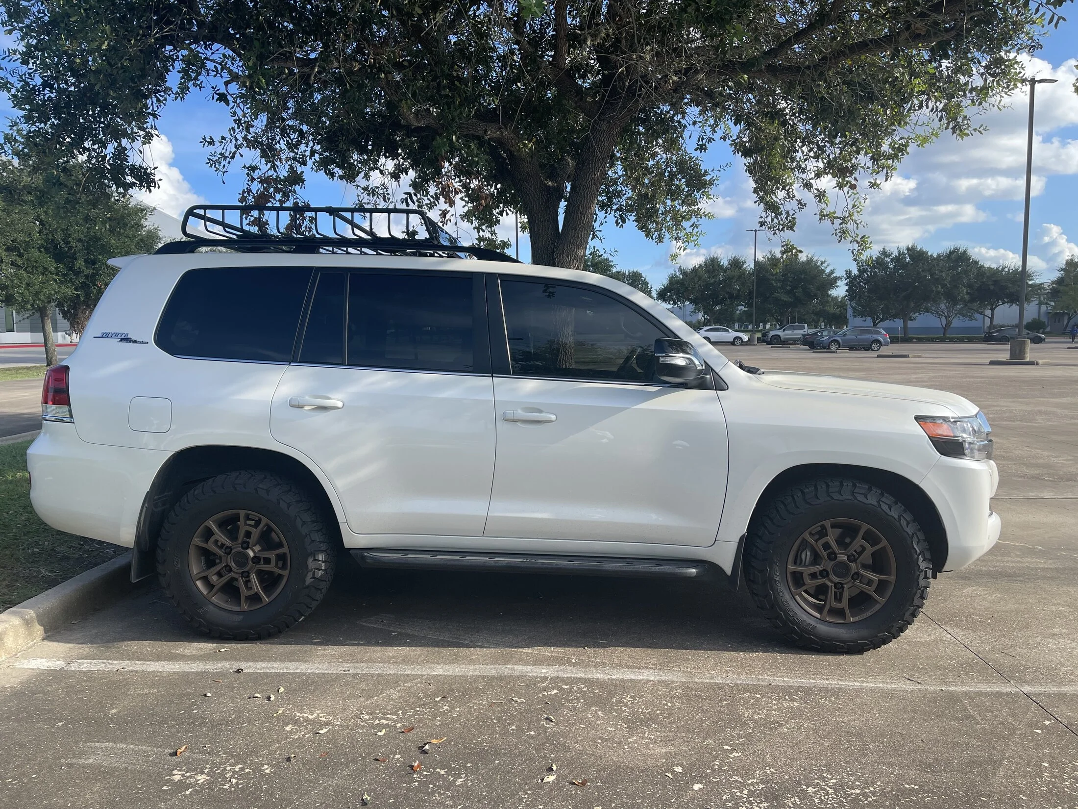

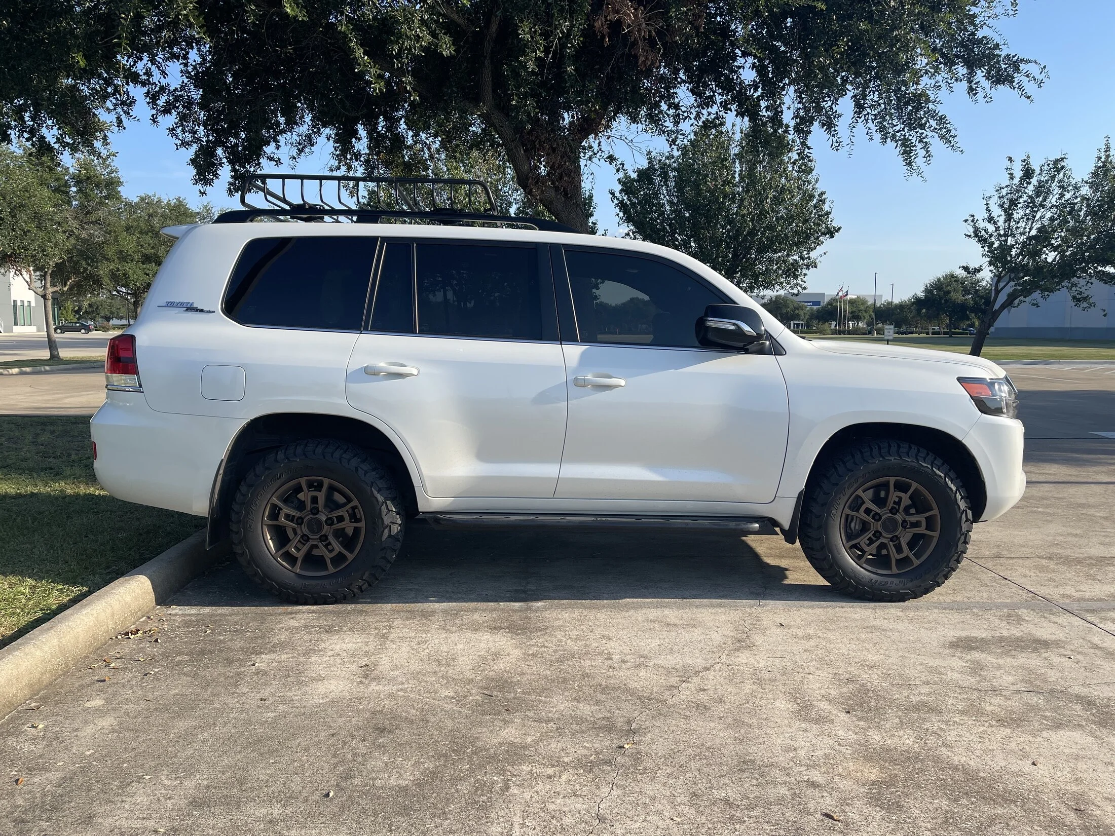

Ask and you shall receive. Here is a before and after.
Before
After
As you can see it is not a dramatic increase, hence why I sometimes consider the other options discussed here. Some say the non-OEMs are fine, some say they mess up with the angles. I am a fan of OEM and wanted to keep a bit of take, but a member here installed the Westcott kit and still kept a tiny rake - half an inch I think. For now, I plan to keep like this.

Mine isn't a HE but I mounted a 30" rigid combination bar in the grille just like this and I'm super happy with it.
Would recommend.

Yeah, I see the difference but it's not a whole lot. I also prefer OEM though, so I may just go with the OEM spacers for now and see how they work.
