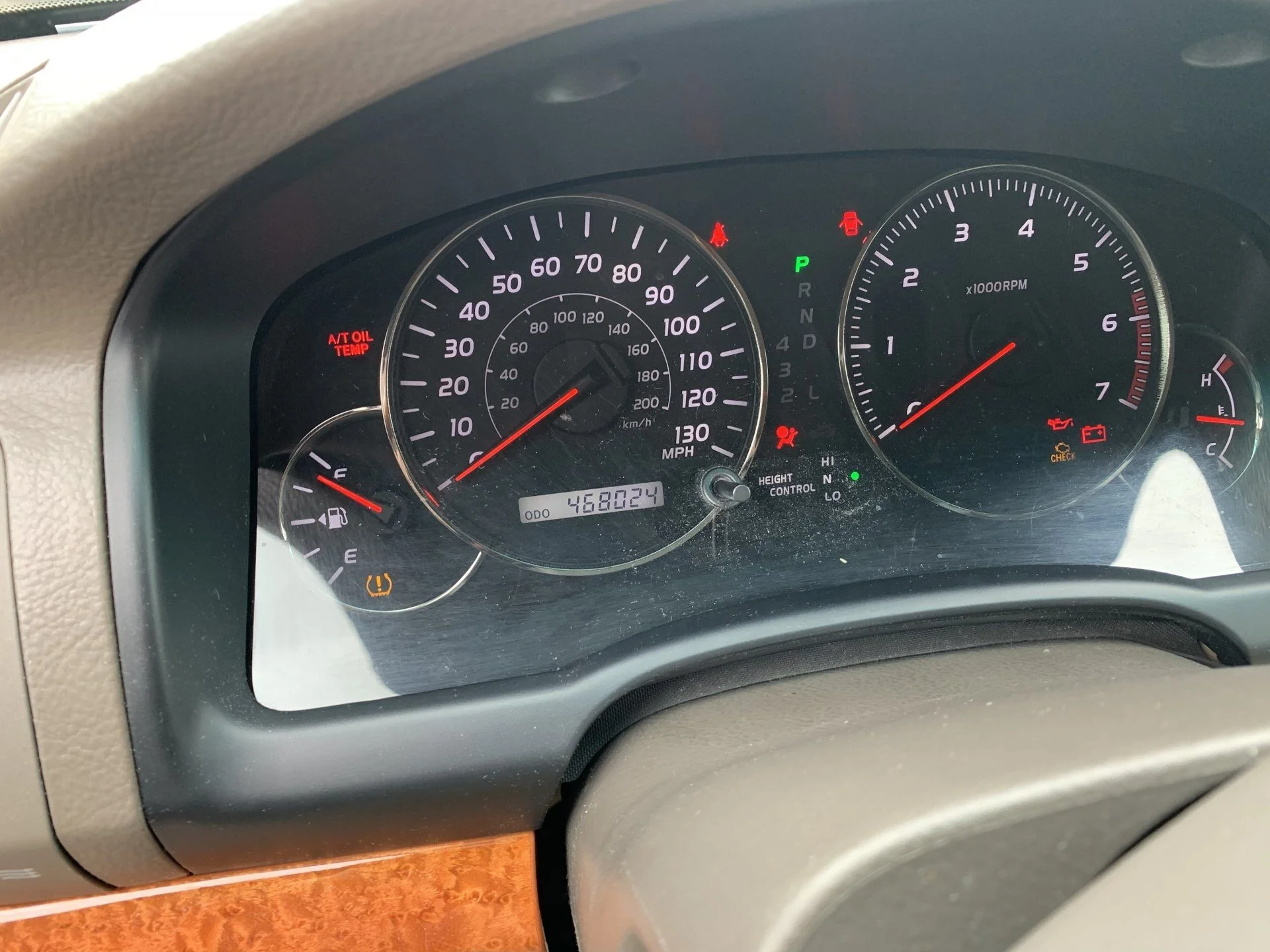

It’s here! My “new” 468000 mile ‘06 gx470 build and troubleshooting thread

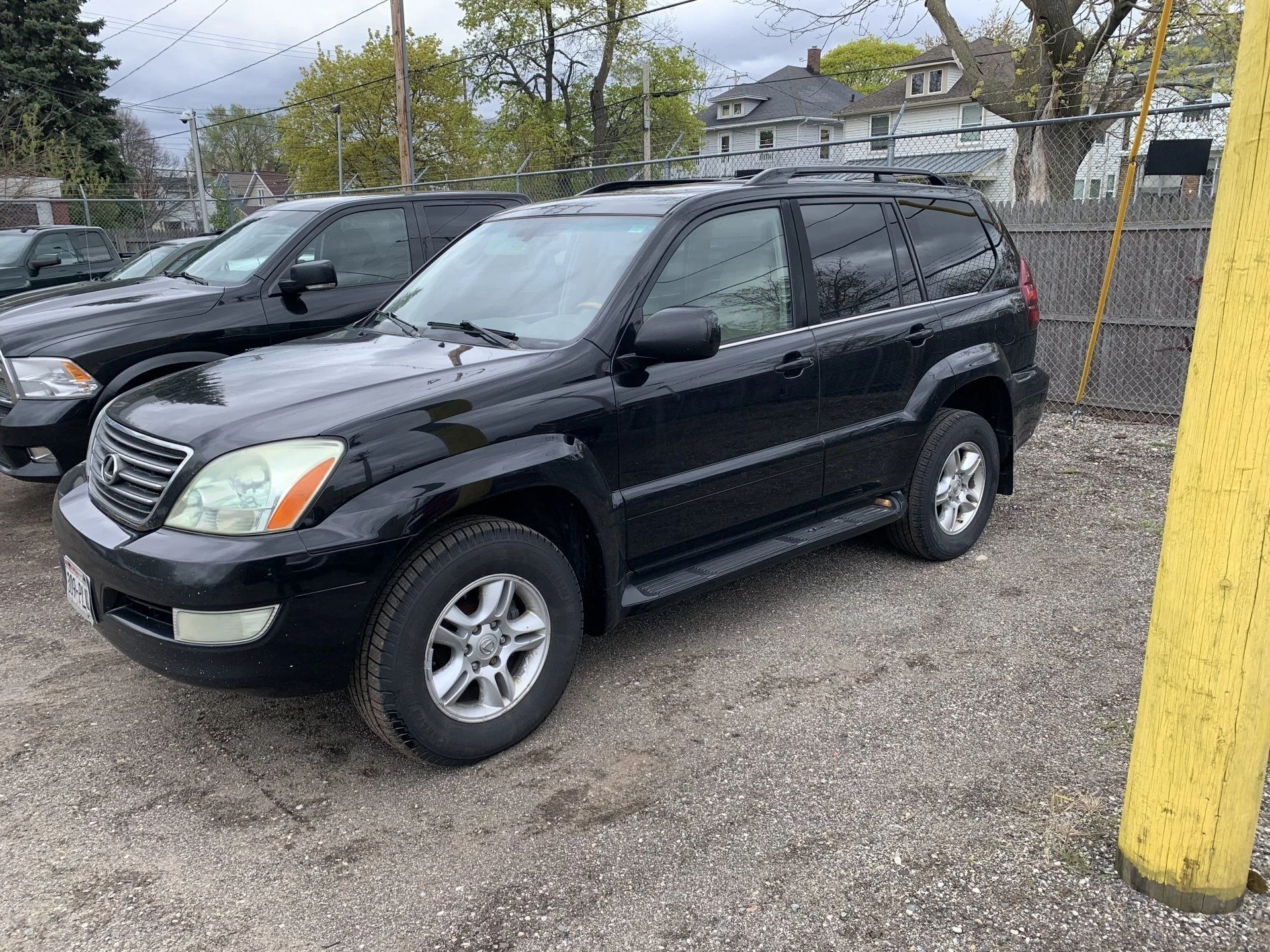

In an exciting turn of events, the owner happened to be in town on business, saving me a flight.
it’s a little rough around the edges, some surface rust spots on the hood and a leaking air bag, but for a free car i can’t complain. Gonna get it on the lift this week and start making a list of what she needs, then hopefully finishing the build before July of this year to take up to silver lake dunes. Thanks to everyone for the advice in my previous thread!

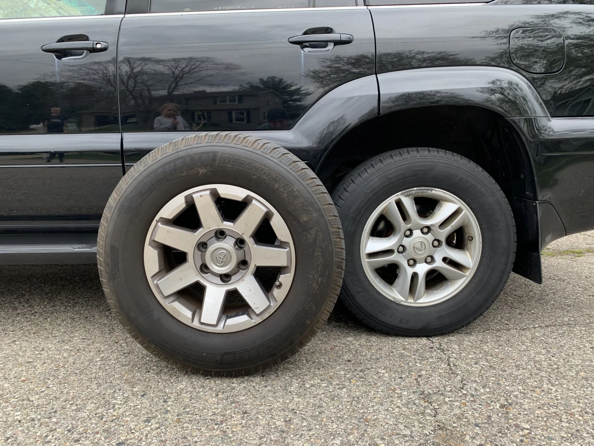

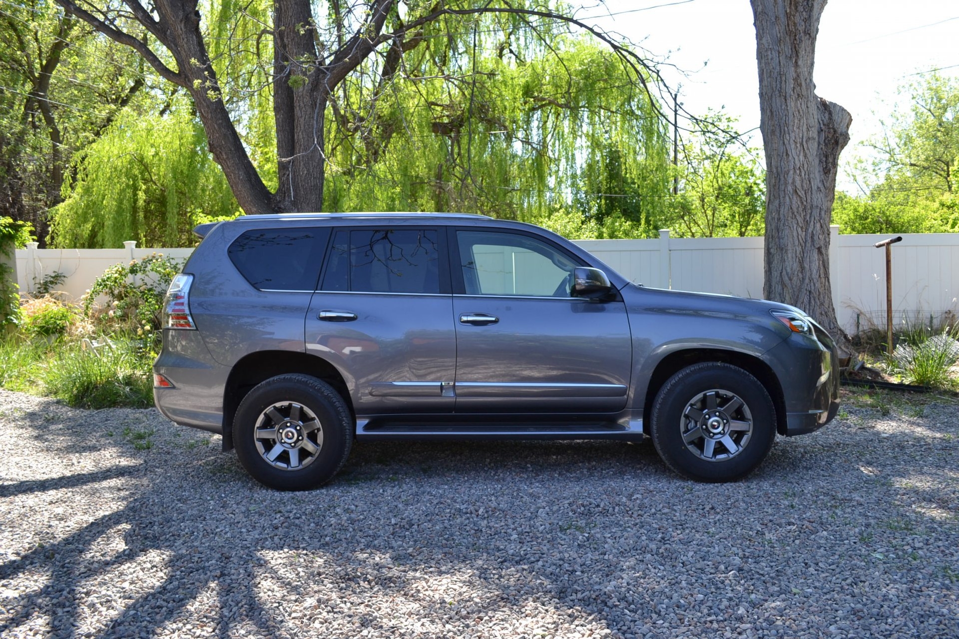

Picked up clean rims with a bit more tire on them. Old tires were trash and the stock rims are also trashed. $375 for the set which i feel is a good deal

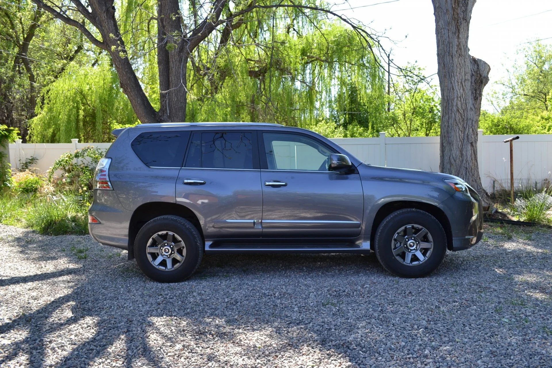

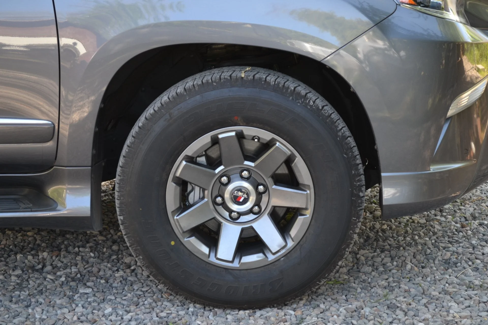

Same style I put on my 460. I painted mine gunmetal to go with my grey. They would look sharp painted black to match your car. I use the ceramic wheel paint. ,comes in a spray can at ORilley. Great wheel paint. I have to get around to posting a picture.
I know all about making a $500 car into a quite expensive car. You scored on the purchase of the car and on the wheels. Take your time. I have a huge list of things I MIGHT do to mine. The planning and anticipation a a good part of the fun .

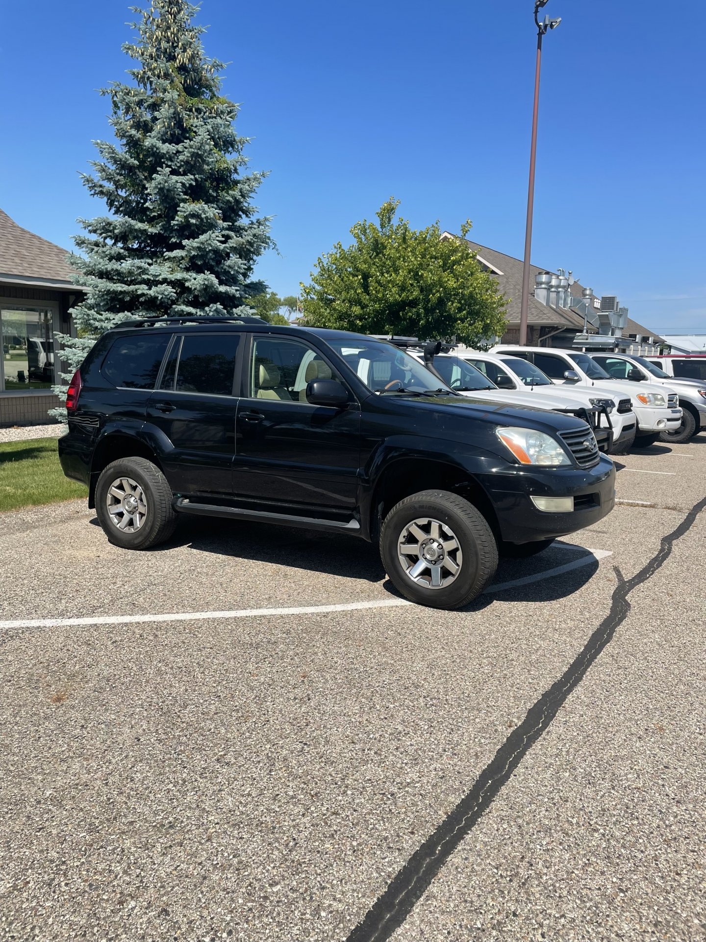

Well it’s almost done (for now)
going in for alignment tomorrow, then timing belt, spark plugs and coil packs and it’ll be “ready” for the summer. Going to have to pick some bigger tires out after i sell my other car.
