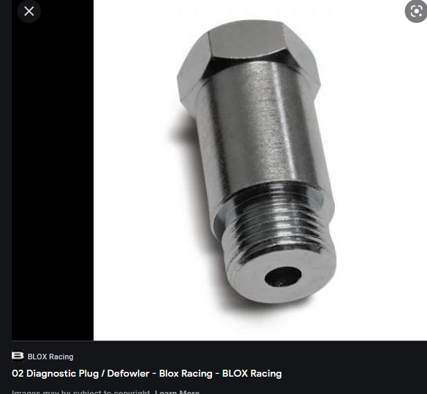

Ive seen people use these with cats failing to clear the codes. Not sure of anyone successfully clearing a check engine light on a gx470 with these.. but worth the try.
If you can get a 90 degree defouler with a mini-cat inside they work very well. I have two of those for my de-catted long-tube headers and get no codes. The 90 degree ones used to be on Amazon but have since been pulled - you can probably find them on eBay. They are chinesium but do work well.
You could also try replacing the O2 sensor. If you do that just get a Denso universal 4-wire sensor and splice it in using some heat-shrink butt connectors. The "first time fit" sensors are way more expensive and I usually find it easier than to just splice it as opposed to messing with unhooking the connectors. The actual sensor itself is exactly the same, the only difference is one includes the Lexus plug, the other is just a pigtail.

my plan after talking to my mechanic is to cut the cats and sell them, then trick the downstream sensors using a defouler. ill replace all 4 sensors when i do.

If your cats are failing you simply need to replace them. Using a spacer or "defouler" to trick your system back to normal operation while still running a bad catalytic converter is a great way to get major engine problems.
I’m not putting new cats on a truck with 475k on it. I’ll cut them instead and trick the sensors
Right. Removing cats and using one is fine, leaving bad cats in place and using one is a TERRIBLE idea.
