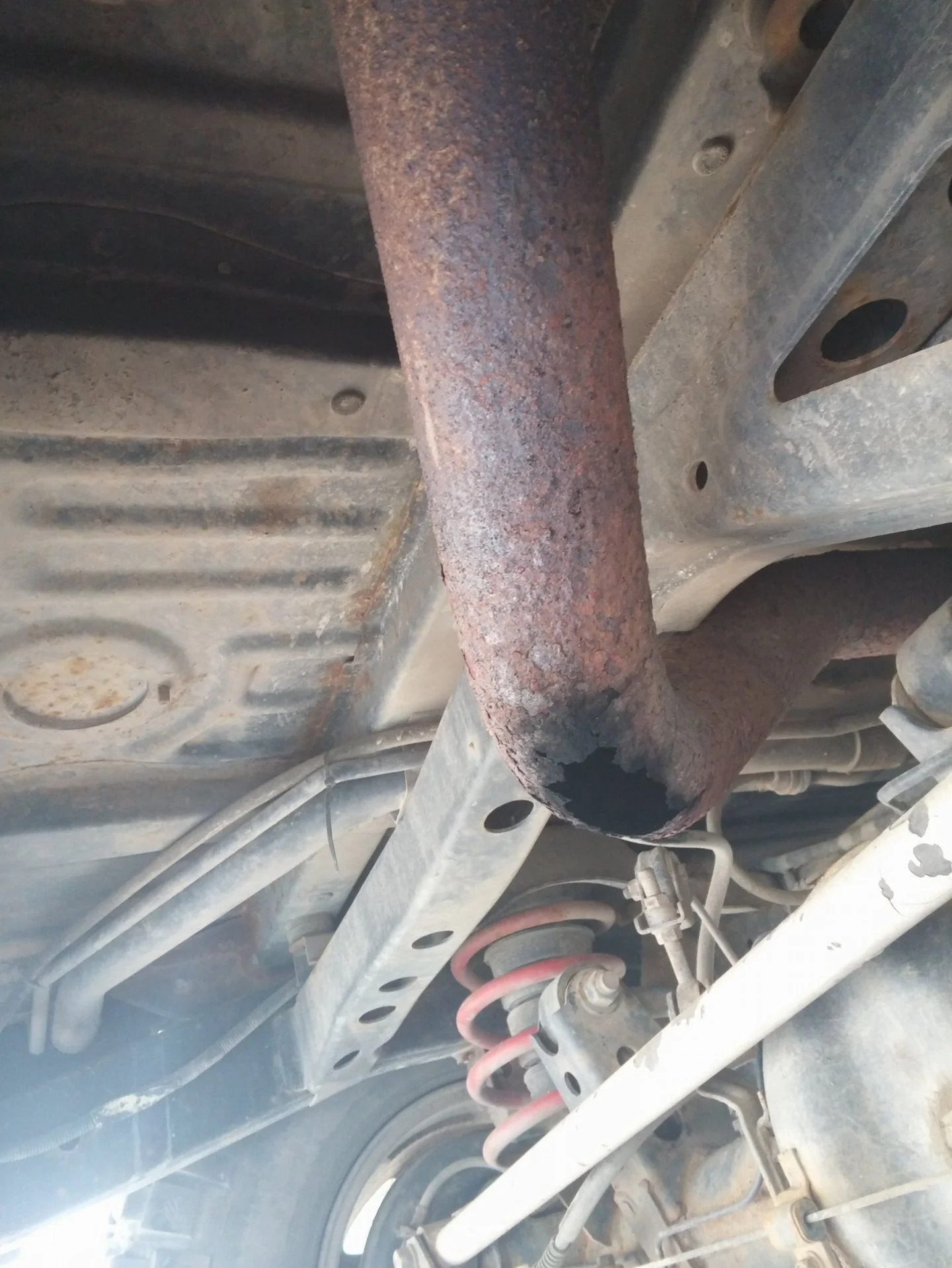

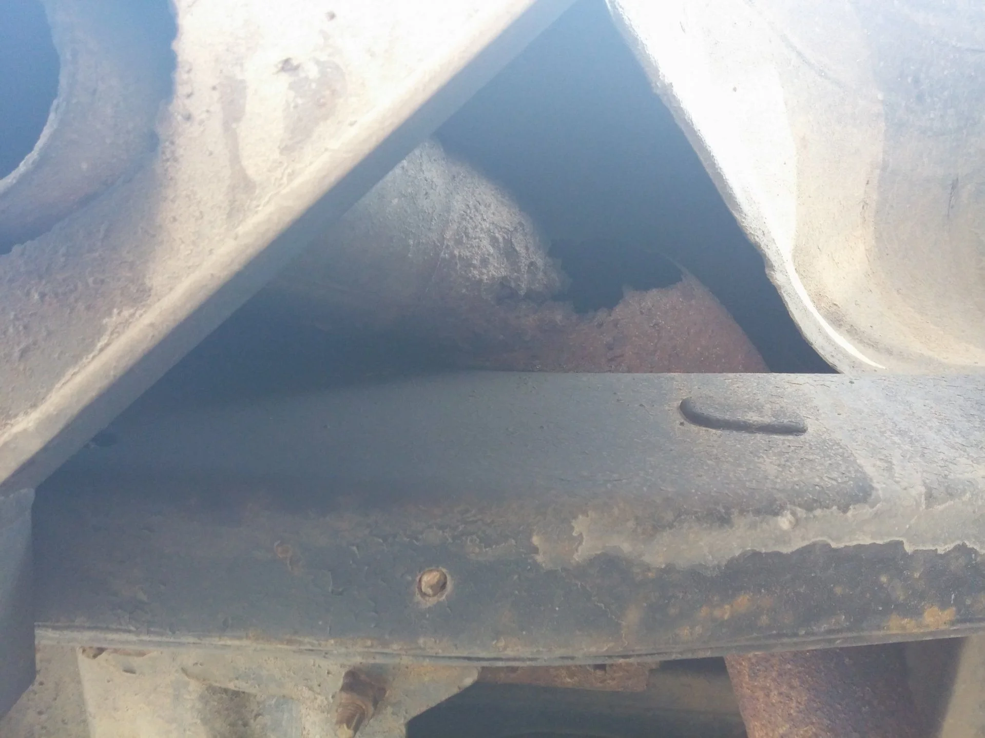

And an update. I was crawling around underneath the other day to look at some bolt locations and noticed the back half of the exhaust had rotted out in two places. It's booked in next week at Carline to replace from the muffler back as the rest of the system looks decent still.
The one rotted area was expected, as it's the lowest point on the whole system so any condensation gathers there. The other hole is up just past a top bend just before it exits into the bumper, kind of a weird place I think to have rotted.
you are getting seam rot which is more serious
This is why I won't do exhausts in anything but stainless. The steel stuff just doesn't last. And really the cost of doing full 304 stainless isn't really that much greater than steel.

Long term update! @Cruisin' replaced the end pipe awhile ago (somewhere after Aug '17) and eliminated the up and over with a more traditional exit behind the rear wheel, thereby eliminating that one low point the system had. Been going strong ever since!

and my Ateb steel exhaust is still ok too, though I had to replace the flex piece in my front wheel well a few years ago. Very satisfied, no sign of rust through at all...yet...

Maybe it depends on what kind of exposure it gets, but I cut my ATEB exhaust out about 4 years ago. I probably had it for about 6 years, but put lots of kms on it and a fair amount of winter highway driving. It had lots of pin holes at weld locations and the steel was noticeably thinner at the two locations I cut (just forward of the rear axle, and just before it went up to the turbo). I'm not complaining about it, I'm just saying the condition might not be as good as you think if you start to look at it closer.

In hind sight, I wish I had taken that exhaust to a shop and had someone replicate it in stainless steel.

yeah im sure you're right, I suspect after thrashing the truck hard this summer a major issue would have reared its ugly head! I think I will just not look at it too closely...
Mines still going strong, but as @MonsterCruiser mentioned, I've never looked too closely at it. For anyone else interested in a full stainless system such as this, CLinton Wong is new selling these as a kit from his shop in Burnaby for $2500.
