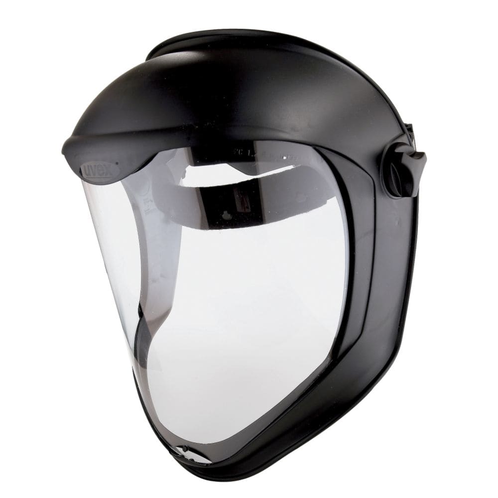

This was the second time in 3 years that I have had rust removed from my eye. First time costed $15 (copay), I got lucky at the St Maries Urgent care up in Galena when there just happened to be an eye doctor doing rounds at the right moment. Second time costed about 10 times that much..
Anyways, this just arrived for me. Worth every penny. (~$40 Uvex face shield, from amazon)
