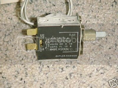

3. a AC temperature control thermostat, mine came from ebay and was called "1968 Galaxie NOS AC Temp Control Thermostat " The temp probe from this sticks into the evaporator coil, from the info I could find it goes about 1.5inches from the top and side. The rest of the switch remains outside the evaporator box and gets mounted where its convenient, I mounted mine above it. from there it goes to...

here's a few pics:
http://i947.photobucket.com/albums/...ioning/thermostatswitchfrom68FordGalaxie2.jpg
http://i947.photobucket.com/albums/...ioning/thermostatswitchfrom68FordGalaxie1.jpg
I'll wire to each of the brass terminals in the second pic. This keeps the evaporator from freezing solid. The small loop of metal is a capillary tube that inserts into the fins of the evaporator to sense the temperature, and cut power to the AC compressor clutch if the evaporator gets too cold.
