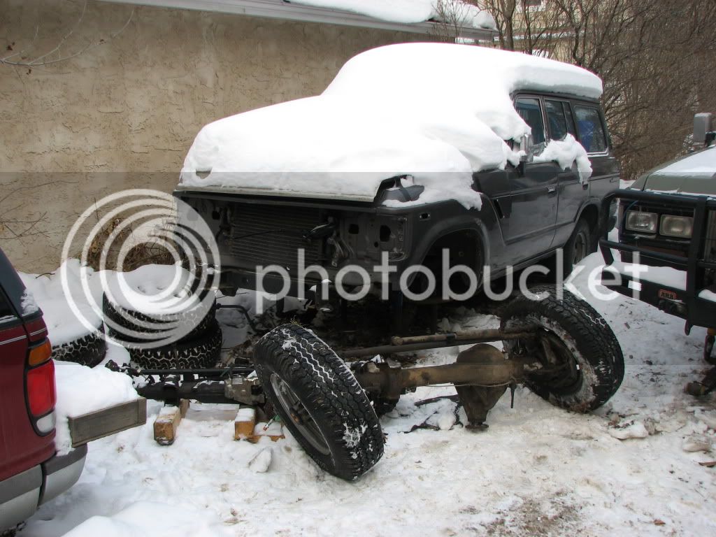

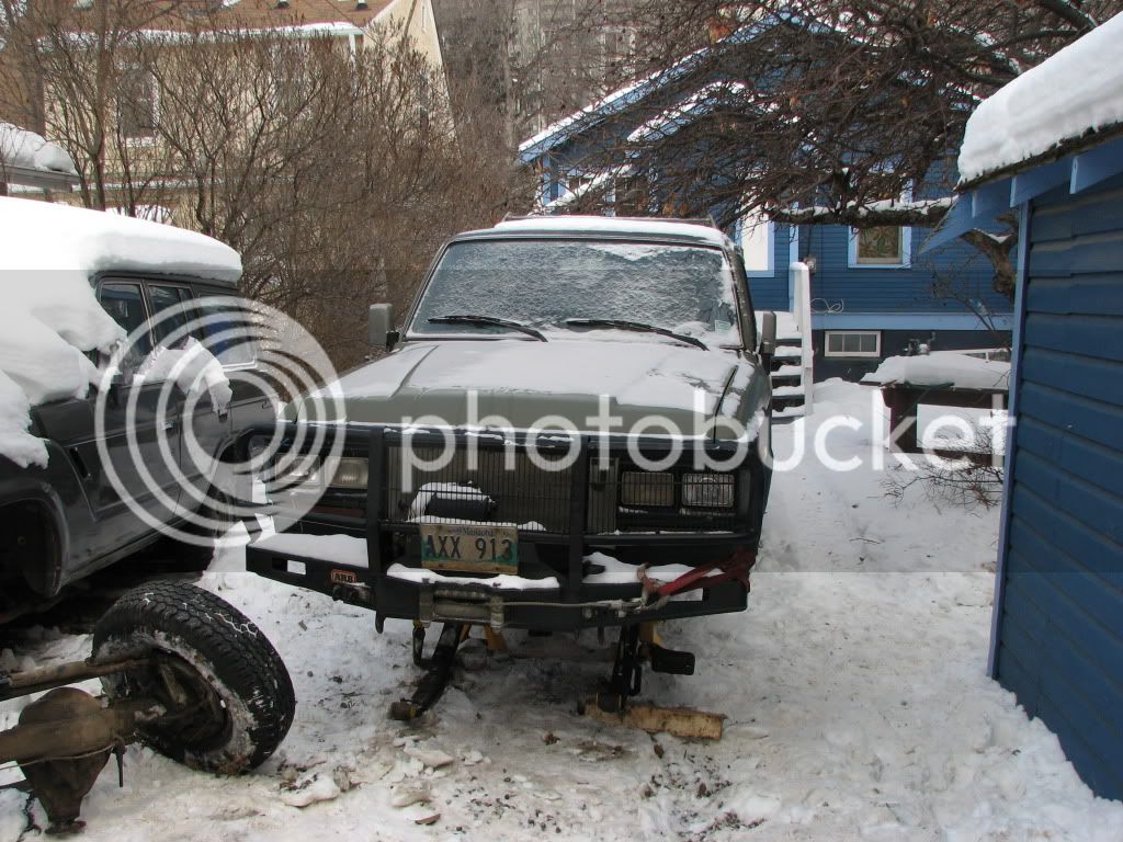

As with anything done outside in February on a Canadian truck, (i.e. corroded) taking a bit longer than originally anticipated..... But got everything torn apart yesterday, hopefully will have the truck back on the road tonight, wired up or not.

Yup, that's the future truck from Dan. The axle was pulled off of it to work through in the garage, it'll get the axle from under Wobble so it's mobile when moving time comes. It sure is nice having it right there to "liberate" parts from. I had to strip the brake line to the front axle back further than I would have liked due to seized joints.....

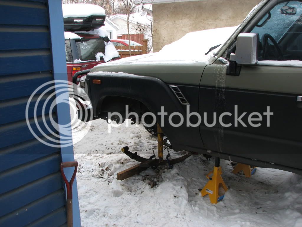

The axle is resting in place on the springs now, with new castor shims under it. After grabbing some lunch I'll head out and start bolting everything up again.
All bolted up, just need to borrow a roommate to bleed the brakes tomorrow, and splice the harness to the locker. :grinpimp:
Wiring is spliced in and it works :)
