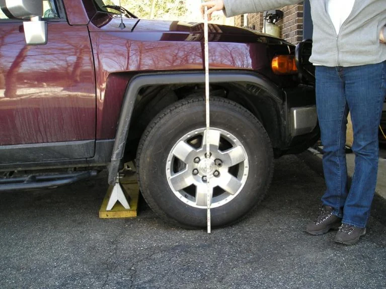

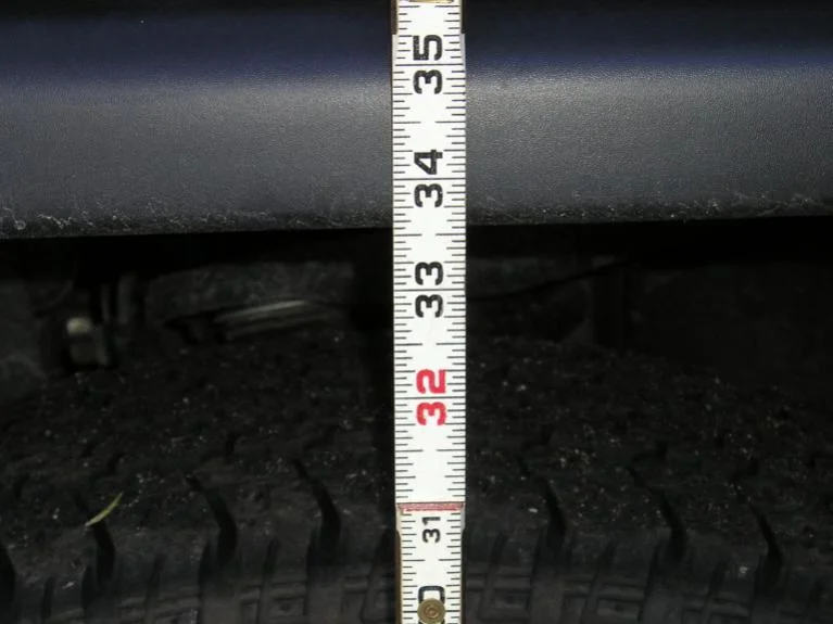

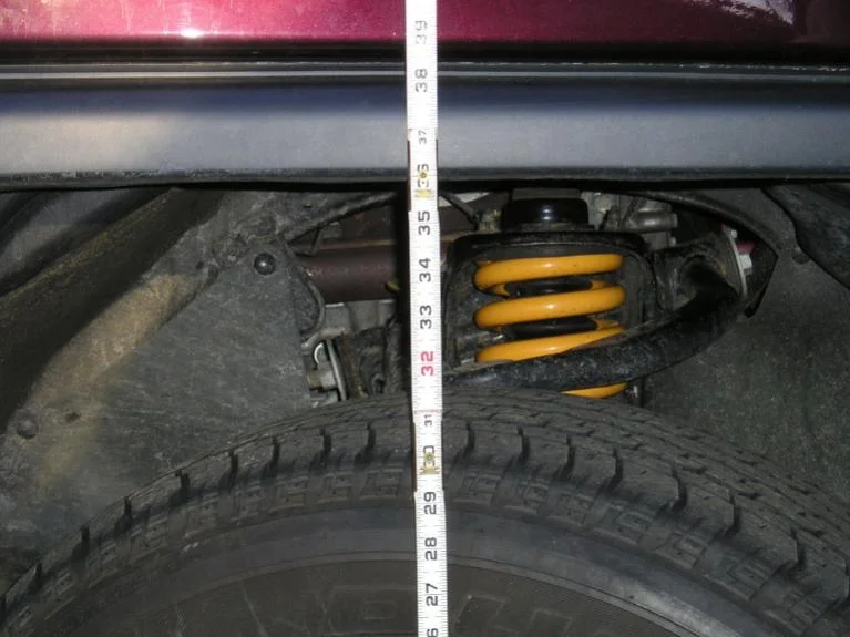

IRONMAN Install & Alignment DONE.
FJ Drives GREAT, Way Better than Stock!
More Confident on curves at speed, less dip when Braking.
Enjoy sitting Higher.
Time for Bigger Rubber & Wheeling at Rauch Creek April 2-4.
More Later
Can ONLY Load 3 pcs Before & After Measure.

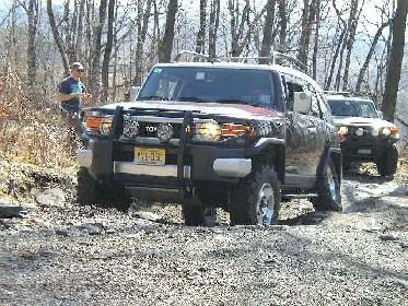

Got to Rauch Creek & ran 34" SS w/No Problems, & No Body Chop.
Day 1 Ran Green Trails & Felt like a The KING, Ironman Lift & SS just ATE Trails UP.
Day 2 Ran Blues, again w/ No Problems.
SSwampers saved me from getting Winched out,of muck.
Ironman Lift IS BEST MOD TO DATE.

A couple of the guys from GCLC are also using Ironman Lifts, & are Very Happy with Better
On & Offroad control.
See ya at CoalMine, or maybe in 2 weeks at NH Springfling.

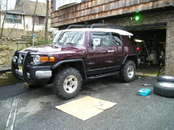

What size swamper's are you running?
How are they on the highway?
Noise level?
I've got 285/70/17's but want to move up to 34's.
Looking for something a bit quieter than my Wrangle MT's. I know a MT will not be quiet just want a bit less noise.
LTB-08's 34x10.5x16!
SS are Trailered!
For OFFRD & To/from Hotel USE ONLY (8 miles)
Steering wheel vibration at 55 mph MAX. @ 15 psi.
NOT DAILY DRIVEN! Run stock tires,
Noise level?
Others Passing me say there LOUD.
Inside back of my FJ Lined with 1/4" think Bed Liner Rubber with nubs for my 2 dogs.
So My Noise Level is low hum.Stock Radio OK!
