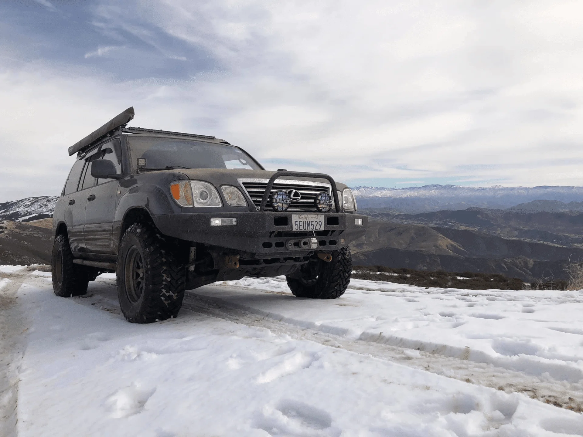

My apologies if this is repetitive. I have 2004 LX 470 and am looking for a all around functional lift height. Is the picture of your LX a 2" lift? If so, what tire size did you go with? What bumper is shown in the picture? Did you have to do anything with the computer and codes due to removing the AHC?
Thanks in advance for your help.
