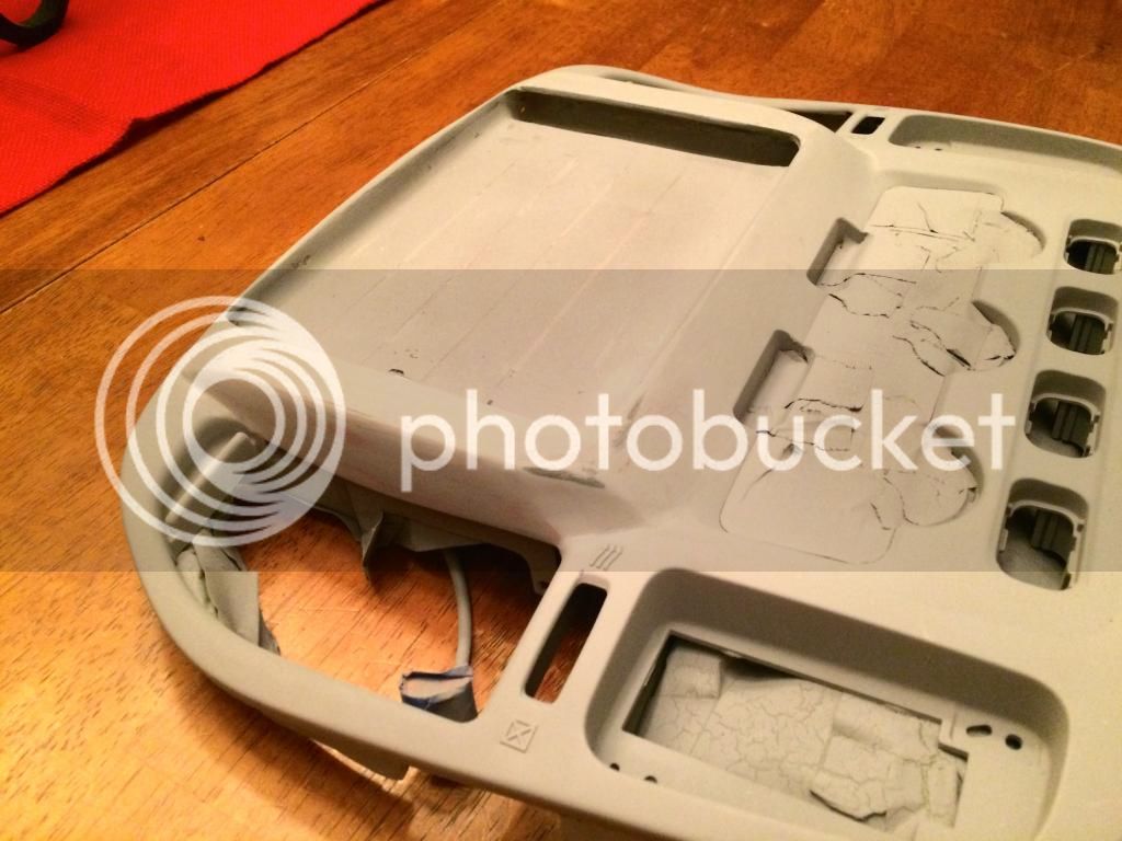

Here is a 100 series dash I picked up last week.
Cut out the area that needed to go.
The fit horizontally is great, tons of room, way better than the 80 series which are super tight. The vertical area on the other hand is super tight. I had to trim the mount as much as possible. It literally cannot get any smaller.
Mount sitting in place before "welding" it in.
Most of the ABS bits "welded" in.
The antenna button, time/temp display and clock setting buttons are going away, they will be covered by the new dash. The display will actually still be there, it's built into the circuit board and not worth trying to remove.
Next step is to take a file to it and knock down the rough spots, tape up and add epoxy from the back side to get everything rock solid and then body filler and sanding. Lots and lots of body filler and sanding... followed by primer and paint.

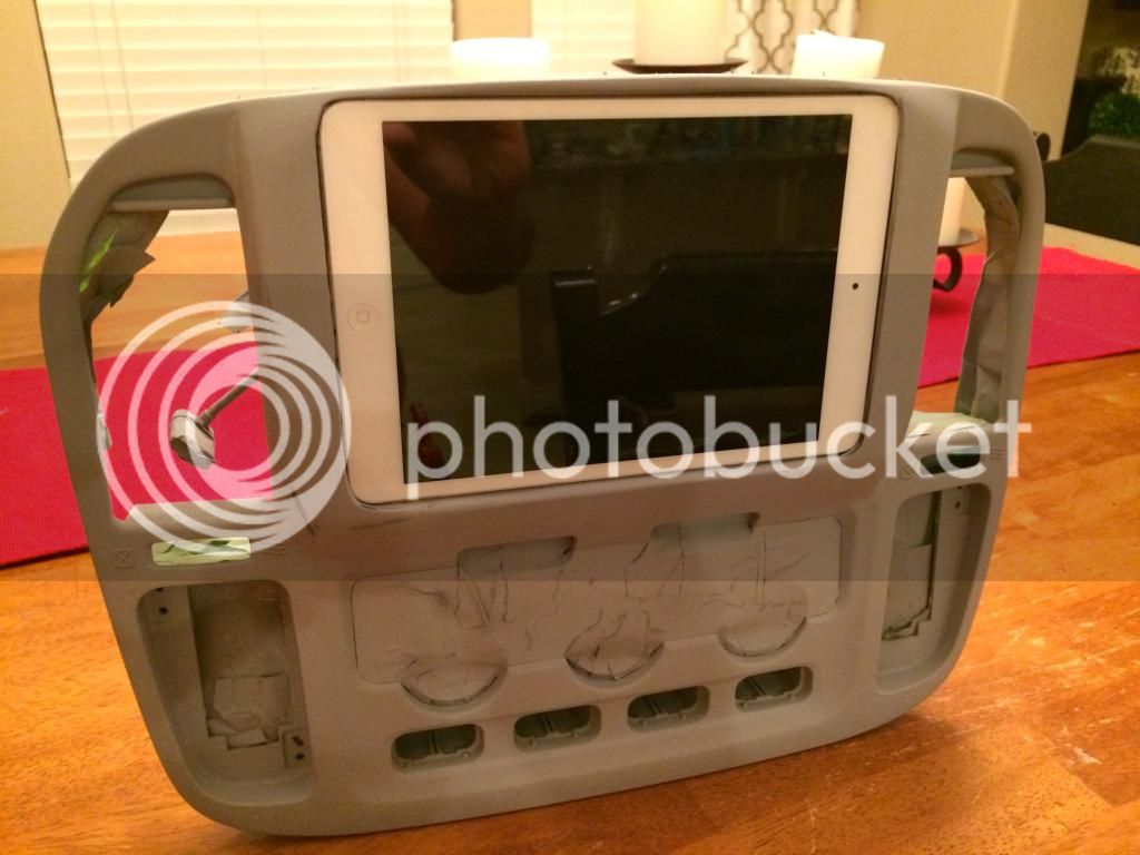

My wife donated a kidney to her little sister last week so I haven't had much time to work in this. Took 2 weeks off and thought I'd have free time to work on stuff but it turns out mom duties are very time consuming with 3 kids... :confused: Anyway, here is the latest as of middle of last week.
Needs a little more filler and sanding then hope to have it primed later this week. Followed by some fine tuning stuff before flat black finish.

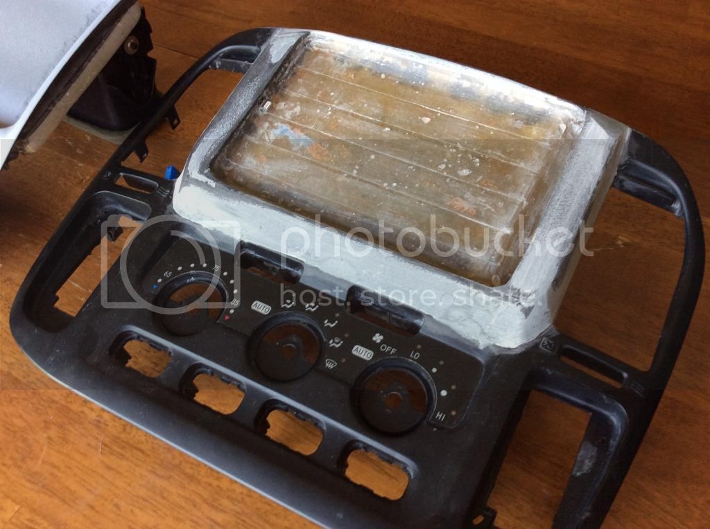

Finally found time to work on this one. Getting close. Hope to have it painted by Wednesday. Just a few small spots that still need work...
