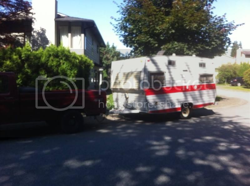

So I have a 15' 1971 scamper trailer, its an oldie but a goodie. Its mostly original - Except for New tires, bearings races seals. Converted the manual water system, to on demand 12V and a porcelain toilet - Keep's the ladies happy ! we basically use it to sleep in cook outside. Have full hook ups for "Glamping " ,but want to do an extended week or so trip in the chilcotin this summer.
