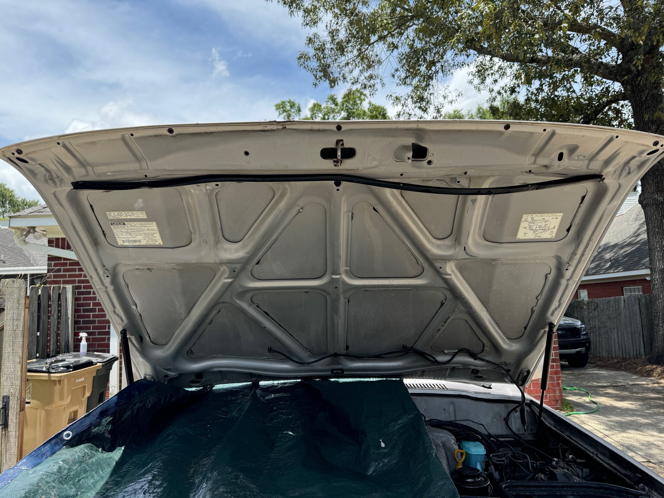

First thing I did was remove the oil-soaked hood insulation (fire hazard) and thoroughly cleaned the oil from the hood. After the deep-cleaning I noticed the dents a bit more. New hood on the way to my local Lexus dealership (July 20% sale and free delivery to store) as well some other odds and ends. Had the NSS code that seems to be popular until I refurbished the module earlier today. The plastic arm had snapped off so the copper contacts weren't moving. Glued it back together. Sprayed out the old grease and then applied some new. Now I have working reverse lights, gear selector (cliche' dead 'D' bulb, though), and working cruise control again. Got some new Toyota bushings coming from Japan for the front-end. New steering damper OTW as well. Plan on redoing the knuckles in the coming weeks. New AC parts on the way (VERY hot with this high humidity. Lots of debris in the lines. I'll flush all the lines and throw in the new parts.) Also replaced the steering wheel with a used wheel from an LS400. Perfect fit with my existing airbag.

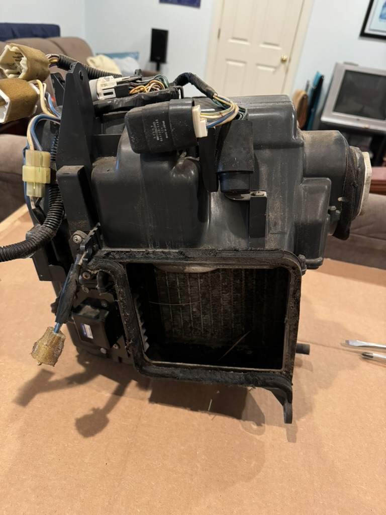

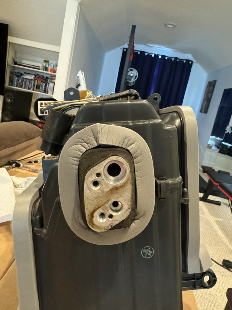

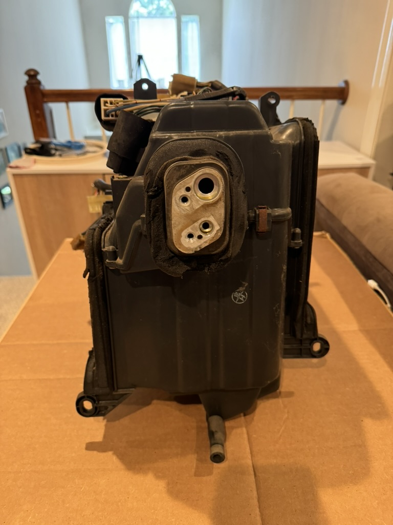

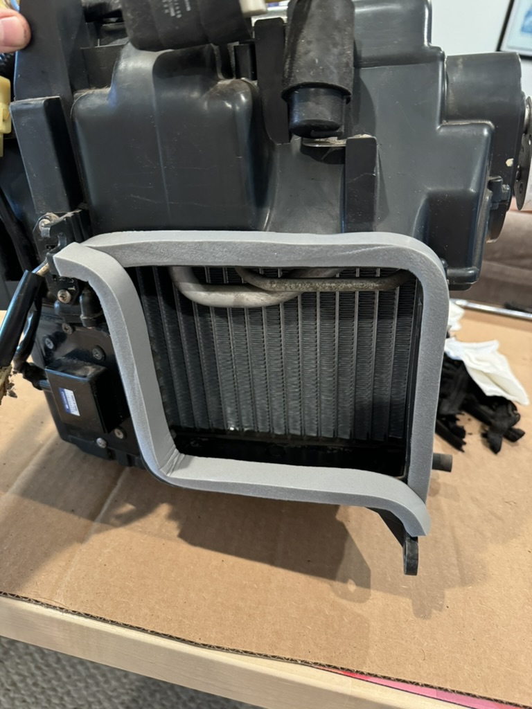

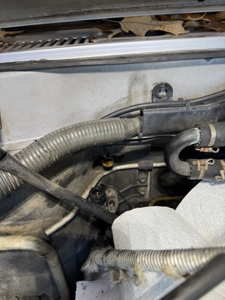

I’ve done a lot to the LX since acquiring it. Redid the front end bushings. Sway bar bushing was completely gone on the driver side - that clunk is now gone. Drivability is greatly improved with the new radius arm bushings. New front tires to match the rears. AC works great since I gutted and replaced everything - the drier had disintegrated and the little beads were clogging the expansion valve. Got the old beads out and cleared the hard lines. Recharged the system. Good as new.

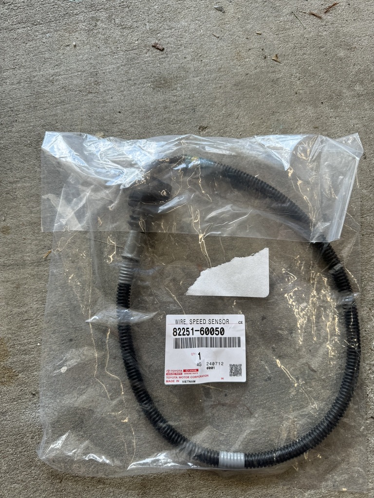

New harness for the speed sensor at the transfer case. Old one had a wire nut holding everything together haha.

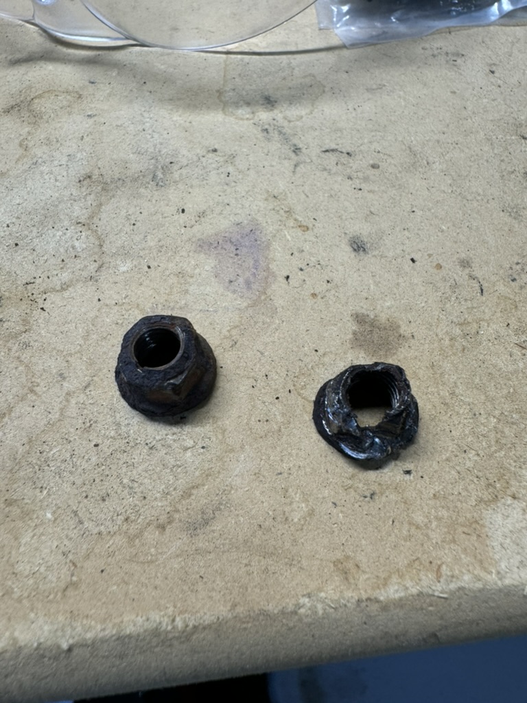

Replaced the Oxygen sensor at the cat with a brand new OEM. Replaced the nuts as well. Runs closed-loop now. Old nuts were trashed.

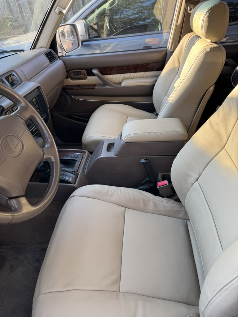

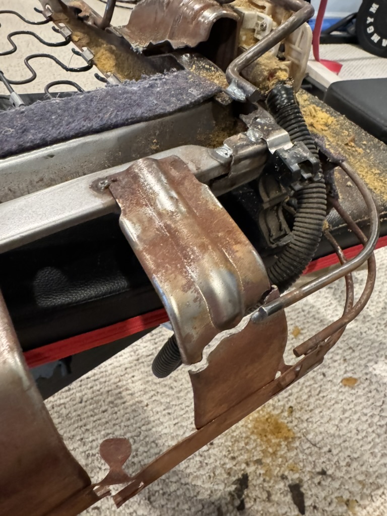

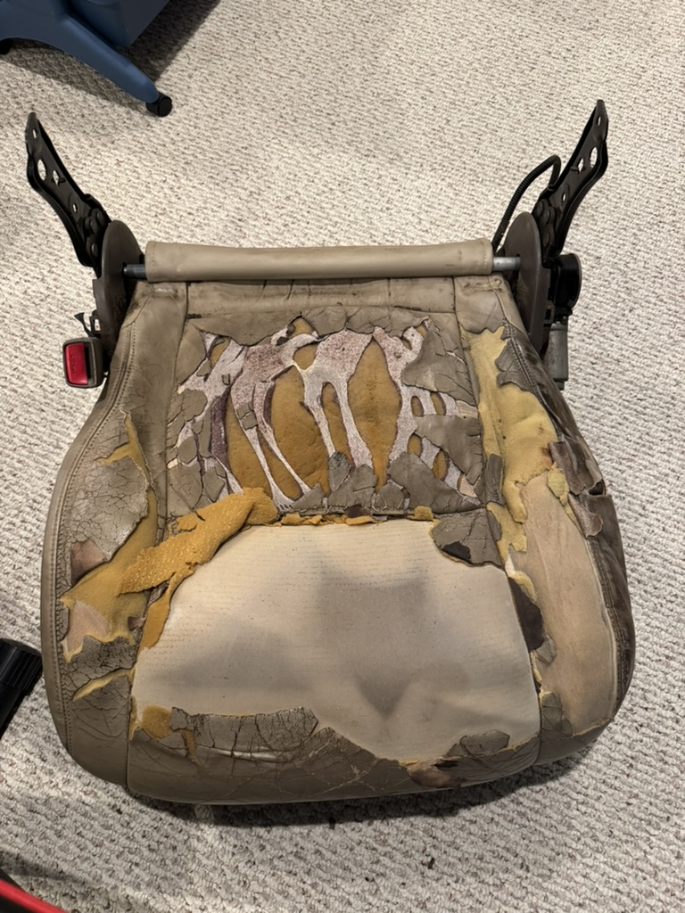

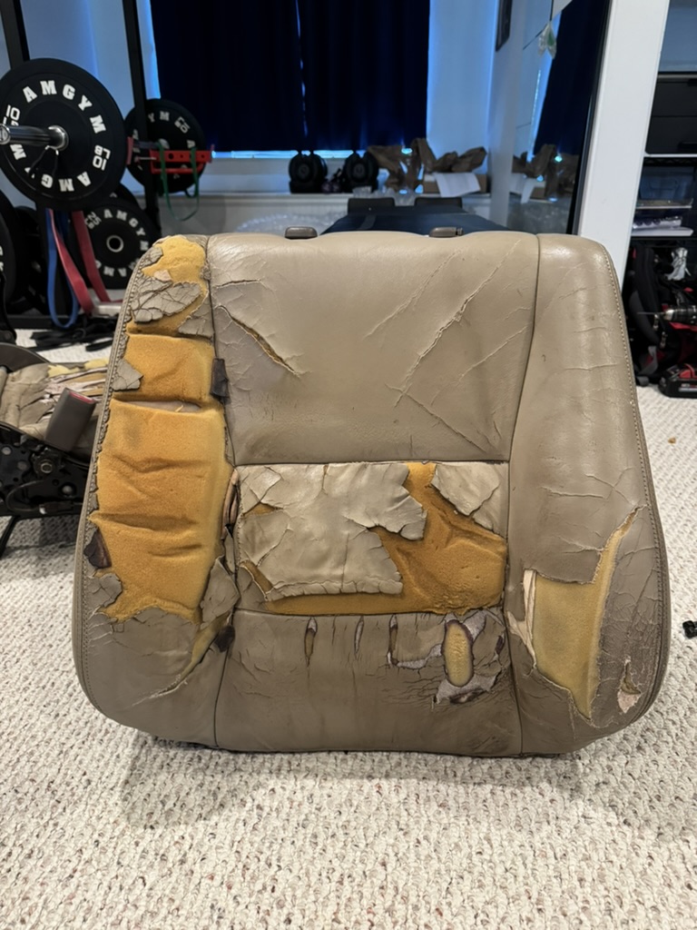

Redid the front seats. Replaced the gears and the passenger side motor. The bottom seat frame was fractured on the driver side - welded it back together and redid the foam. Much more comfortable and adjustable now.
[Seat pics]

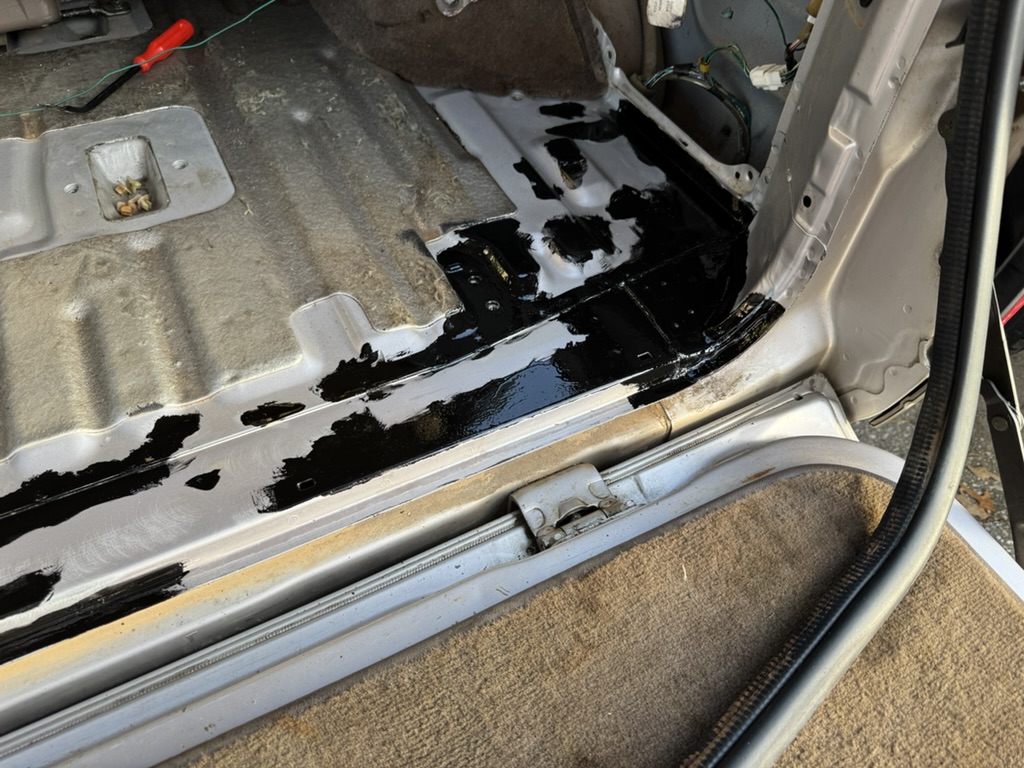

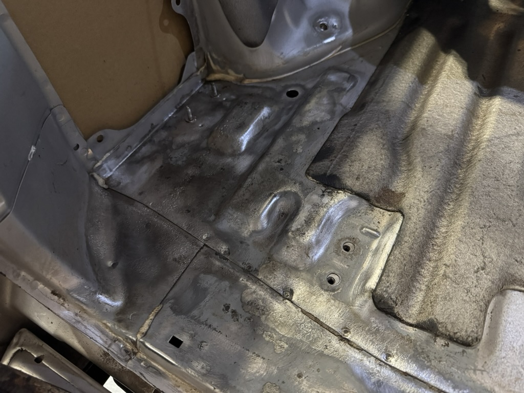

Discovered wet rear carpets after driving through some heavy rain. The floor pan drain plugs (basically stickers) had come loose after so many years. Lifted the carpet and discovered a bit of rust. Forgot to take a pic of that. Stripped it down with a wire wheel. Cleaned the area and covered with POR-15. Dried out the rear quarter panels and replaced the partially peeling stickers with new rubber plugs. Went ahead and removed the 3rd row seats as well and put them into storage.
[rust pics]

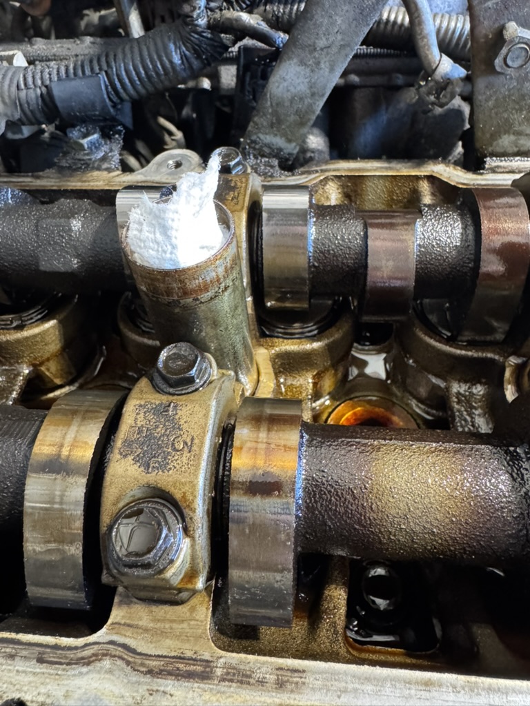

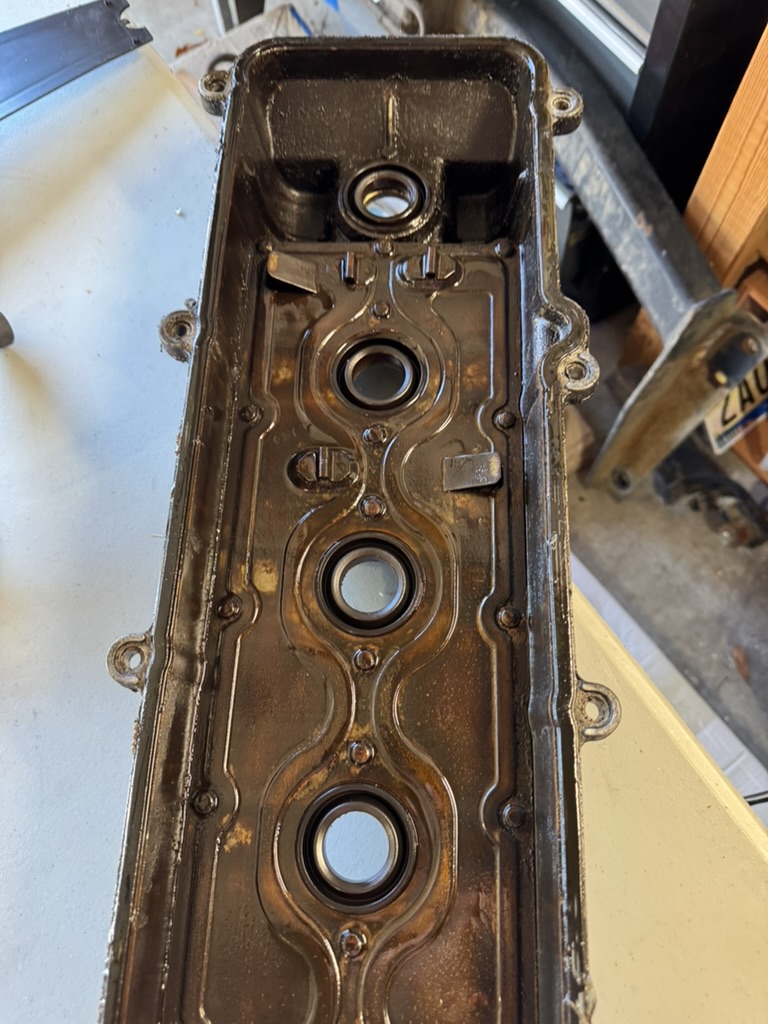

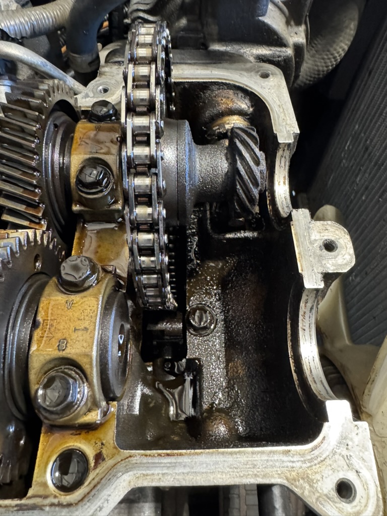

Pulled the valve cover off to replace the gaskets and to inspect the cam shafts. Not too shabby for 505k on the odometer. All new gaskets and valve cover bolts. Oil leaking has stopped (from the valve cover at least haha). Replaced some vacuum lines with OEM Toyota lines. Replaced the T and hoses going to the rear heater with OEM parts.

Nice work on the seats.
I may have missed it...
Where did you get the covers?
Any advice/lessons learned?
I used the LSeat covers. Took about two weeks to ship. I’m sure one day they will show some wear, but as you can see from the photos it’s a hell of a lot better. The price was right.
Definitely get hog ring pliers with a spring to make life easier. Longer handles will help too. The job is not too hard, just tedious. Did the passenger seat first to practice for the driver side. Also, make sure to warm the covers a bit when stretching them back onto the seats. Much easier.
I have never done any type of upholstery work and I wouldn’t hesitate to try it again based on this experience.
Since your rear floors were wet, you need to address the sunroof rear drains. That's a classic symptom of it leaking there and running down the C pillars.
Thanks for the advice. Already checked while I had everything pulled apart. Both draining beautifully in the rear. Fronts also good. Headliner dry as a bone
Edit: also didn’t notice any rusting or evidence of water intrusion in the C pillar. Should be good, no?

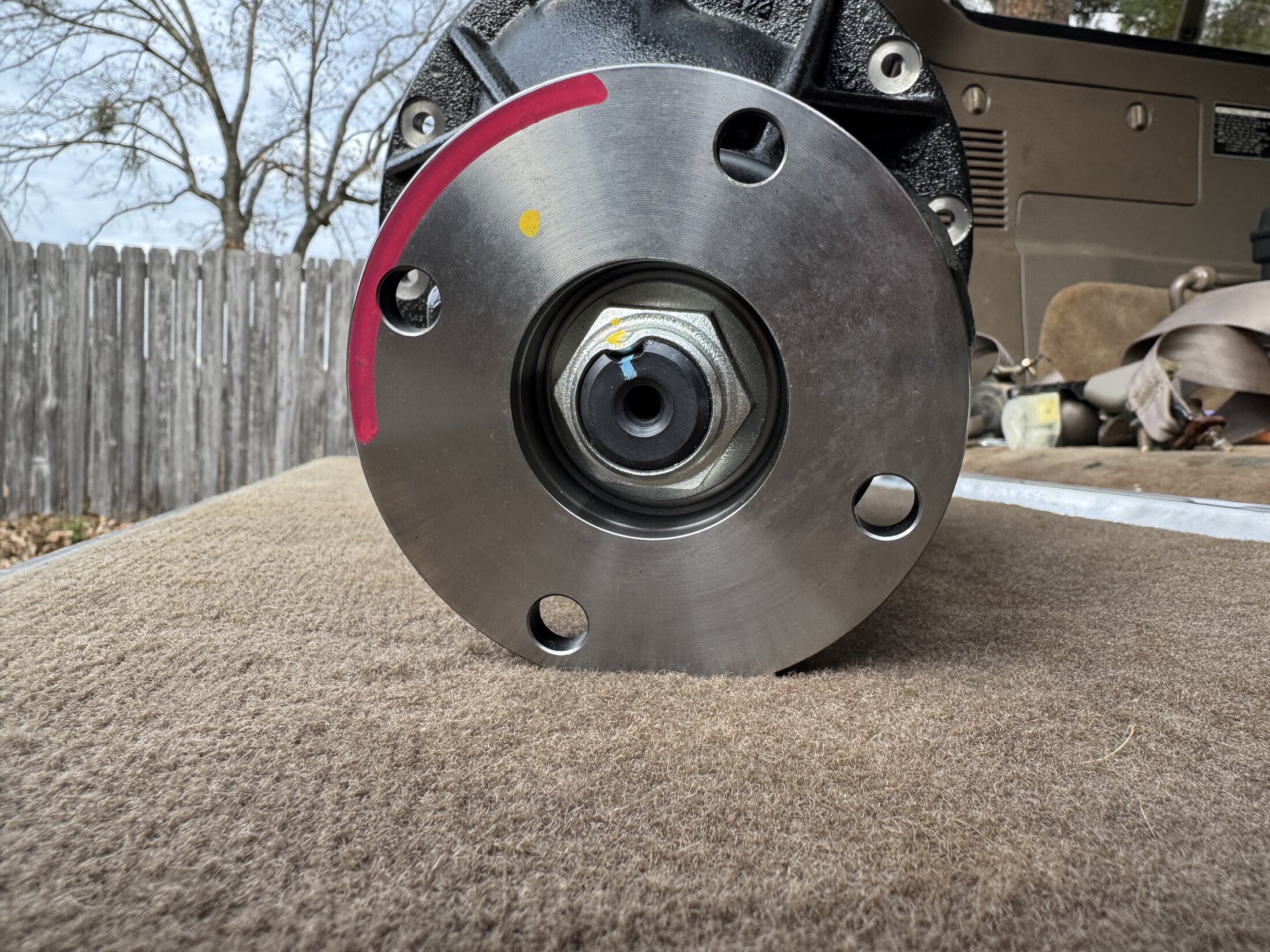

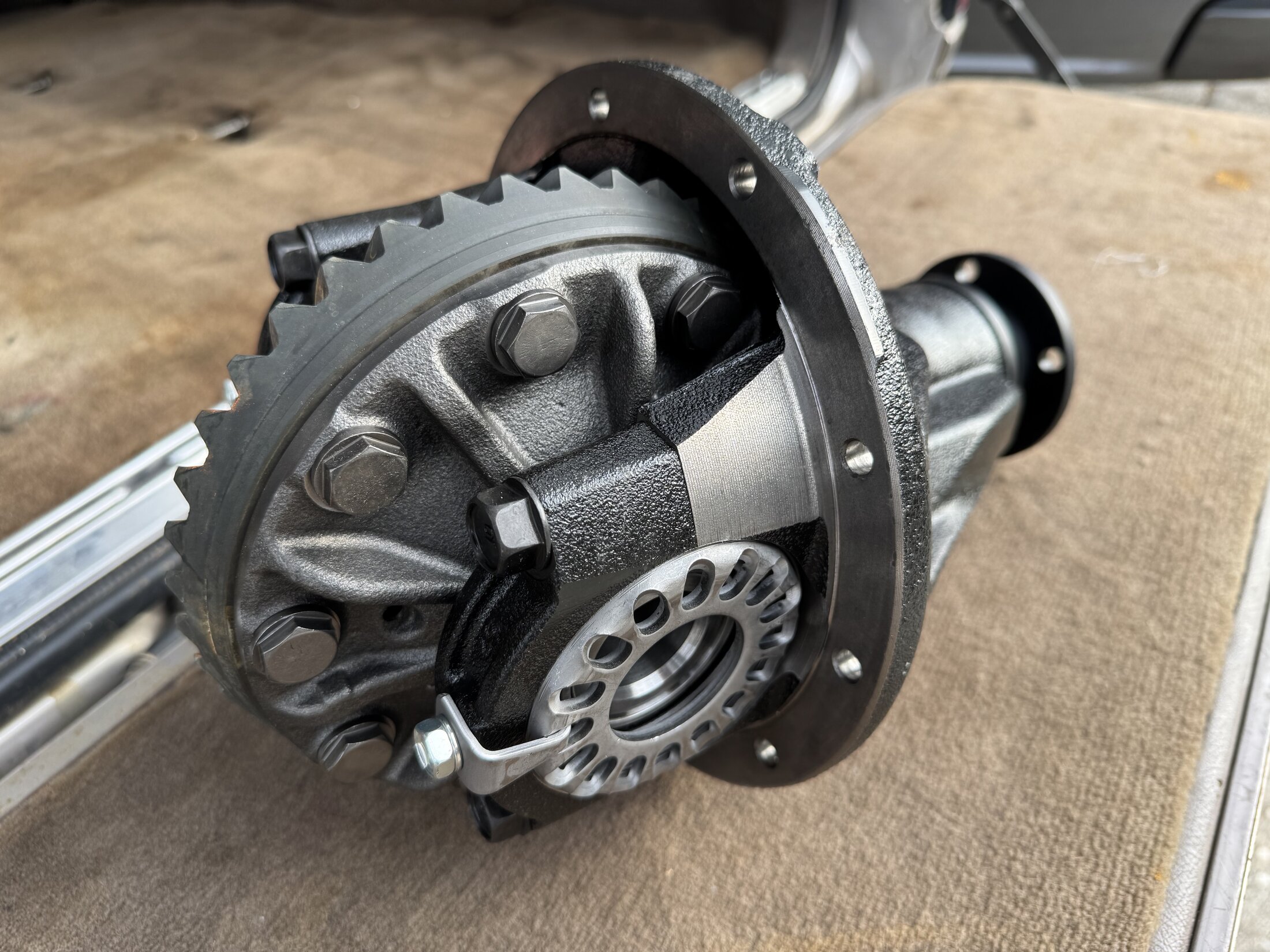

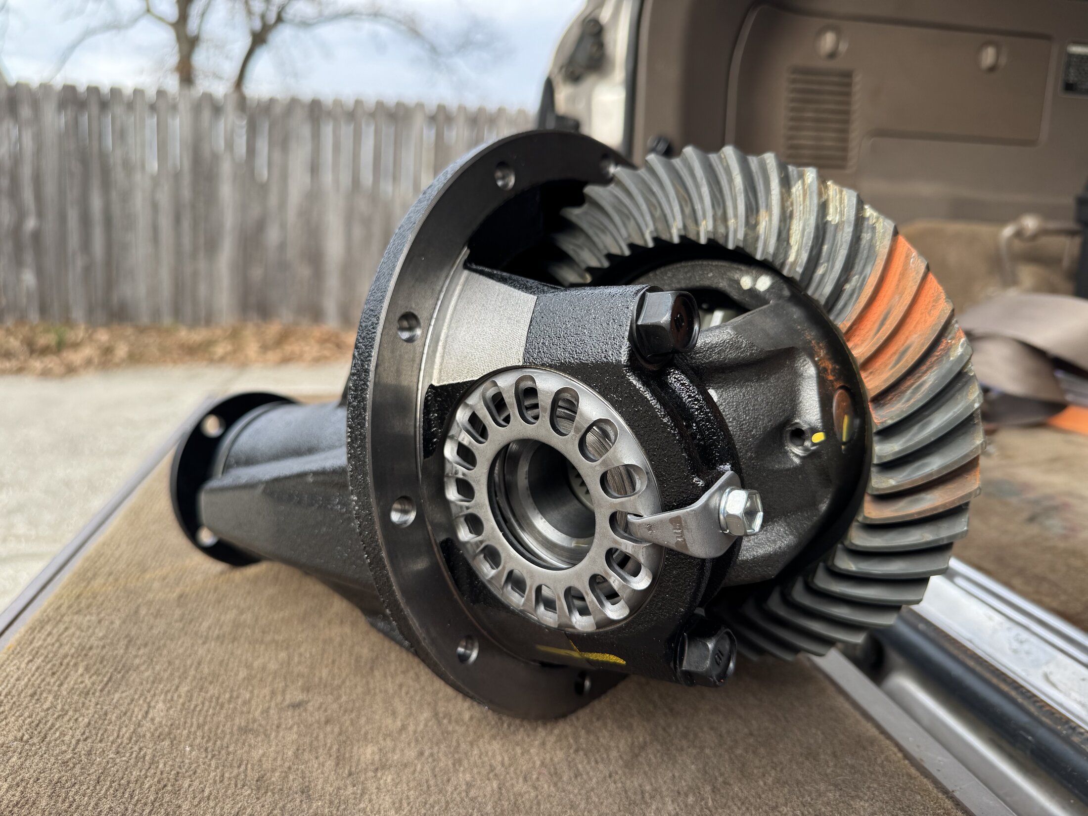

Long time between updates. I actually completed the knuckle rebuild and front 3rd member replacement in late January and early February. All went well, but the mud/oil/grease combo definitely slowed things down. Took my time to inspect and clean everything as I went. Replaced the front discs since I had everything apart. I wanted to take more pics, but I was pressed for time (I was taking up the garage and my wife wanted it back). My gloved hands were absolutely covered in filth, so taking them off, washing-up, and taking pics would have tripled the rebuild time.
The result: complete eradication of the front end whine I was hearing. No more leaky knuckles. Tighter steering. No wandering. Very pleased.
