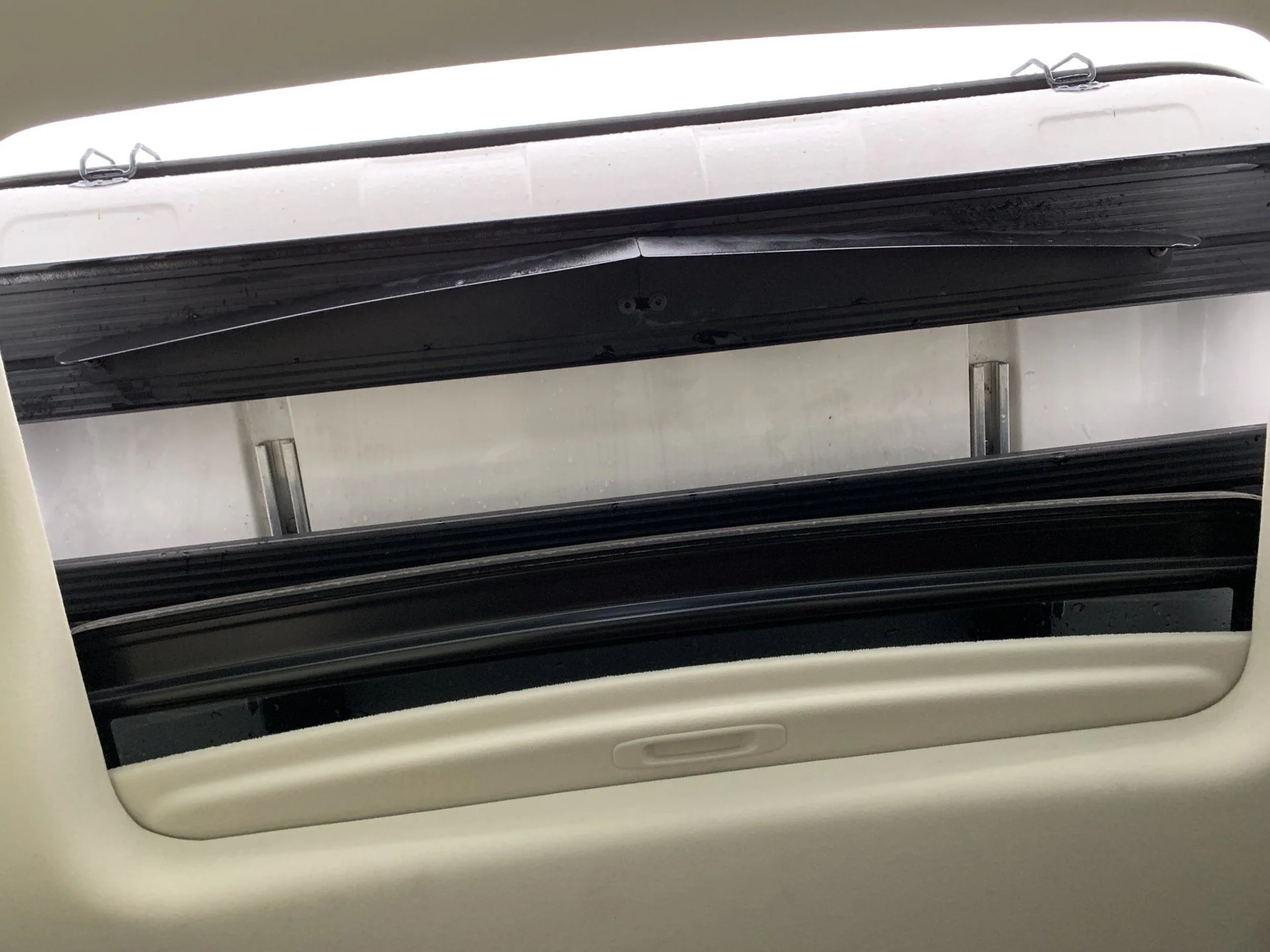

Thank you, that was an extremely helpful reply. If you don't mind, next time you're in the truck (or if you can visualize it) can you make a guestimate to how much "open air" would be over the sunroof if those two slats were removed? 50% of the sunroof? Less? More
No rush, I'm months from buying; just curious
The slat with the fairing on it has to say as part of the rack, the one behind it can be removed. Looks like it’d take about 25-35% of the sunroof.
One thing to note is that the faring does direct alot of the air down through the sunroof when it's open.
Sorry for the lousy picture, it's suprisingly hard to get a good shot of the whole sunroof with a cellphone camera.
The picture is great, thanks! It took me an embarrassingly long time to figure out what I was looking at, but that's because I'm an idiot. That photo conveys what I wanted to know.
