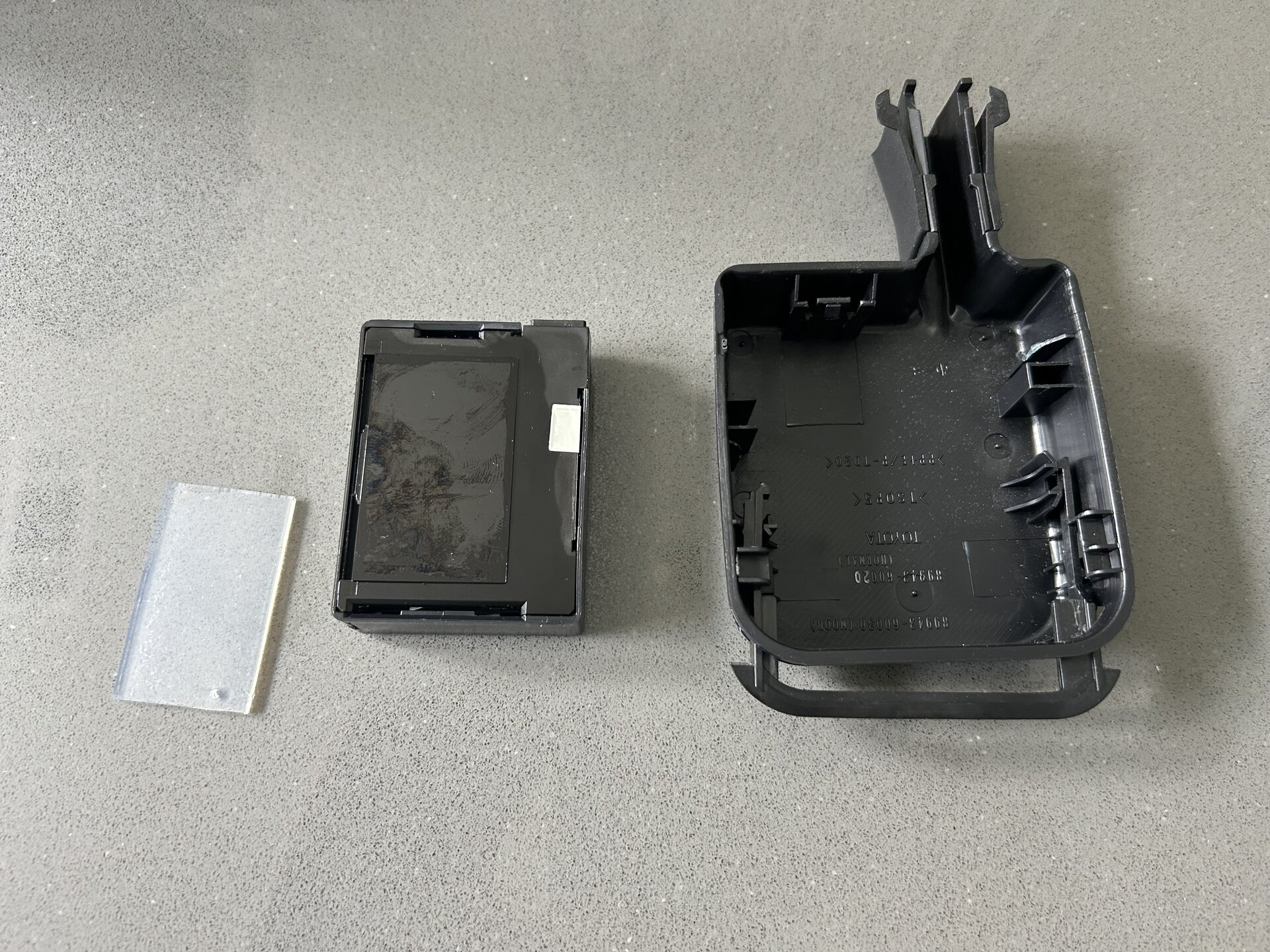

My question was about a small rectanglular gel pad "thingy". Seems to be a cushion between the unit and windshield.
I do need the tape, thx.
Yeah, I thought I explained that, sorry...it is a adhesive strip to attach the unit to the windshield as well as allow the sensor to "see" the rain within that box. This was a super easy DIY once you have that adhesive strip.
Think of it as a small sample size for the entire windscreen. The sensor will take the calculations of the frequency and size of the rain and use that for the wiper speed.
What's confusing me is that I also had residue of ahedsive on the perimeter of the unit. Safelite probably did that to reattach. Now I get it. Thanks for the help.

My lx wiper sensor looked a little different, or I was doing it wrong. I pulled the clip and the box+sensor fell. There were some metal brackets on the window that were holding it. I couldn't reach the plug well, so I had to pry 4 clips to remove the sensor from the housing. There was no push pin on the plug, so I just yanked it free. It doesn't seem to work though, just wipes once when I select the first wiper mode. I guess I'll try to get that tape and repair it.
Edit: it does work, just slower than I expected.
Between this thread and this thread (LX570 auto wipers - https://forum.ih8mud.com/threads/lx570-auto-wipers.1289033/#post-14526834), I was able to quickly diagnose this issue after getting oem glass replace. Hamfisted tech appears to have punctured my tape. I ordered a new one.
Question is, there appears to be a residue on the sensor itself and the glass where it attaches - is it safe to clean/sanitize these areas for proper adhesive with the new tape? Just don’t want to damage the sensor and have to buy a new one.

Yes. Definitely clean with alcohol.
Do you apply tape to sensor and then sensor to glass, or tape to glass then sensor to tape/glass? Haven’t received the new tape yet so curious how it looks.
