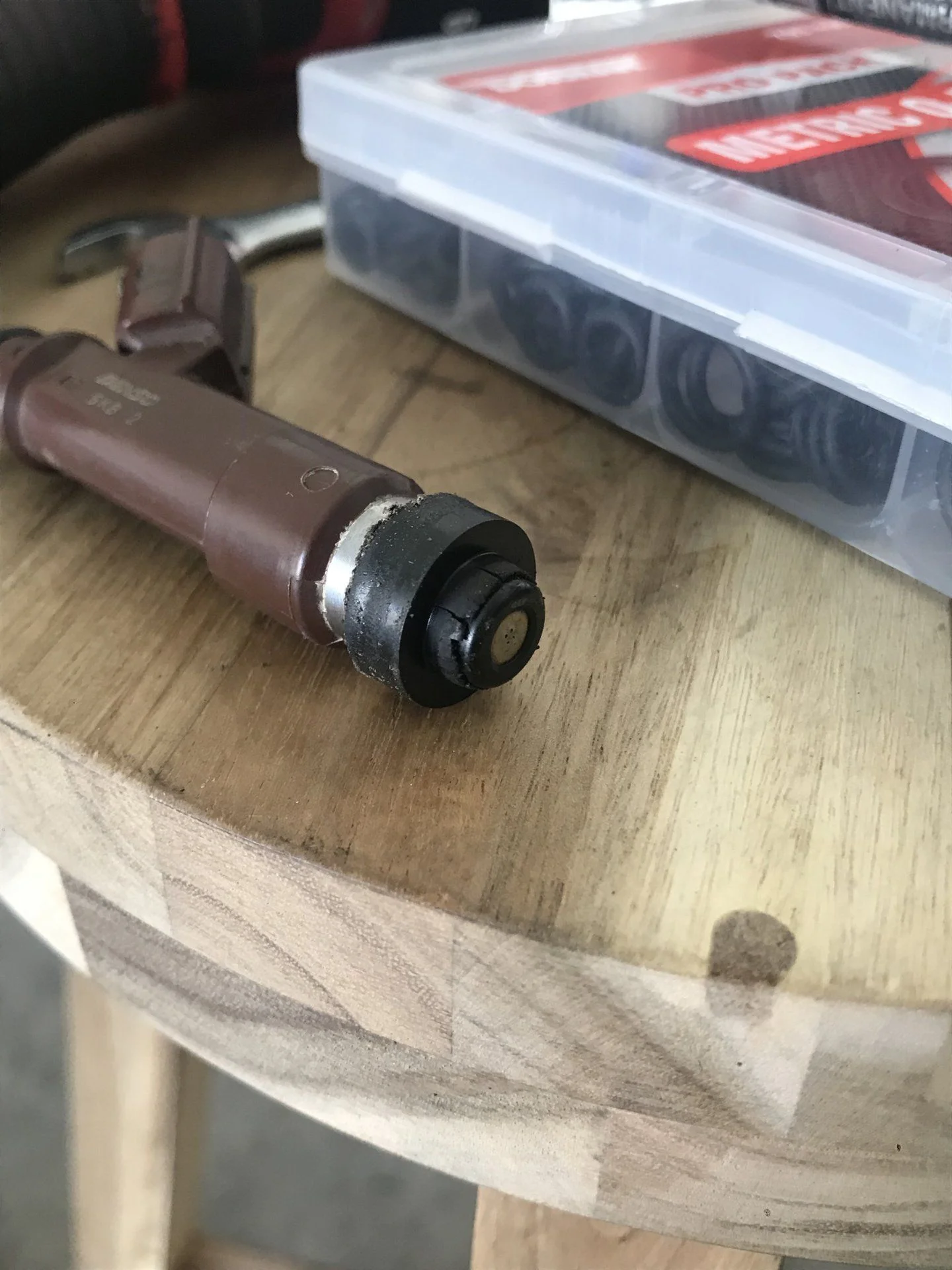

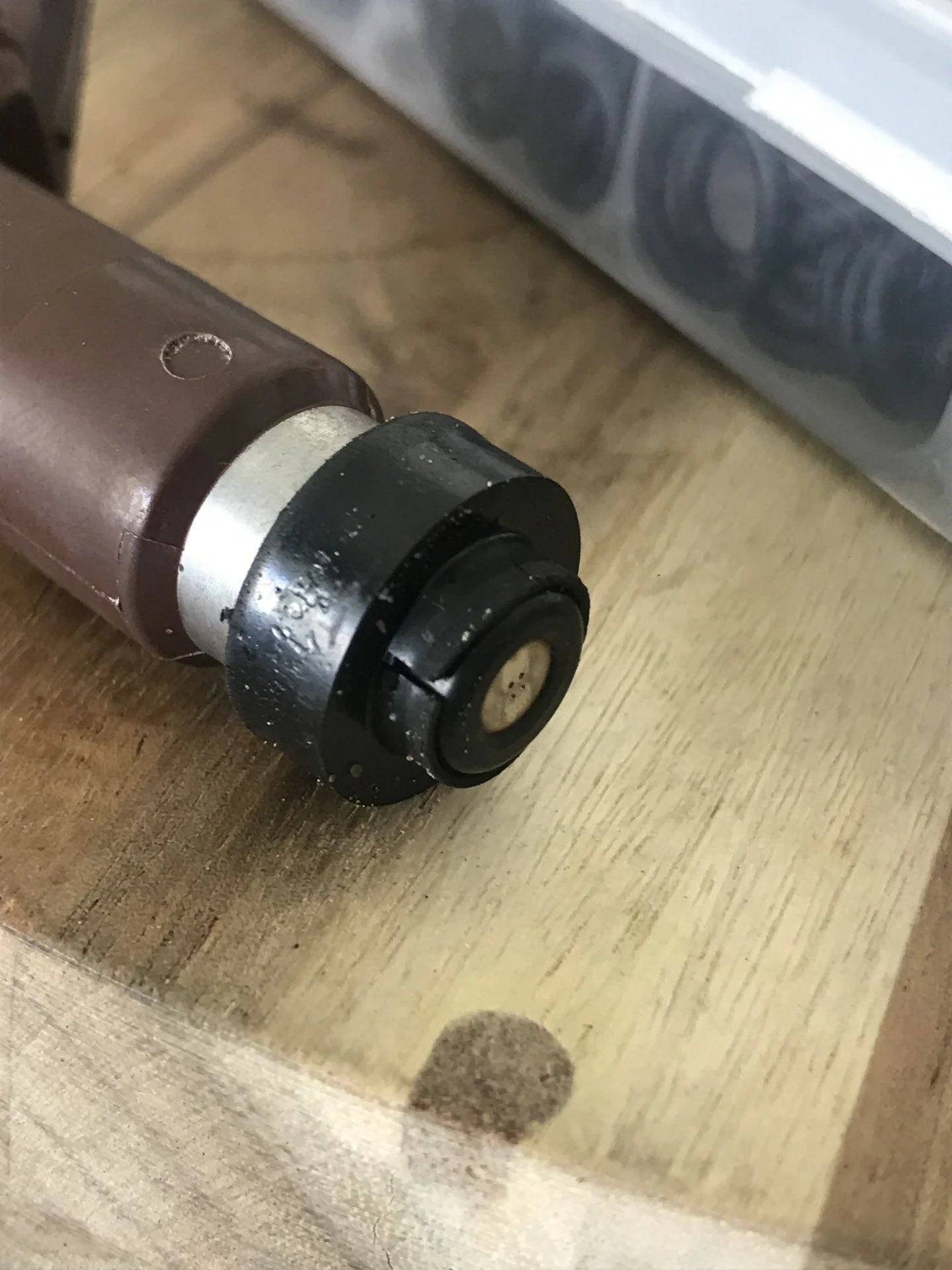

Try to check your fuel injector’s vibration insulator.. could be as simple as perfect seal. In this case it’s not.
@2001LC tagging you here, this is how it looked like.
