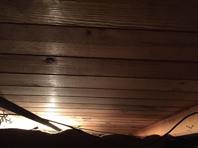

If you know you have a hardwood floor, it’s possible that there is a plank subfloor below that - instead of a plywood subfloor. I somewhat doubt that there is a 2x subfloor.
It is common in older houses to have your joists covered by diagonal sub flooring. Its not 2x4, closer to 1/2'' by 4. My house was built in 1950 and that's how it is setup. I actually have an area in the laundry room that requires a plaster repair where you can see a cross section of the sub flooring.

@gregnash that 1/2"x4" diagonally laid board is the sub flooring. Plywood was not mainstream when your house was built like it is now. I bet if you look in your attic you have 2x4 or 2x6 decking for your roof. Anyhow, back on topic, you will be drilling through 3/4'' oak, 1/2'' underlayment for a total of just over an inch in material. Assuming of course you miss your floor joist, which I would recommend.

Underside of floors.... And I think you are right @half k cruiser as there were a few spots that I could see between the planks and they looked to be maybe 1/2" or so thick.

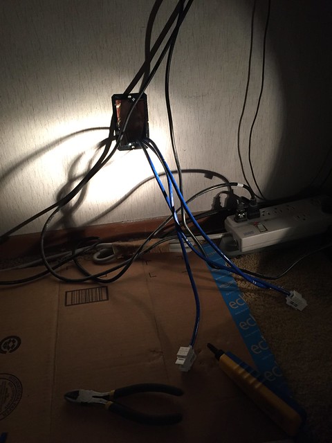

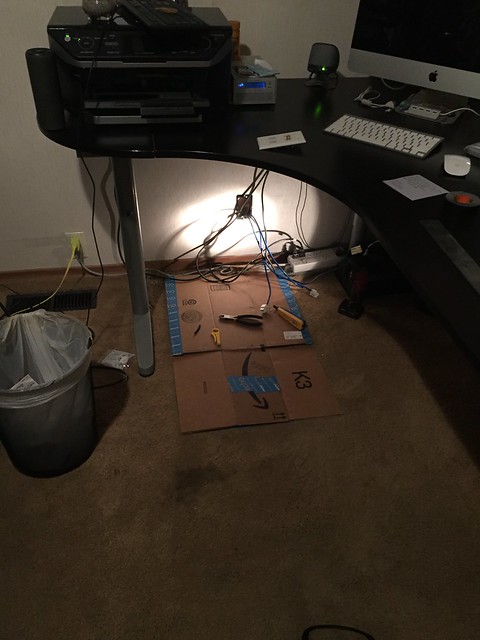

Office.... which is main patch panel at this point... 3 dedicated lines with a fourth pulled for possible expansion in the future.

Reward once lines were pulled and strung through to living room... Hard to remember to take pics along the way.
