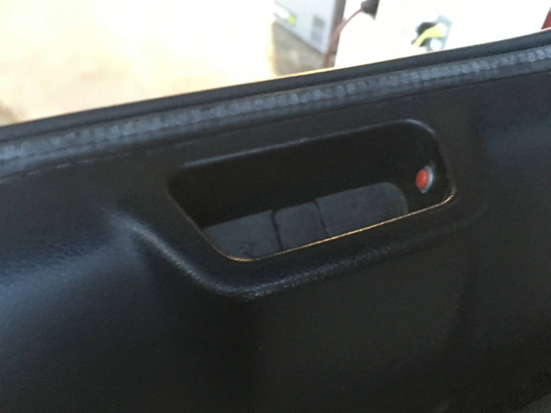

My new favorite mod, an interior button. I was originally planning on adding an interior release for the rear cargo door, but while I had everything taken apart I figured I could add a release for the glass. So with a spare button I had laying around and some wiring it's done. I placed it inside the door pull to prevent anything from accidentally hitting it while driving. Got to try it out this weekend and it worked great. I like it so much that I don't think I'm putting in a handle release anymore, it's easy enough to reach out and open it from the exterior

Please let us know where you tapped into the wiring. I did a hatch release button on my last 5th Gen 4Runner and I used it a lot, I'd like to do something similar with the GX since we sleep inside.
Did you take a picture of the internal wiring for the switch? This is a mod on my list of things to do

Yup, that is the wiring harness that leads to the switch, all you need to do it tap into those wires and connect another switch in parallel. My original plan was to connect to the factory switch, but during installation I changed my mind and tapped into the main harness side of the connector (as opposed to the switch side) and put a 6 pin connector. The reason being I may add some other items in the future and would probably need to tap off the main harness wires for those items. A connector is necessary because you'll need to be able to disconnect it when you remove the interior panel.

Excellent! A few questions to confirm though:
- If you lock the rig, will that button still work if you have the keys INSIDE the vehicle? ( or do you have to unlock it first?)
- If locked, and keys are not near vehicle, I assume the button will not function?

The button has the same functionality as the exterior button, so if the car is locked, the button will not work. It also will not work if the door is open, you need to depress the door switch to fool it into thinking it's closed for the window release to work. Not sure what happens if the key is INSIDE the vehicle, I don't think I ever tested it. I'm guessing you could tap into the door harness for the lock/unlock buttons and add an additional set of buttons inside for unlocking, I had never really considered the possibility of an adult locking himself in a car before :D
