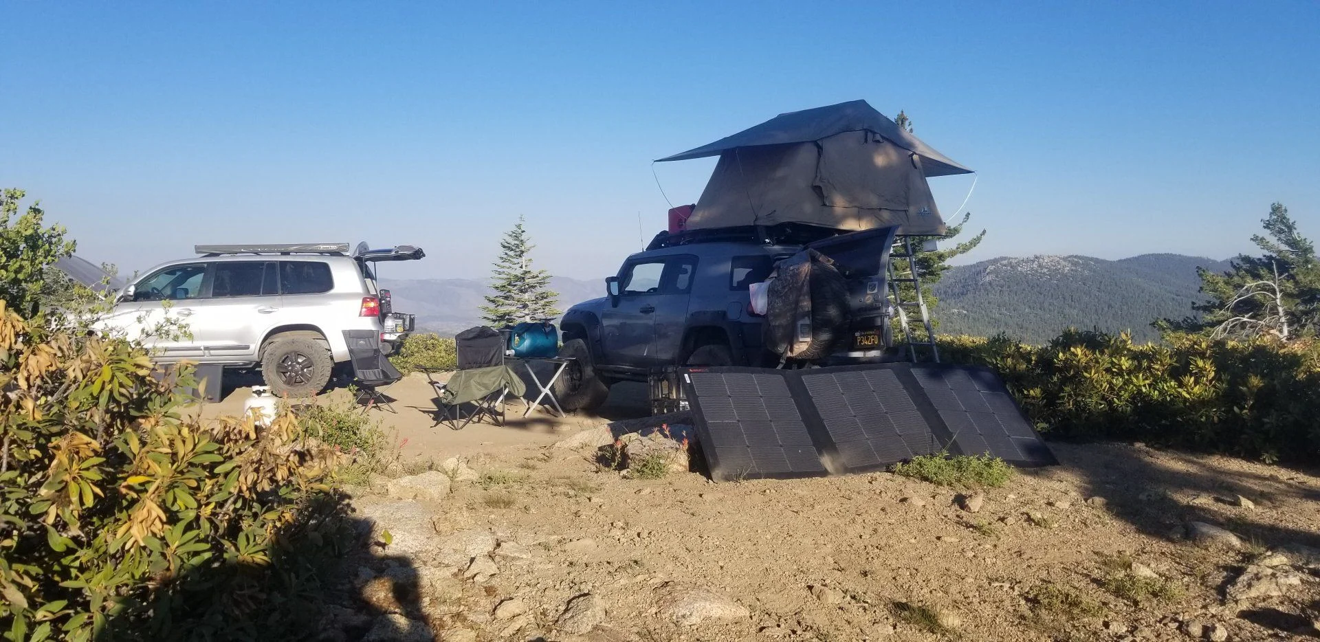

The only problem with a vehicle mounted solar panel, is that you have to park in the sun, which in the desert isn't that big of deal because there isn't any. But when there is shade it sure is nice to use it. @Mogwai got a nice 100W panel from Rockpals and just made a 30ft extention cord and you can chase the sun all day while parked in the nice cool shade.
It's 25' :cool:
Excellent point, well taken! Plus you can tilt and aim the panel(s) for max efficiency!
Yeah I made mine by going to Ralph's and seeing what he had lying around 😝 Anyway, thanks for the cable!!
The only good reason I can see for a hood or hard mounted panel is if you have a parasitic draw and need to keep your truck trickle charging while parked. Otherwise def better to go mobile for many reason, the biggest one J hit on, why park in the sun if you don't have to, and when the sun move you can tilt and move with it (if you even need to).
Justin what about the Merlin? Top notch for sure for those w/ deeper pockets.
I did get a little higher end, higher output panel. The Merlin 170W foldable, it kicks ass, but its on the high side $650. It is built for longer term in and out of rigs with a 5 year warranty and 25,000 folding cycles on the buss's. Its definitely well built.

I run a 100 AH Northstar battery which will give me 12 - 14 hrs of fridge run time before I get down to 12.2V (50%) which is typically overnight on a warm summer night and If I'm staying for the day I definitely need the panel to top off my battery, which by noon (with good sun) I'm fully charged which is when I charge all of my other battery powered devices with the excess power, which keep me fully sustainable (until I run out of beer). But you're right, if you're just overnighting, and wheeling the next day I usually don't bother putting it out.
