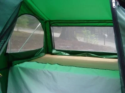

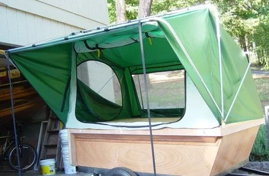

My name is Scott Chaney, I own a company focused on compact, lightweight tent trailer solutions of folks with smaller, fuel efficient vehicles.
I’m in the process of designing a side-fold Trailer Top Tent unit and having it available later this year. Pictured is the changing room version, it will also have a rainfly (not in picture). We are also considering a version without the changing area, similar in size as currently available RTTs. This will be a high quality marine canvas tent.
Does this type of unit look like something folks might be interested?
How tall is the top of your trailer? I’ll need to determine a “normal” height for the changing room floor from the top of the bed.
Would folks be interested in building their own bed platform for the right price differences or prefer to purchase a complete unit ready to bolt-on?
Thanks,
Scott
Thanks,
Scott
www.compactcampingconcepts.com

Based on feedback from a number of sources we're looking at modularizing the tent. Having the trailer top portion and changing room separate units that zip together. Then we can built a bottomless version of the changing room (like a Mombasa's changing room) and height variations aren't a issue. Also a version with a full bottom our on road trailers.
Price is still in flex, $1000 does seem to be the magic number where the potential customer base start to shrink. Shopping the tent for a manufacture has been a very interesting learning experience.

Per feedback we have modularized our tent design. The sleeping and changing area will be separate units. This will make it easy to deal with the various floor heights. You could also get just the sleeping portion.
Right now pricing looks like $700-800 for the sleeping portion in a high quality marine canvas. Expect to have first tents available Feb-Mar '08 timeframe.
What do people think about the sleeping and changing areas being separate units?
Scott
Hi Robert,
The canopy / awning hanging over the side, is part of the tent /sleeping portion. The changing room attaches around the awning, down the diaginals and across the bottom of the tent. We plan on having the changing rooms available with or without floors.
Scott
