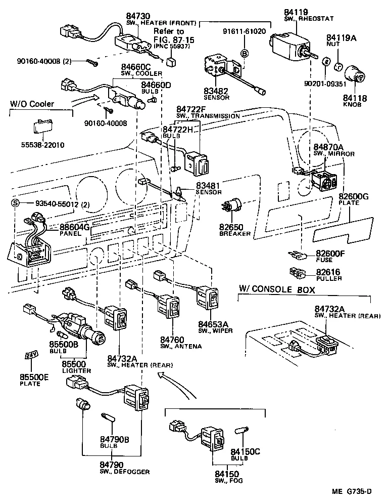

Why not put it in one of the unused positions? Don't they just pop out?
Is there a map showing what all those unused switch positions on the dash were for?
Don't believe there is a map that shows what the unused spots are for..

Different models of the 60 in other countries got different switches, depending on whether it was a diesel or GX model etc. Here's one drawing from the '87 turbo diesel
