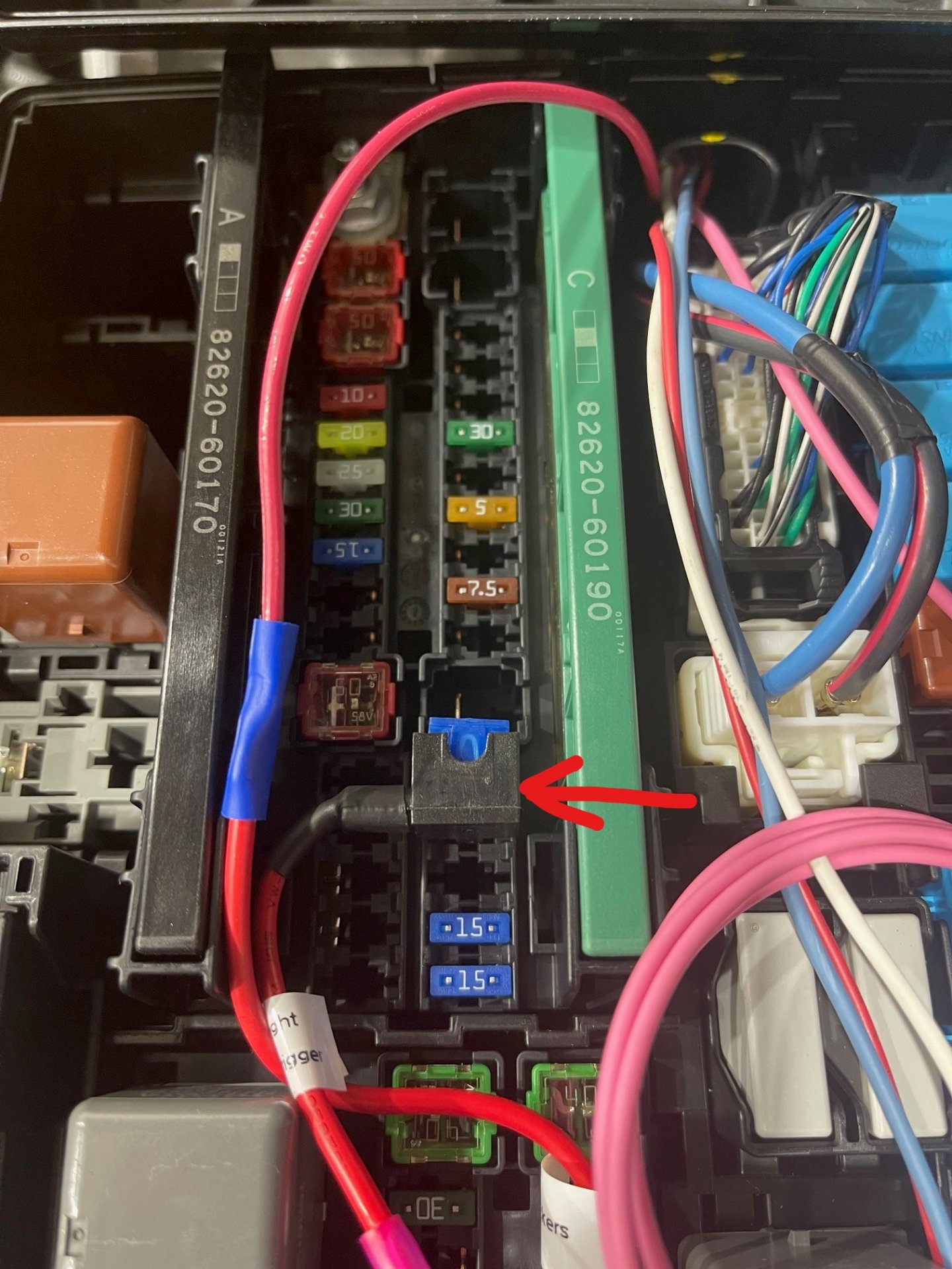

I used a fuse tap.
How did you get that orientation of the Add-a-fuse to work? The positive side of that fuse row is the left hand side, the side of the add-a-fuse opposite lead is the side that need to pick up the positive.
I will have to look again. I believe that section had the lead on the other side. I will look this evening.
