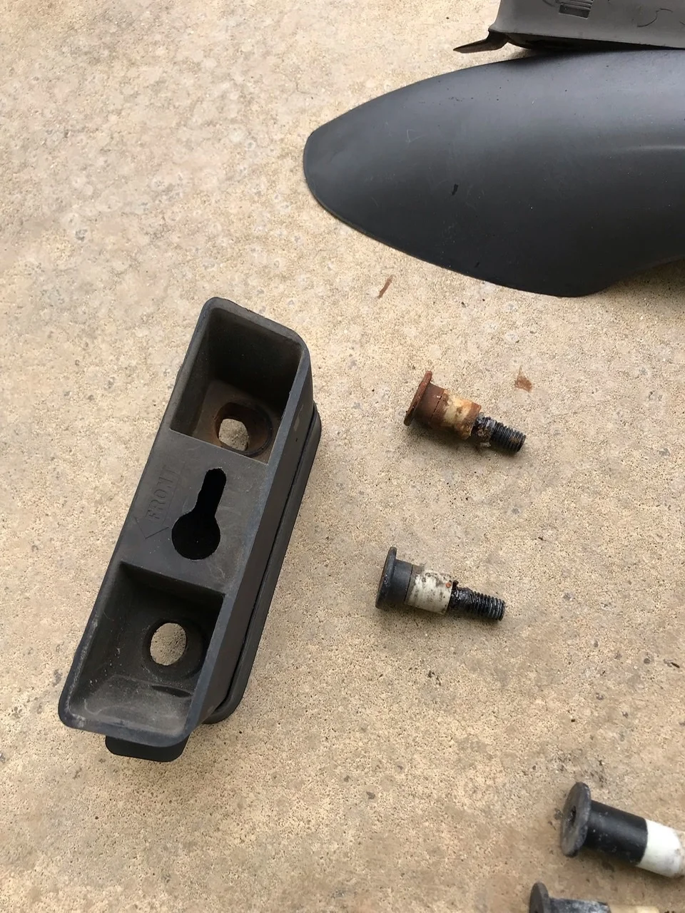

Removed my roof rack yesterday and found this! Turns out quite a few of us in NA find some water sitting on top of the bolt heads inside the center mount.

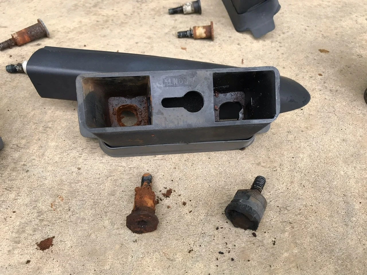

On the right side center mount the front bolt head was COMPLETELY rusted off! I was using a magnetized Wiha handle and bit and all the rusted bits just kept coming out looking like rusted little flower blooms on the end of my T40 bit.

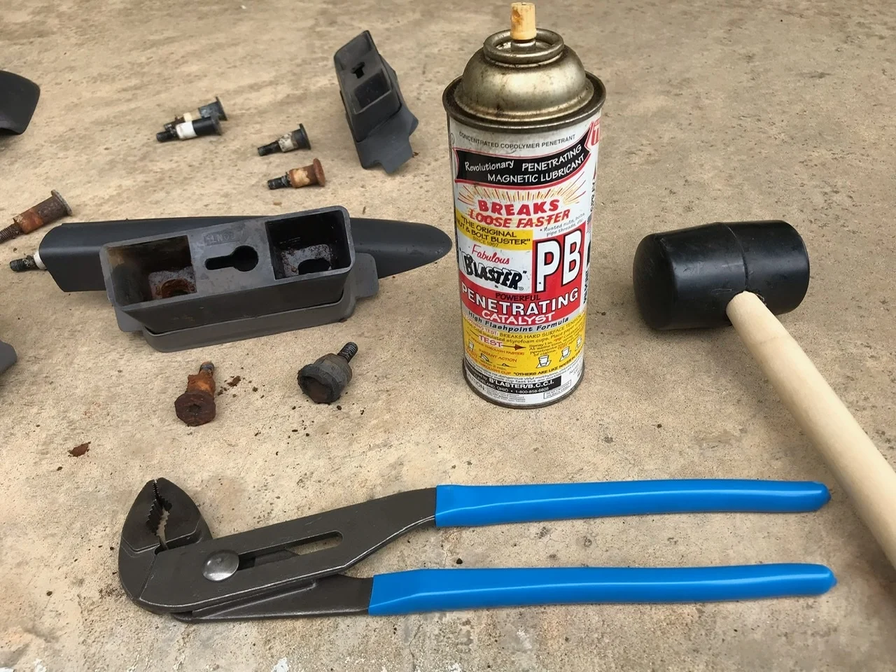

Thankfully after soaking both with PB Blaster (like WD-40) the rear one came out but I ended up needing to use large channel lock pliers and snapping the plastic off the front one and then was able to remove the bolt that way!
Praise the Lord not rust or anything on the threads. So whatever the thread sealant was Toyota used it works perfectly!
At this point I put some M8 screws with washers in the holes but realized I need to remove the black metal original sealing plate pieces and probably look into just getting a full length roof rack and go from there.

Also it seems Toyota uses a black rectangular stick on sealing plate that has a type of butyl sealing stuff on it and I wonder of it has no bolt hole in it and when they push the bolt through it it forces it into the threads as every single thread on all 12 bolts were clean as can be!
