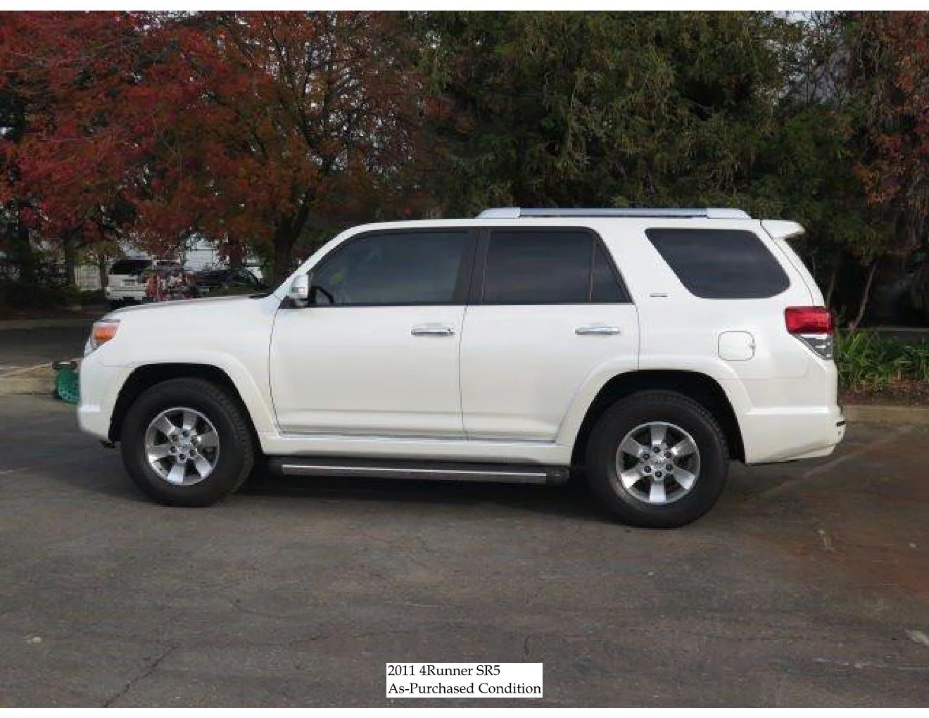

Hey all - I'm normally hanging out with the 80 Series crowd, but this weekend I gave my wife's 4R some love in the form of a lift, so I figure a post here is in order...

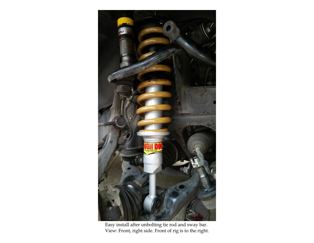

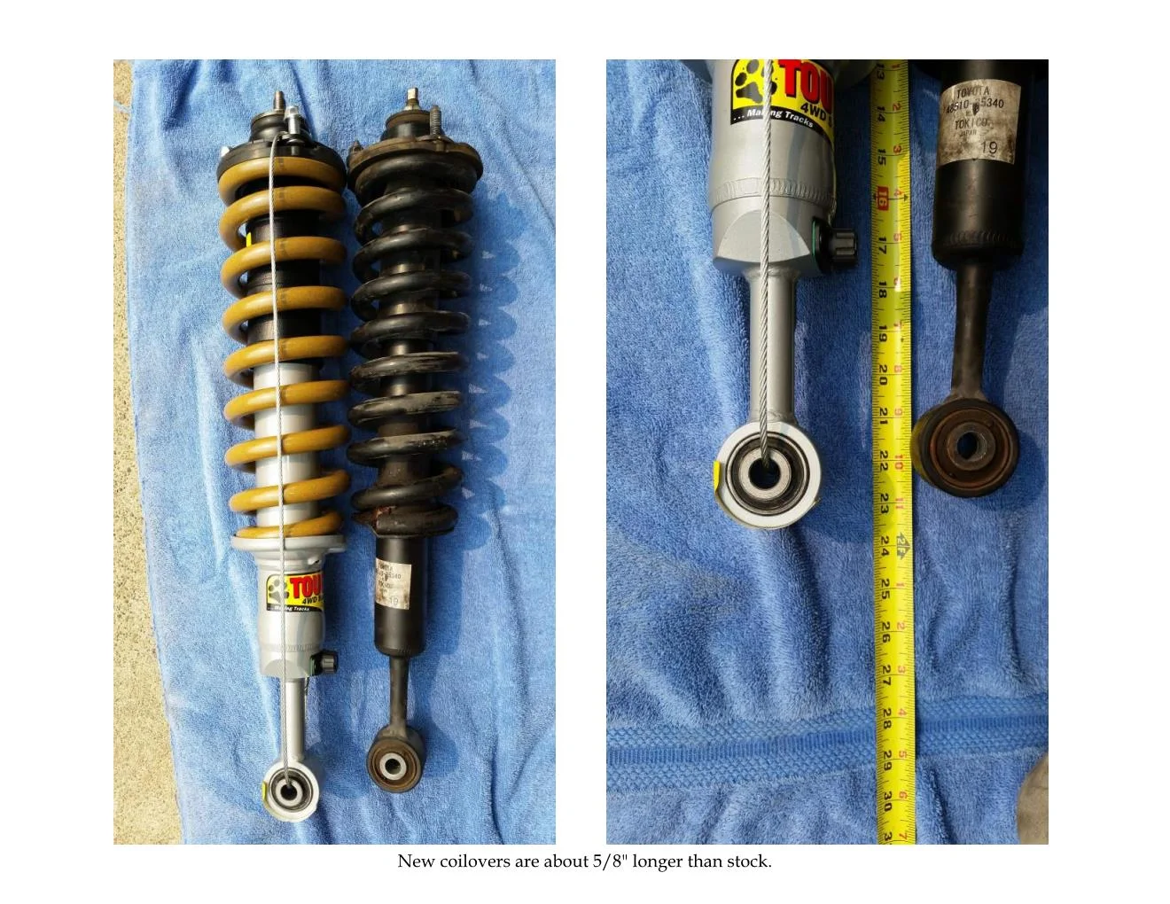

The lift is a Tough Dog kit that Jason @ Trail Tailor (@reevesci) set me up with for my wife’s 2011 SR5 4Runner. The kit consists of front coilovers, rear springs, and rear shocks. I consider the kit unique because all four shocks are adjustable (each has a 9-position dial), and the price is better than reasonable. I’m a big fan of the adjustable shocks after having spent the last 7 months or so thrashing about with adjustables on the rear of my ’97 80 Series (part of a TourFlex 3” kit).
Our 4Runner had about 58k miles on it when we bought it, and it has about 75k now. The stock suspension seemed to be working as good as new, had no perceptible slop anywhere, was a comfortable ride, and I have absolutely hated the way it handles from day one. IMHO, “wallow and dive” best describes the factory ride.

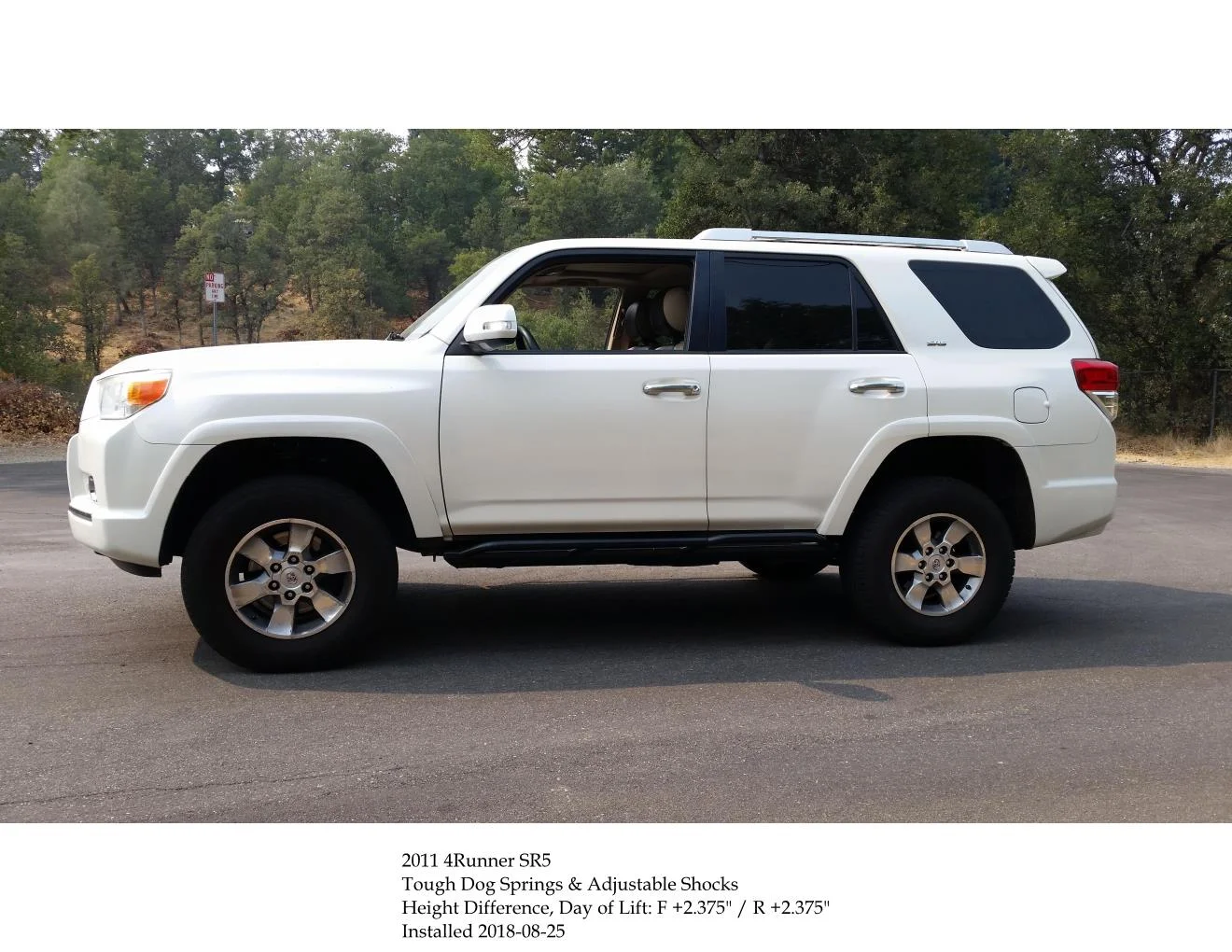

I installed the lift in my driveway by myself, starting on Friday night after work, and finished on Saturday around noon. Everything went well…no surprises, very straight-forward.
Observations after a mild test flogging:
  • Pre-break-in height difference is about +2 3/8” at each corner.
  • Test drive was super smooth. No squeaks, creaks, clattering…nada.
  • At the #1 shock setting, the ride felt only slightly less plush than the stock suspension, yet handling was much more controlled. Wasn’t diving into the bump stops at every brake check. A bit soft for town driving but would be great for the trail.
  • At #5 & 6, the ride was perfect for DD use around town. A firm yet compliant ride, what it should have felt like from the factory.
  • The #9 setting was dramatically different. Absolutely flat cornering, and so stiff it practically felt like it was riding on the bump stops. Very impressive that these shocks can change the ride so dramatically with an easy dial twist.

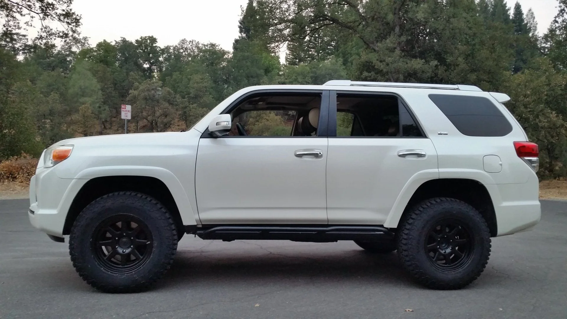

Anyhow, we are quite pleased. Incredible bang for the buck, and I’m happy to have found a way to support MUD vendor Trail Tailor using 4Runner funds.
Now we just have to get some real tires on the rig...
