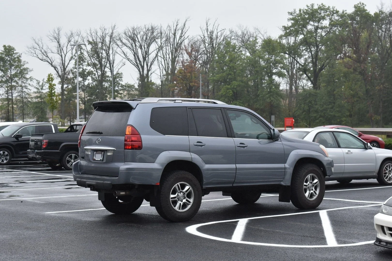

Vehicle setup:
  • 2005 GX470 with KDSS
  • 255/80R17 Load Range E Toyo Open County II
  • DIY hidden winch mount with Smittybilt H20 10K with synthetic lines. Weight is 78 lbs in the spec. Total weight should be less than 150 lbs
  • 1.5" front lift spacer
  • Wheelers super bump front and rear
  • PO converted the airbag to coil using Strutmaster kit.
    • I need a coil conversion kit since strut master use their own proprietary lower spring plate mount. I bought metaltech kit.
    • Also bought 4th gen 4runner upper spring isolator
Per the guide at their website I order the kit for steel bullbar and light rear.
This kit comes complete with
  • Fully assembled front Strut, marked LH & RH.
  • Rrear shock
  • Rear spring.
Install was pretty straightforward. I did rotate the passenger side front Strut to make the adjuster to face toward the wheel. Not sure which one is correct. I like mine to face the same so I did a no spring compressor spring removal and got everything back in 15 min.
Height comparison from wheel center to bottom of fender opening.
Stock 1.5" spacer Tough Dog
FL 19, 21.5, 21
FR 20 1/8, 21.5, 21
RL 21 1/4, 21 5/8, 23
RR 22 1/8, 21 7/8, 23
The initial front lift disappointed me a bit. So I order a 1/2" UHMW spacer to go in between the rubber spring isolator and the top plate, plus another 1/2" steel spacer to go on top. The front sits at 22" right where I want it now.
