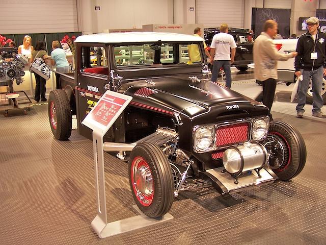

like this
ya can you do power door lock on an early stile 40? LOL:D
Yes you can. Possibly 150 with alarm from KMS. Very easy for you to install. And a lot fun to have. Worth every penny. You would want a CA2000
