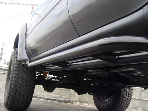

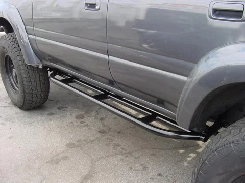

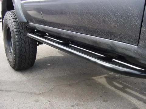

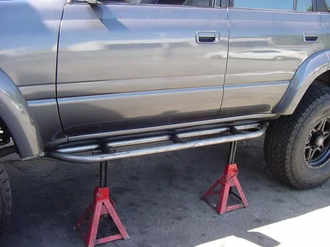

Could not bring myself to spending $800+ on a set. So here is what I found.

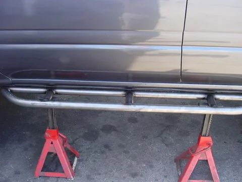

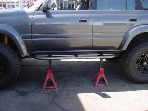

Bought a 67" universal set of sliders. Very well built, 1 3/4" OD x .120 wall 1035 DOM. Then purchased a bolt on mounting kit from 4x4 innovations and just welded the runners up. Since I have replaced the cats with a small high flow Random Technology unit, I purchased the bracket kit without the cat protection since I did not need it. Saved another $50 there. Here are a few places you can get them.
http://www.addictedoffroad.com/index.php?main_page=product_info&cPath=84&products_id=515
http://www.bcfab.com/Rock-Slider-Kit--67_p_384.html
http://4xinnovations.com/p-1829.html

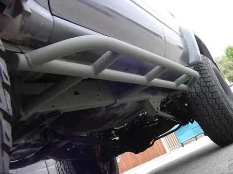

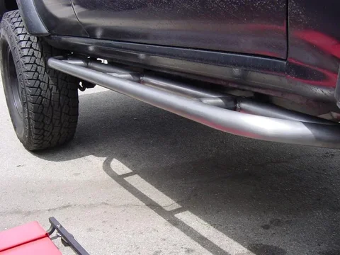

After welding them in, just did a light sand to get some surface rust and oil residue off and just cleaned them up.
Then just threw on a coat of primer.
Last is a few coats of the Semi-Gloss Black.
Planning on finding some front mud flaps now. Hopefully someone can point me out in the right direction.
looks damn goood! how hard was it to mod the legs to fit the tapered frame?
Legs come cut already formed to both the slider and frame side. I did however cut some legs to get it to sit the way I wanted them. All you need is a cut off wheel or drop saw, welder and grinder.
Best part is that you can just unbolt it and remove it completely if need be.

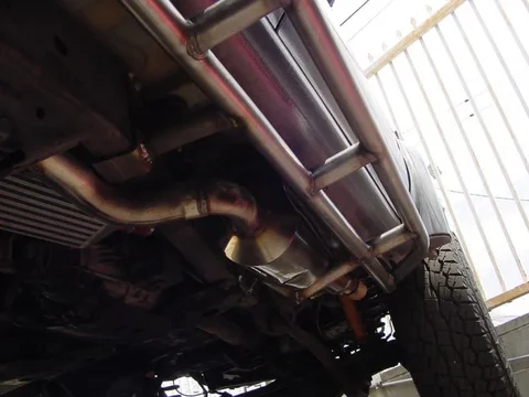

^^It likely is his intercooler you are seeing. Look for his turbo thread...
CDan or Sam Stewart should have some F mudflaps.
Turbo thread in my sig line.
