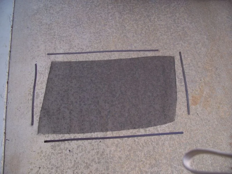

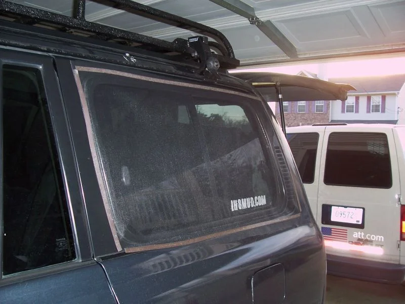

I do a backwoods version.
Just get some bulk nylon screen , cut to size get a bunch of small but powerfull magnets and there you go, stick it on any window and some doors
Thats my okie version.

I also did it with window screening, next time i would use no-seeum netting. And use magnetic tape to hold inplace all the way around. I had them cut for both the rear door windows, and rear sliders. And to store the magnetic strip i would use the inside of the rear hatch by the window. You would never know they are there. Less then $25 and you are good to go. You might want to get a small fan for the nights when the air isnt moving.
