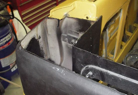

I had huge rust issues on my roof (and doors, and fenders, and rockers, and....). Big rust holes in the roof. I think the PO let the pig go out with the tide, considering how much sand was in the headliner... So, here is what it looks like topless (in Caterpillar colors). Fortunately, the frame is solid. I have a long way to go to get it on the road, but I have done a good amount so far, also. If you're interested, I can post pics of how I am covering the cut metal at the "bed rails" of the truck. Not pretty, but neither is the rest of the rig.

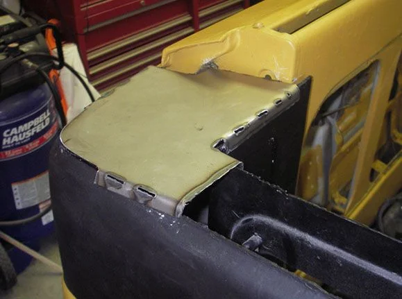

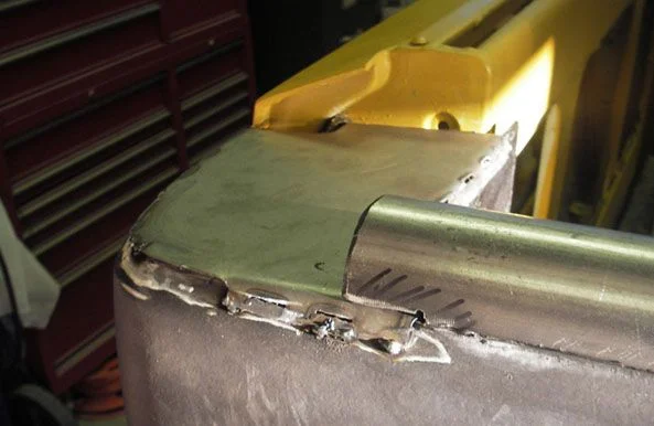

Here is what I have so far on the bed rails of the truck. I started out with a 16 gage plate cut to the shape near the tailgate and one close to the back seat. I welded those to the body. Then I notched a 2.5 inch exhaust pipe on each end to overlap the plates a about 2 inches at each end and welded that to the plates and the body. I kept the top of the pipe in line with where I cut the doors. I primed and painted the inside of the pipe before welding to keep the rust from forming. I will fair the ends to the body later.
I will be using this rig as a pickup truck for work (someday…). Those rails are very strong and will be able to handle a lot of abuse. That stiffened up the whole body a good amount, too. I still will be fabbing a roll bar and might try to use a bikini top from a Scout or Bronco.
