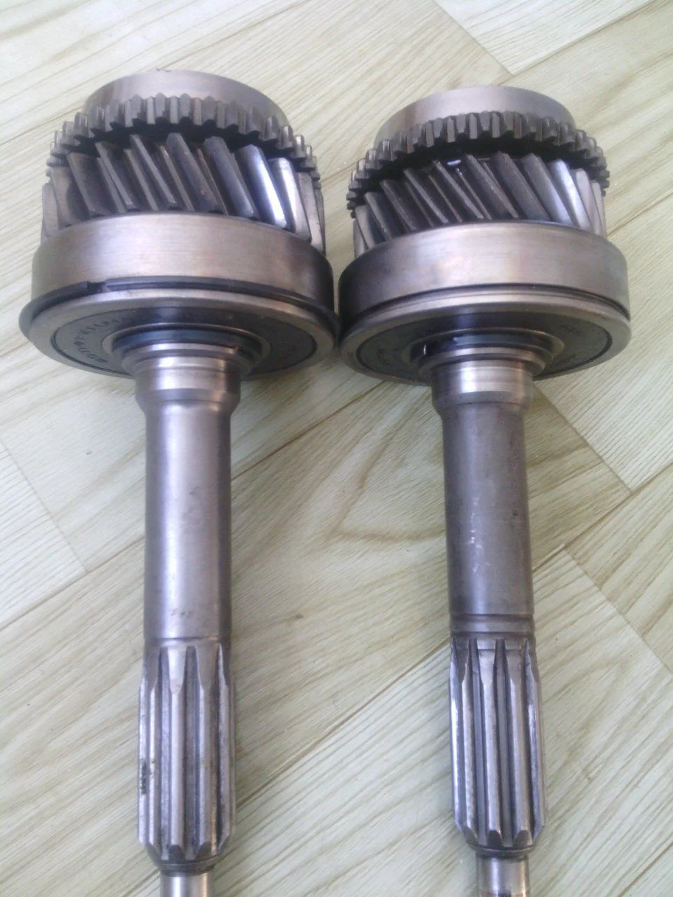

2f and 2h input shafts were different in my case. The one on the left is from h55 from 2h, on the right is from h42 behind 2f engine. Everything same except gears. Take a closer look.

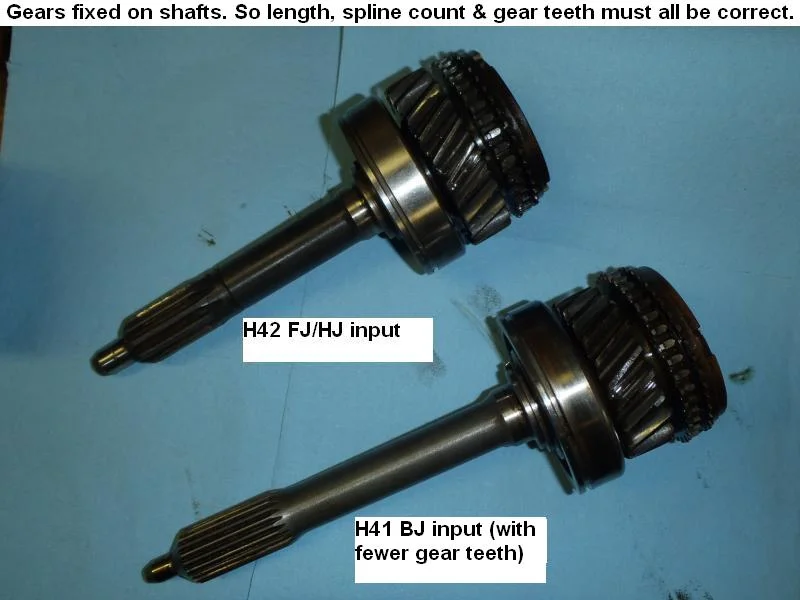

H41 and H42 4-speed input shafts differ with that cog-size too:
