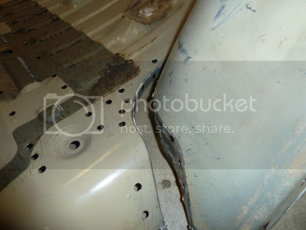

The floor bends 90 degrees downward and is spot welded about half an inch below the floor line to the inner wheel well. Easy to deal with if you are cutting the floor out as you only have to drill out the spot welds holding it on the inner quarter. If you have good floors and want to keep it that way it won't be an easy job.

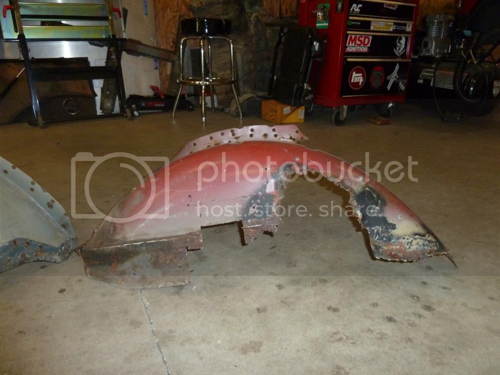

I know this conversation has been moving through other forums and threads but I promised pictures, so here they are.

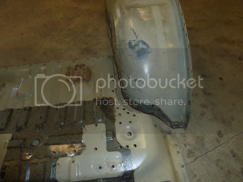

Here is a good wheel well that I removed from a floor that was cut in half, and what was left of the quarter panel it was attached to.
This is the reason why I went through all of that:
Here's how the floor and wheel well attach:

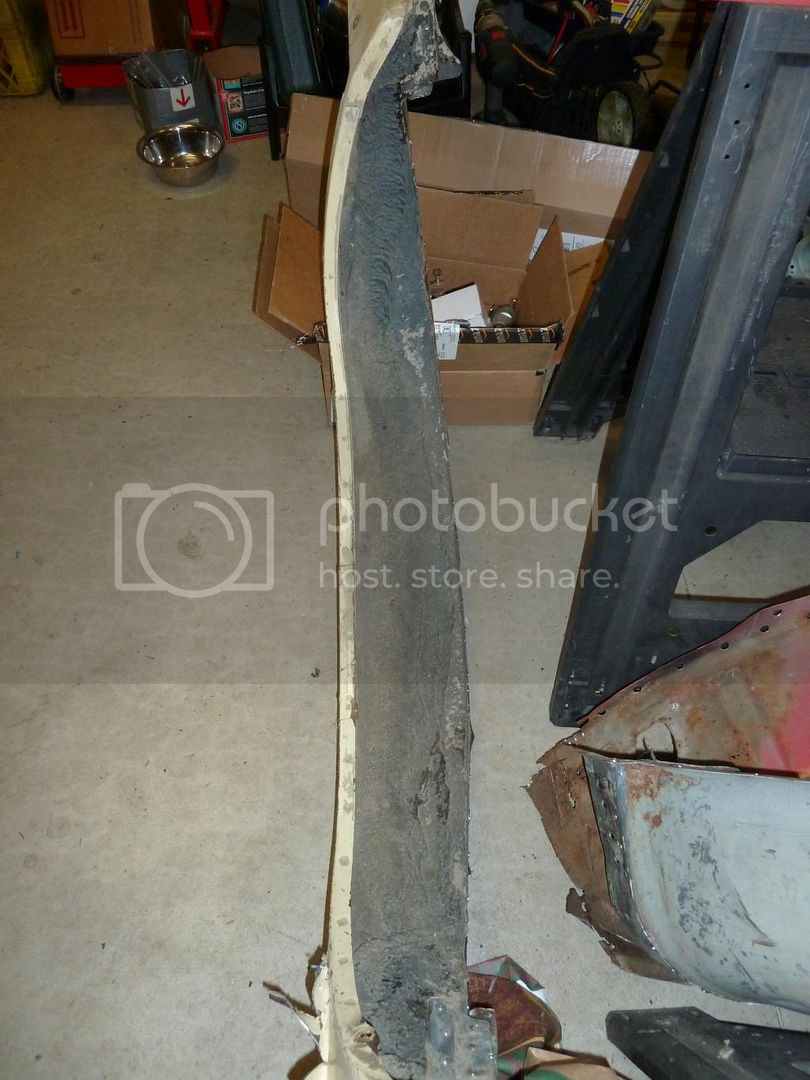

And lastly here is the magical "outer wheel well". I'm just going to cut out what I need from here, these spot welds do not look like so much fun to try and drill out.
